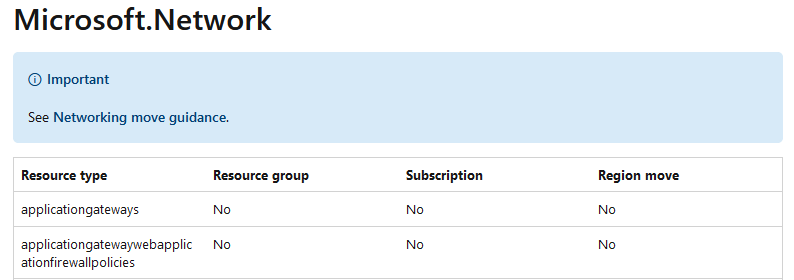

    As mentioned by @Tushar Kumar above, Application gateways and WAF policies are not supported for move across resource groups/subscriptions/regions.
    Refer: https://learn.microsoft.com/en-us/azure/azure-resource-manager/management/move-support-resources#microsoftnetwork
    So, the only option is to recreate the Application gateway in the new subscription.

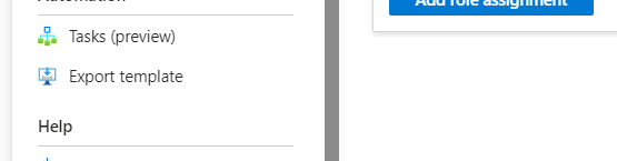

    • You can export your existing App gateway configuration via ARM template, Bicep, PowerShell, CLI, etc.
    • You can either export template from your existing resource group or the Application gateway.

    In an ideal world, you'd have used Infrastructure as code to deploy the Application Gateway and to manage the configuration. In this way, you'd run the deployment again to reproduce the same configuration. If you didn't follow this approach, you can capture the current configuration using the Export Template option in the Portal which provides a great starting place for you to polish and refine the template in order to deploy again.
