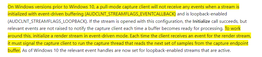

Though all the API's used are supported by Windows VISTA and above devices as per the documentations, not able to figure out why event is not triggered in Windows VISTA to Windows Server 2016 devices. Also I have done error handling properly and not able to catch any errors.
On debugging, I'm able to find that _AudioSamplesReadyEvent event is not getting triggered. Where I have a WaitForMultipleObjects which waits for the event to process audio buffer further. Since the event is not triggered, I can not capture the audio.
