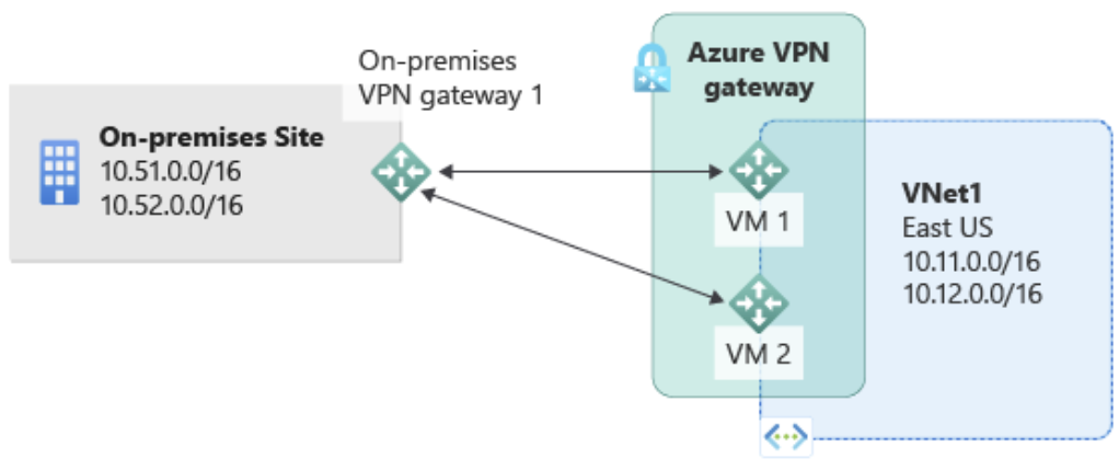

Active/Active Azure VPN gateway with BGP peering over S2S vpn with single on premise device.
Both vpn tunnels are up, IKE and IPSEC SA established. However, only 1 bgp peering is established, while the second one keeps being on Connecting status in the Bpg Peers section. Same status ofc on the on prem device. The configurations are basically the same, could you please advice? The on premise device is Palo Alto.

    I understand that you are trying to configure a Active-Active VPN Gateway with one OnPrem device.
    I believe your scenario is : https://learn.microsoft.com/en-us/azure/vpn-gateway/vpn-gateway-highlyavailable#active-active-vpn-gateways
    You confirmed that you were using 2 LNGs and this was causing the issue.
    Following the above documentation, you were successfully able to resolve the issue.
