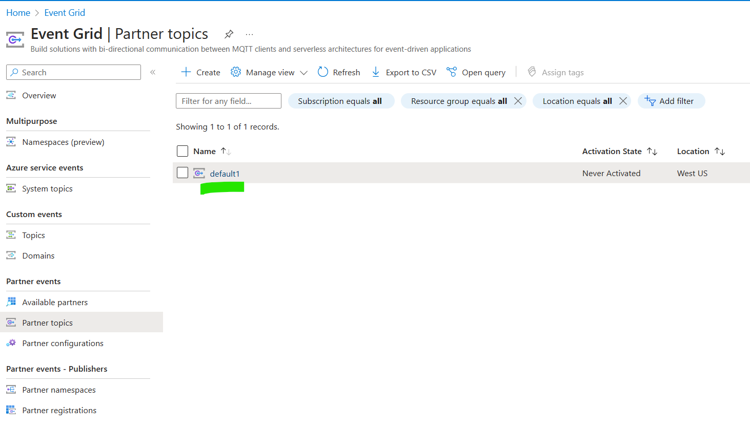

    You can do so under https://portal.azure.com/#view/Microsoft_Azure_EventGrid/EventGridCentralMenuBlade/~/partner_topics
    See screenshot below.
    As an alternative you can use a different partner topic from in each region. Like topic-name-region but I don't know how this will work in your scenario.
    I believe you can delete that resource using AZ PowerShell module in you script for automation.
