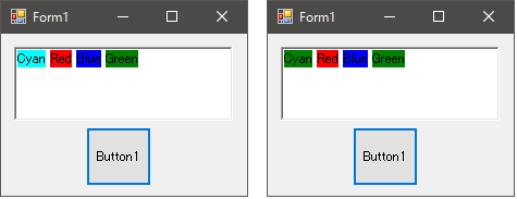

    After my tests, Color.Aqua and Color.Cyan are both the same color #FF00FFFF, and use txt_note.SelectionBackColor always gets Color.Aqua when getting the background color, so you should use the following code to determine the background color.
                If txt_note.SelectionBackColor = Color.Aqua Then
                    txt_note.Select(i + 1, 1)
                    txt_note.SelectionBackColor = Color.Green
                End If

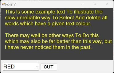

    2023-09-19T20:01:28.7133333+00:00
    Hi
    Here is some code that may be helpful. This is a stand alone example and you need to try it before using it. To try it, start a new test Project, on Form1 put a RichTextBox named RTB, a default ComboBox1, Button1 and a ContextMenuStrip with "RED, LIGHT BLUE, GREEN and WHITE" items on it.
    The idea here is: user selects a word and a colour from the ComboBox then clicks the 'CUT" button. With luck, all words matching selected word and matching selected colour will disappear.
    There are lots of variations possible, this being one of them.
    There is also a ContextMenu to enable a colour selection (just a simple choice) for testing purposes. Just select a word or some text and then right click for the colour choices. (colour options would normally be much more comprehensive in a real world application)

    End Class
