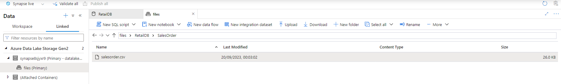

I have downloaded the CSV and uploaded as instructed. All the other tables before this one (the custom table and the one from the template) were created successfully.

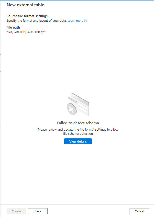

When I try to create the external table from the datalake, after I set the table name, the linked service and the input file of folder I have to click the continue button but there isn't a next page for me to select a file type.
A window with the "Failed to detect schema" appears and there is the following detail:
"Error details
New external table
Failed to execute query. Error: Error encountered while parsing data: 'Invalid: Parquet magic bytes not found in footer. Either the file is corrupted or this is not a parquet file.'. Underlying data description: file 'https://datalake8sjyxr9.dfs.core.windows.net/files/RetailDB/SalesOrder/salesorder.csv'. The batch could not be analyzed because of compile errors."

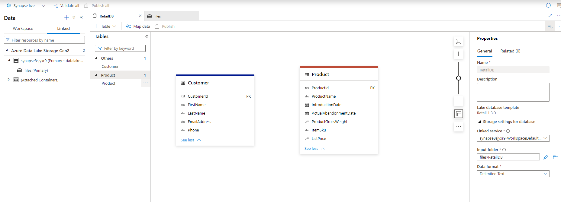

I checked and the RetailDB Data format is "Delimited Text" and it's working because the other two CSV I uploaded for the custom table and the one from the template are working fine.
