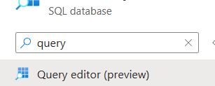

Mahesh Kumar Babu Kummara 50 Reputation points
2023-09-23T17:03:41.31+00:00
My client was unable to connect to Azure SQL Database, attaching an error screenshot. User's image
