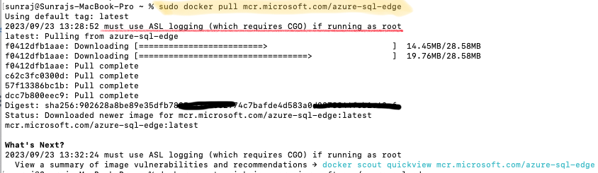

Commands I ran to install the image
sudo docker pull mcr.microsoft.com/azure-sql-edge

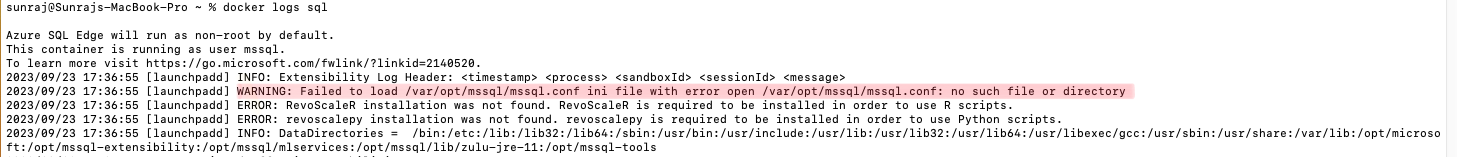

  2. Complete log is pasted below, but i am guessing this might be a reason for the error? enter image description here
Logs
sunraj@Sunrajs-MacBook-Pro ~ % docker logs sql
Azure SQL Edge will run as non-root by default.
This container is running as user mssql.
To learn more visit https://go.microsoft.com/fwlink/?linkid=2140520.
2023/09/23 17:36:55 [launchpadd] INFO: Extensibility Log Header: <timestamp> <process> <sandboxId> <sessionId> <message>
2023/09/23 17:36:55 [launchpadd] WARNING: Failed to load /var/opt/mssql/mssql.conf ini file with error open /var/opt/mssql/mssql.conf: no such file or directory
2023/09/23 17:36:55 [launchpadd] ERROR: RevoScaleR installation was not found. RevoScaleR is required to be installed in order to use R scripts.
2023/09/23 17:36:55 [launchpadd] ERROR: revoscalepy installation was not found. revoscalepy is required to be installed in order to use Python scripts.
2023/09/23 17:36:55 [launchpadd] INFO: DataDirectories =  /bin:/etc:/lib:/lib32:/lib64:/sbin:/usr/bin:/usr/include:/usr/lib:/usr/lib32:/usr/lib64:/usr/libexec/gcc:/usr/sbin:/usr/share:/var/lib:/opt/microsoft:/opt/mssql-extensibility:/opt/mssql/mlservices:/opt/mssql/lib/zulu-jre-11:/opt/mssql-tools
2023/09/23 17:36:55 Drop permitted effective capabilities.
2023/09/23 17:36:55 [launchpadd] INFO: Polybase remote hadoop bridge disabled
2023/09/23 17:36:55 [launchpadd] INFO: Launchpadd is connecting to mssql on localhost:1431
2023/09/23 17:36:55 [launchpadd] WARNING: Failed to connect to SQL because: dial tcp 127.0.0.1:1431: getsockopt: connection refused, will reattempt connection.
2023/09/23 17:36:56 [launchpadd] WARNING: Failed to connect to SQL because: dial tcp 127.0.0.1:1431: getsockopt: connection refused, will reattempt connection.
2023/09/23 17:36:57 [launchpadd] WARNING: Failed to connect to SQL because: dial tcp 127.0.0.1:1431: getsockopt: connection refused, will reattempt connection.
2023/09/23 17:36:58 [launchpadd] WARNING: Failed to connect to SQL because: dial tcp 127.0.0.1:1431: getsockopt: connection refused, will reattempt connection.
2023-09-23 17:36:59.79 Server      The licensing PID was successfully processed. The new edition is [Azure SQL Edge Developer].

    Thanks for sharing detailed logs.
    As per the error present in logs:
    ERROR: Unable to set system administrator password: Password validation failed. The password does not meet SQL Server password policy requirements because it is not complex enough. The password must be at least 8 characters long and contain characters from three of the following four sets: Uppercase letters, Lowercase letters, Base 10 digits, and Symbols..
    It seems that the password created for Server does not comply to the password policy stated above.
    Please retry using password combination which makes it complex enough with at least 8 characters along with other details.
    Do let us know if you still face issue after making complex password changes. Thanks
