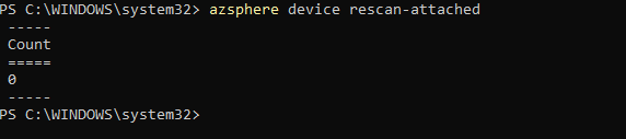

Please see the output when we run the command "azsphere device show-attached"User's image
Response while performing rescan-attached:

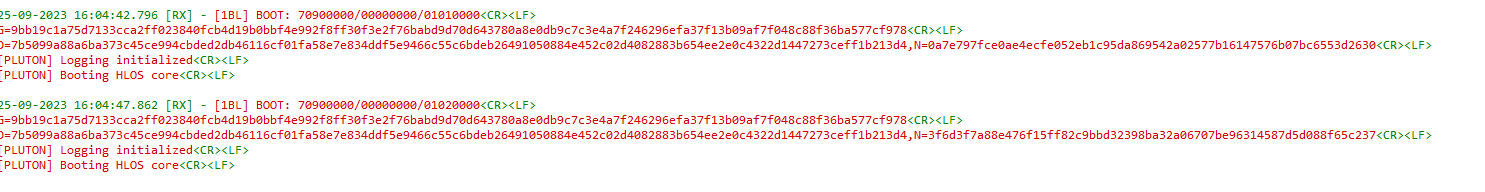

When connected the Debug port of the device, these logs were obtained when reset button was pressed.

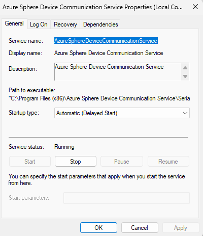

Azure Sphere Device communication service is running.

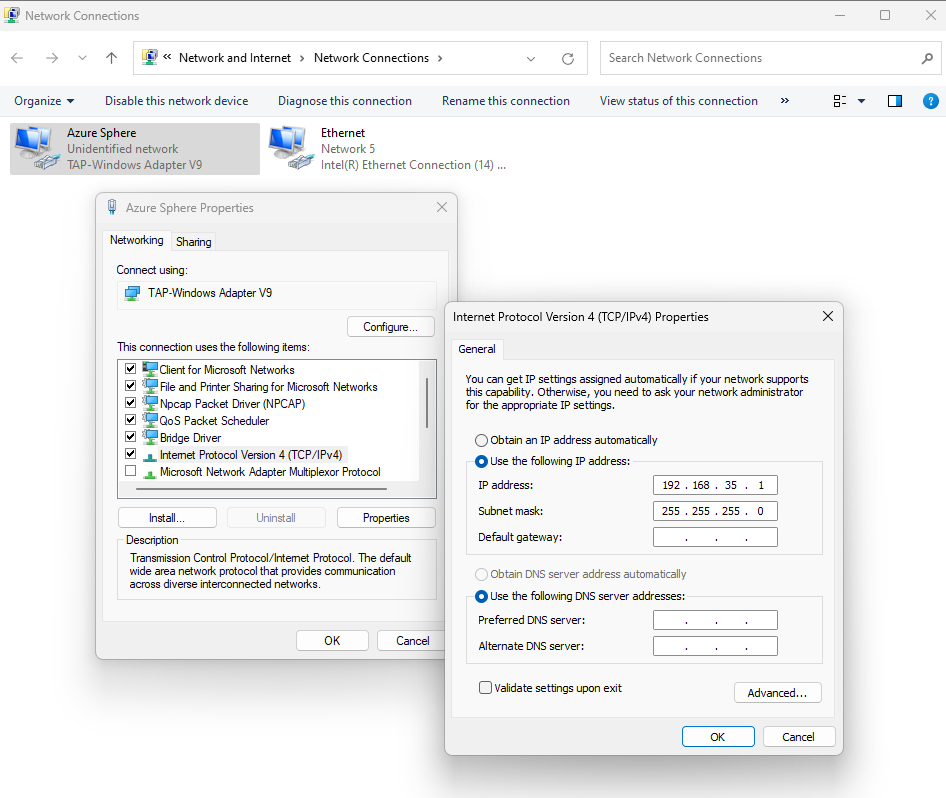

Windows TAP-adapter is configured properly.
