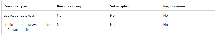

    I understand that you would like to know if it is possible to move an Application Gateway between two subscriptions.
    Application gateways and WAF policies are not supported for move across resource groups/subscriptions/regions.
    Refer: https://learn.microsoft.com/en-us/azure/azure-resource-manager/management/move-support-resources#microsoftnetwork
    So, the only option is to recreate the Application gateway in the new subscription.
