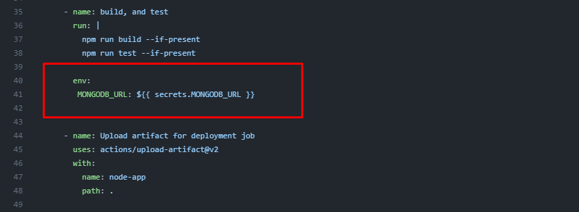

  2. Biz Admin 51 Reputation points
    2023-09-29T03:26:17.48+00:00
    Issue solved -
    issue solved by adding this env variable with build run, also don't forget to add this environment variables on GitHub secrets.
    issue_solve-44566
