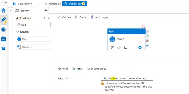

I'm working on ADF Web activity URL update as per env's from CICD Pipeline, can any one please help me out.

    If your requirement is to replace the dev URL with PROD on the release pipeline, you can simply use the override template parameters to replace the URL.
    To parameterize the URL, Use the below block of code in the custom template-parameters-definition.json
    "Microsoft.DataFactory/factories/pipelines": {
    "properties": {
    "activities": [{
    "typeProperties": {
    "url": "-"
    https://bhargavablog.com/2022/09/07/synapse-parametrize-url-at-activity-level/
    How to use custom parameters:
    https://learn.microsoft.com/en-us/azure/data-factory/continuous-integration-delivery-resource-manager-custom-parameters

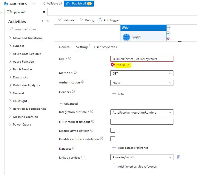

    Go to the Linked Service connected with your Web Activity in your ADF instance.
    Try to make the URL a parameter like @linkedService().url.
    Then, export the ARM template of your ADF. Just try to add an entry for the URL parameter in the ARM template parameters file (arm_template_parameters.json). You'll have different values for each environment.
    If you are using Azure DevOps, You can set up up a pipeline variable for each environment like WebActivityURL_Dev, WebActivityURL_Staging, and WebActivityURL_Production.
    In the pipeline task that deploys the ADF ARM template, pass the relevant variable to the ARM template parameters where you can use conditions or stages in the pipeline to detect which environment you're deploying to and pass the correct URL.
