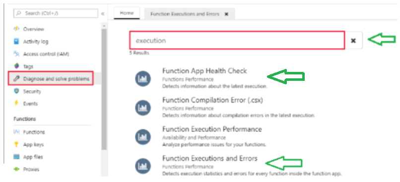

    1. Please check Functions metrics for the HTTP Server Errors at the time of the issue.
    1. Please check the Function App detectors by navigating to the Diagnose and Solve Problems section in the Azure Portal for the Functions as shown below: You can rely on the Function App Down or Reporting Errors option and the Function App Health Check option as shown below:
    More Info here.
    1. You can also query the FunctionLogs as shown below:
    More Info here.
