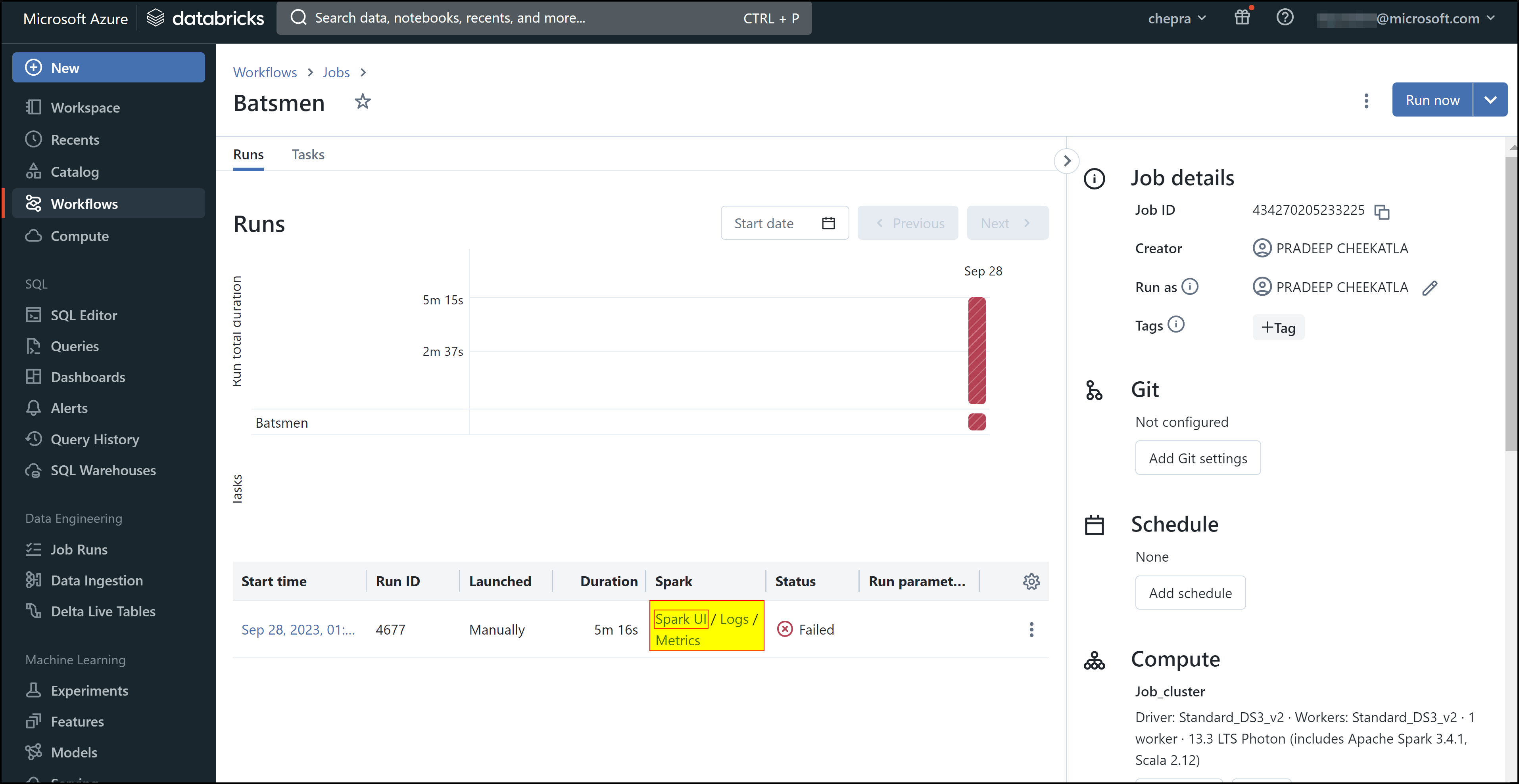

How can understand how much allocated compute power is consuming each jobs of assigned job clusters.
How can determine how much compute power each job consuming of allocated job cluster when in running? I need to know the resource usage of each job to optimize the cluster's performance.

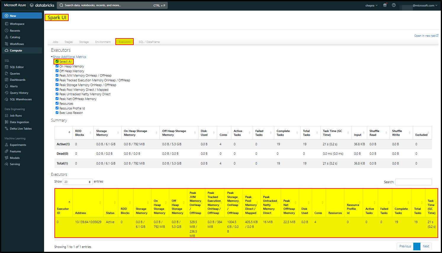

To determine how much compute power each job is consuming of allocated job cluster when it is running, you can use the Spark Application UI.
In the UI, Executors displays Summary and Detail views of the configuration and consumed resources. You can determine whether to change executors values for the entire cluster or a particular set of job executions based on the information provided in the UI.
This guide walks you through the different debugging options available to peek at the internals of your Apache Spark application: Debugging with the Apache Spark UI
