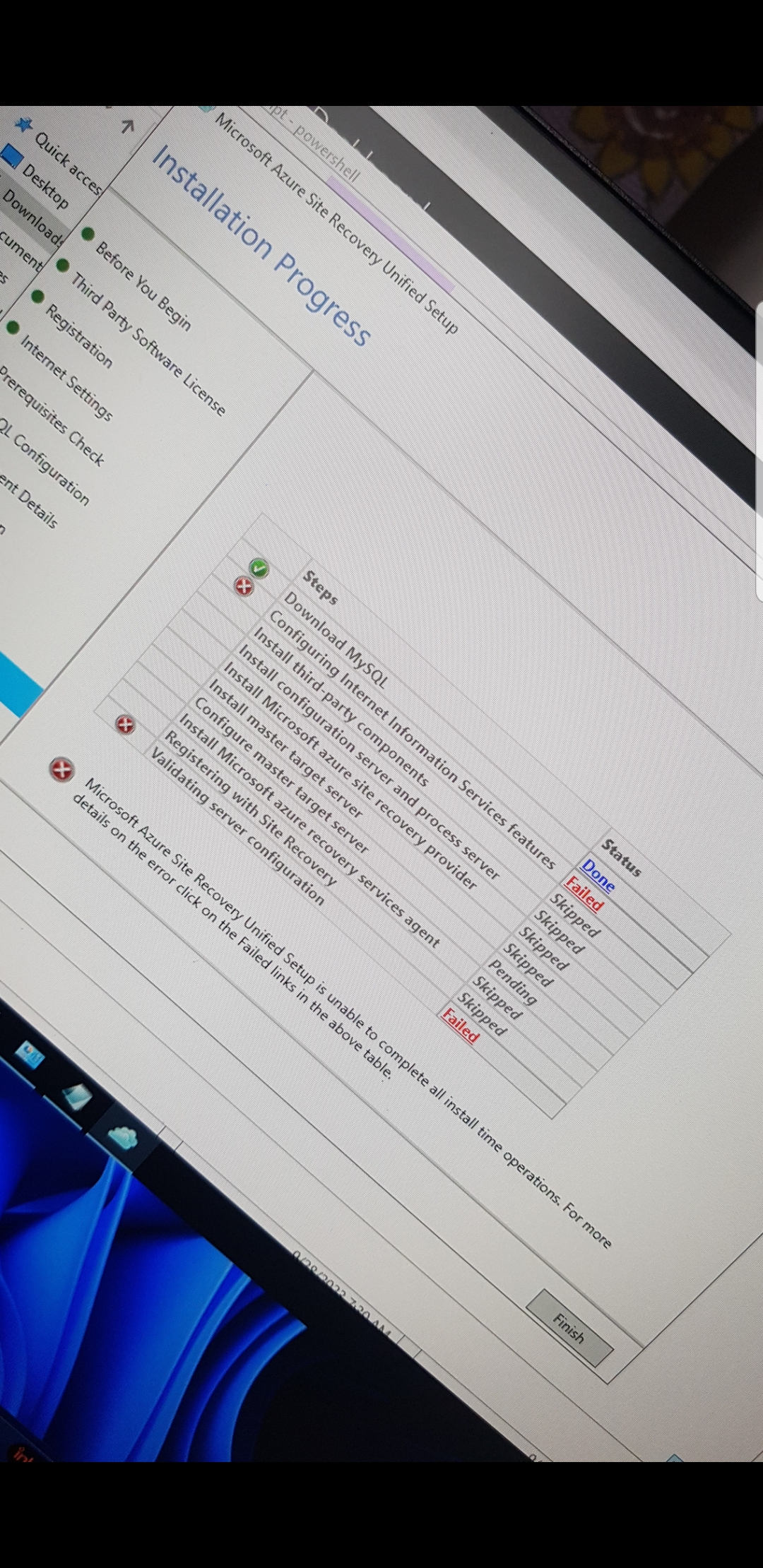

Sorry for the late response and thank you guys your recommendations I have fixed this issue as of I had try with 2022 server this is the issue recovery unified setup not support for this version after I've tried with 2019 server its works without issue also I have migrated 33 servers to azure from onprem Thanks you guy's...
microsoft azure site recovery unified setup is unable to proceed keep fail iis
Can anyone help me this while I install microsoft azure site recovery unified setup is unable to proceed keep fail iis eventhough I have installed iis properly this is not only one server I tried more then 3 servers facing the same issue

2023-09-28T11:19:45.3666667+00:00 Can you click on failed and post the error message here please .
N. Nifan • 55 Reputation points
2023-09-28T11:52:34.4533333+00:00 2023-09-28T01:50:11.9269311+00:00 Always: Trace Session Started 01:50:11: 01:50:11:Application Started 01:50:11:.NET Framework Version 4.8.04161 installed 01:50:11:.NET Framework Version 4.6.2 or later is detected. 01:50:18:MySQL is not installed on the server. 01:50:18:currentBuildVersion - 9.55.6765.1 01:50:18:Microsoft Azure Site Recovery Configuration/Process Server Dependencies is not installed on the server. 01:50:18:Microsoft Azure Site Recovery Configuration/Process Server is not installed on the server. 01:50:18:Fresh installation scenario. 01:50:18:Found machine identifier as acd2e059-14b0-450a-9173-3788b0f006db. 01:50:18:tls check value : False 01:50:19:MySQL is not installed on the server. 01:50:19:Culture installed with Operating System: en-US 01:50:19:UI Culture : en-US 01:50:19:Current Culture : en-US 01:50:19:English operating system. 01:50:19:Current culture and current UI culture are English. 01:50:19:Microsoft Azure Site Recovery Configuration/Process Server Dependencies is not installed on the server. 01:50:19:Microsoft Azure Site Recovery Configuration/Process Server is not installed on the server. 01:50:19:CXTP/CS/PS is not installed. 01:50:19:Microsoft Azure Site Recovery Mobility Service/Master Target Server is not installed on the server. 01:50:19:The junction directory (C:\ProgramData\ASR\) doesn't exists. 01:50:19:Adding Page LaunchPage 01:50:19:Skipping stage addition. Stage Null 01:50:19:Enter UnifiedSetup.LaunchPage 01:50:19:Active navigation for 01:50:19:Adding Page InstallationChoice 01:50:19:Adding before_you_begin key to dictionary 01:50:19:Adding Page ThirdpartySoftwareLicensePage 01:50:19:Adding third_party_software_license key to dictionary 01:50:19:Adding Page ASRRegistrationPage 01:50:19:Adding azure_site_recovery_registration key to dictionary 01:50:19:Adding Page ReplicationApplianceDetailsPage 01:50:19:Adding configuration_server_details key to dictionary 01:50:19:Adding Page ProxyConfigurationPage 01:50:19:Adding internet_settings key to dictionary 01:50:19:Adding Page PrerequisitesPage 01:50:19:Adding prerequisite_check key to dictionary 01:50:19:Adding Page MySQLPage 01:50:19:Adding mysql_configuration key to dictionary 01:50:19:Adding Page EnvironmentDetailsPage 01:50:19:Adding environment_details key to dictionary 01:50:19:Adding Page InstallLocationPage 01:50:19:Adding install_location key to dictionary 01:50:19:Adding Page NetworkSelectionPage 01:50:19:Adding network_selection key to dictionary 01:50:19:Adding Page Summary 01:50:19:Adding summary key to dictionary 01:50:19:Adding Page InstallationProgress 01:50:19:Adding installation_progress key to dictionary 01:50:19:Exit UnifiedSetup.LaunchPage 01:50:19:Enabling clickable navigation for 01:50:19:Inactive navigation for 01:50:19:Enter UnifiedSetup.InstallationChoice 01:50:19:Active navigation for before_you_begin 01:50:23:User clicked CSPS Radio button. 01:50:23:Set server mode to CS 01:50:23:Exit UnifiedSetup.InstallationChoice 01:50:23:Enabling clickable navigation for before_you_begin 01:50:23:Inactive navigation for before_you_begin 01:50:23:Enter UnifiedSetup.ThirdpartySoftwareLicensePage 01:50:23:Active navigation for third_party_software_license 01:50:25:Enabling the next button as ThirdpartySoftwareLicenseCheckbox has been checked. 01:50:26:Exit UnifiedSetup.ThirdpartySoftwareLicensePage 01:50:26:Enabling clickable navigation for third_party_software_license 01:50:26:Inactive navigation for third_party_software_license 01:50:26:Enter UnifiedSetup.ASRRegistrationPage 01:50:26:Active navigation for azure_site_recovery_registration 01:50:30:Enable the next button. 01:50:33:Set valutCredsFilePath to C:\Users\nifan\Downloads\inbay-onprem-migration-MigrateVault-1145981315_Thu Sep 28 2023.VaultCredentials 01:50:33:Exit UnifiedSetup.ASRRegistrationPage 01:50:33:Enabling clickable navigation for azure_site_recovery_registration 01:50:33:Inactive navigation for azure_site_recovery_registration 01:50:33:Enter UnifiedSetup.ProxyConfigurationPage 01:50:33:Active navigation for internet_settings 01:50:33:Adding proxy type status to CheckingPending. 01:50:34:MySQL is not installed on the server. 01:50:35:Set ProxyType to Bypass 01:50:35:Invoking the Validate page internal. 01:50:35:ProxyConnectionState: CheckingPending 01:50:35:Checking connectivity to end points url's. 01:50:35:Endpoint URLs : https://pod01-srs1.wus2.hypervrecoverymanager.windowsazure.com 01:50:35:Endpoint URLs : https://pod01-prot2.wus2.backup.windowsazure.com 01:50:35:Endpoint URLs : https://pod01-id1.wus2.backup.windowsazure.com 01:50:35:Endpoint URLs : https://pod01-tel1.wus2.backup.windowsazure.com 01:50:35:Endpoint URLs : https://dc.services.visualstudio.com 01:50:35:Endpoint URLs : https://login.windows.net 01:50:35:Endpoint URLs : https://cdn.mysql.com 01:50:35:Checking for Bypass settings 01:50:37:connectionState for Bypass proxy: True 01:50:37:status = True 01:50:37:UpdateProxySettingsInRegistry : address = , port = , userName = 01:50:37:Exit UnifiedSetup.ProxyConfigurationPage 01:50:37:Enabling clickable navigation for internet_settings 01:50:37:Inactive navigation for internet_settings 01:50:37:Enter UnifiedSetup.PrerequisitesPage 01:50:37:Active navigation for prerequisite_check 01:50:37:File C:\ProgramData\ASRSetupLogs\PrereqStatusFile.txt doesn't exist. 01:50:37:Invoking TriggerValidationInNewThread. 01:50:38:Writing Checking for sufficient machine memory status information to the log. 01:50:39:Writing Checking the number of processor cores status information to the log. 01:50:40:Writing System restart pending check status information to the log. 01:50:41:Writing Server OS check status information to the log. 01:50:51:Writing Checking the IIS website configuration status information to the log. 01:50:51:Writing Checking anonymous authentication status status information to the log. 01:50:51:Writing Checking FastCgi application configuration status information to the log. 01:50:51:Writing Checking IIS port bindings status information to the log. 01:50:52:Writing Checking registry access group policy settings status information to the log. 01:50:52:Writing Checking access to command prompt status information to the log. 01:50:52:Writing Checking Trust logic file attachments group policy settings status information to the log. 01:50:52:Writing Checking PowerShell scripts execution status status information to the log. 01:50:52:Writing Checking if server configured to use non FIPS-compliant encryption status information to the log. 01:50:53:Writing Time in sync check status information to the log. 01:50:54:Writing Free space availability check status information to the log. 01:50:55:Writing Checking for Static IP Addresses status information to the log. 01:50:57:Writing Checking for Strawberry Perl(v5.8.8) status information to the log. 01:50:57:Invoking PurgeDraRegistry method. 01:50:57:Invoking UpdateButtonStateandUI and UpdateNextButtonStateOnSuccess methods when all the pre-requisites succeed. 01:51:00:Exit UnifiedSetup.PrerequisitesPage 01:51:00:Enabling clickable navigation for prerequisite_check 01:51:00:Inactive navigation for prerequisite_check 01:51:00:Enter UnifiedSetup.MySQLPage 01:51:00:Active navigation for mysql_configuration 01:51:12:Exit UnifiedSetup.MySQLPage 01:51:12:Enabling clickable navigation for mysql_configuration 01:51:12:Inactive navigation for mysql_configuration 01:51:12:Enter UnifiedSetup.EnvironmentDetailsPage 01:51:12:Active navigation for environment_details 01:51:14:User has selected the 'No' radio button for protecting VMware virtual machines. 01:51:14:Enable Previous, Next and Cancel buttons. 01:51:15:Set EnvType to NonVMWare 01:51:15:Exit UnifiedSetup.EnvironmentDetailsPage 01:51:15:Enabling clickable navigation for environment_details 01:51:15:Inactive navigation for environment_details 01:51:15:Enter UnifiedSetup.InstallLocationPage 01:51:15:Active navigation for install_location 01:51:15:C:\ has 495 GB free space. 01:51:15:D:\ has 72 GB free space. 01:51:15:The largest NTFS drive available in the system is C:\. 01:51:15:Enter Page: Displaying C:\Program Files (x86)\Microsoft Azure Site Recovery in InstallLocationTextBox. 01:51:15:C:\ has 495 GB free space. 01:51:15:D:\ has 72 GB free space. 01:51:15:The largest NTFS drive available in the system is C:\. 01:51:15:C:\ has 495 GB free space. 01:51:15:D:\ has 72 GB free space. 01:51:15:The largest NTFS drive available in the system is C:\. 01:51:15:Enabled next button as the drive selected C:\Program Files (x86)\Microsoft Azure Site Recovery has more than 5 GB free space. 01:51:16:Set CXInstallDir to C:\Program Files (x86)\Microsoft Azure Site Recovery\home\svsystems 01:51:16:Set AgentInstallDir to C:\Program Files (x86)\Microsoft Azure Site Recovery 01:51:16:Validating free space for C:\ drive. 01:51:16:The freespace available in C:\ is 495 GB. 01:51:16:Comparing user selected drive: C with NTFS drive: C available in the system. 01:51:16:The drive path selected : C is a NTFS drive path. 01:51:16:Comparing user selected drive: C with NTFS drive: D available in the system. 01:51:16:Validating free space for C:\ drive. 01:51:16:The freespace available in C:\ is 495 GB. 01:51:16:Comparing user selected drive: C with NTFS drive: C available in the system. 01:51:16:The drive path selected : C is a NTFS drive path. 01:51:16:Comparing user selected drive: C with NTFS drive: D available in the system. 01:51:16:Exit UnifiedSetup.InstallLocationPage 01:51:16:Enabling clickable navigation for install_location 01:51:16:Inactive navigation for install_location 01:51:16:Enter UnifiedSetup.NetworkSelectionPage 01:51:16:Active navigation for network_selection 01:51:17:IP address() validation has failed. 01:51:17:Invalid PSIP: 01:51:17:Unable to fetch the IP address associated with Network Interface Card. 01:51:19:IP address() validation has failed. 01:51:19:Invalid AZUREIP: 01:51:19:Unable to fetch the AZURE IP address associated with Network Interface Card. 01:51:24:IP address(10.0.0.4) validation has succeeded. 01:51:24:Set PSIP to 10.0.0.4 01:51:24:Set DataTransferSecurePort to 9443 01:51:24:IP address(10.0.0.4) validation has succeeded. 01:51:24:Set AZUREIP to 10.0.0.4 01:51:24:IP address(10.0.0.4) validation has succeeded. 01:51:24:Set PSIP to 10.0.0.4 01:51:24:Set DataTransferSecurePort to 9443 01:51:24:IP address(10.0.0.4) validation has succeeded. 01:51:24:Set AZUREIP to 10.0.0.4 01:51:24:Exit UnifiedSetup.NetworkSelectionPage 01:51:24:Enabling clickable navigation for network_selection 01:51:24:Inactive navigation for network_selection 01:51:24:Enter UnifiedSetup.Summary 01:51:24:Active navigation for summary 01:51:25:Exit UnifiedSetup.Summary 01:51:25:Enabling clickable navigation for summary 01:51:25:Inactive navigation for summary 01:51:25:Enter UnifiedSetup.InstallationProgress 01:51:26:Active navigation for installation_progress 01:51:26:Disabling sidebar navigation and finish button. 01:51:26:UI changes: Fresh 01:51:26:Agent installation directory: C:\Program Files (x86)\Microsoft Azure Site Recovery 01:51:26:Agent role: MT 01:51:26:Communication mode: Https 01:51:26:CS IP: 01:51:26:CS Port: 443 01:51:26:CX installation directory: C:\Program Files (x86)\Microsoft Azure Site Recovery\home\svsystems 01:51:26:Environment type: NonVMWare 01:51:26:Installation type: Fresh 01:51:26:Mysql file path: C:\Temp\ASRSetup\MySQLCredentialsFile.txt 01:51:26:Passphrase file path: 01:51:26:Source config file path: 01:51:26:Proxy settings file path: 01:51:26:Proxy type: Bypass 01:51:26:PS IP: 10.0.0.4 01:51:26:AZURE IP: 10.0.0.4 01:51:26:Re installation status: 01:51:26:Server mode: CS 01:51:26:Skip space check: false 01:51:26:Valut file path: C:\Users\nifan\Downloads\inbay-onprem-migration-MigrateVault-1145981315_Thu Sep 28 2023.VaultCredentials 01:51:28:MySQL is not installed on the server. 01:51:28:MySQL is not installed on the server. 01:51:28:Using Bypass proxy settings... 01:51:28:Is MySql setup file - 5.7.20 already exists: True 01:51:40:MySQL setup file - 5.7.20 already exists. 01:51:41:MySQL setup file - 5.7.20 already exists. 01:51:42:MySQL setup file - 5.7.20 already exists. 01:51:42:Update UI : MySQL success 01:51:42:mySQLInstStatus : Success 01:51:42:Deleting the C:\ProgramData\ASRSetupLogs\MySQLDownload.log file. 01:51:42:IIS installation status registry key is set to : Failed 01:51:42:Installing Internet Information Services. 01:51:42:Creating C:\ProgramData\ASRSetupLogs\MySQLDownload.log file. 01:51:43:Setup is unable to install IIS. ArgumentNotValid: The role, role service, or feature name is not valid: 'PowerShell-ISE'. The name was not found. 01:51:43:Update UI : IIS installation failed. Aborting the installation. 01:51:43:iisInstStatus : Failure 01:51:43:cxtpInstStatus : Checking 01:51:43:cxInstStatus : Checking 01:51:43:mtInstStatus : Checking 01:51:43:marsInstStatus : Checking 01:51:43:marsInstStatus : Checking 01:51:43:Invoking ServerConfiguration. 01:51:49:Skipping DRA service check 01:51:50:Skipping IsVxAgentServiceRunning check. 01:51:50:Skipping IsScoutApplicationServiceRunning check. 01:51:50:operation: InstallIIS result: Failed 01:51:50:Uploading operation summary logs. 01:51:50:InvalidOperationException: Message: Service dra was not found on computer '.'. StackTrace: at System.ServiceProcess.ServiceController.GenerateNames() at System.ServiceProcess.ServiceController.get_ServiceName() at System.ServiceProcess.ServiceController.GenerateStatus() at System.ServiceProcess.ServiceController.get_Status() at ASRSetupFramework.ServiceControlFunctions.IsServiceInstalled(String serviceName) ErrorCode: System.ComponentModel.Win32Exception (0x80004005): The specified service does not exist as an installed service. 01:51:50:Win32Exception ErrorCode: 183 01:51:50:service W3SVC Status: Running 01:51:50:W3SVC service status - Running 01:51:50:Entering IsEnabled service: W3SVC 01:51:50:service W3SVC Status: Running 01:51:50:opening service W3SVC 01:51:50:SCMHandle Info: SCM handle count = 1 01:51:50:Opened SCManager 01:51:50:Open service: W3SVC 01:51:50:Time taken by OpenService service: W3SVC time: 0ms 01:51:50:SeviceHandle Info: Service: W3SVC handle count = 1 01:51:50:opened service W3SVC successfully 01:51:50:Service: localSystem StartType: 2 01:51:50:start type - 2 01:51:50:Exiting IsEnabled for service W3SVC 01:51:50:Entering ServiceControlFunctions::Close service: W3SVC 01:51:50:SeviceHandle Info: Service: W3SVC handle count = 0 01:51:50:SCMHandle Info: SCM handle count = 0 01:51:50:Exiting ServiceControlFunctions::Close 01:51:50:InvalidOperationException: Message: Service tmansvc was not found on computer '.'. StackTrace: at System.ServiceProcess.ServiceController.GenerateNames() at System.ServiceProcess.ServiceController.get_ServiceName() at System.ServiceProcess.ServiceController.GenerateStatus() at System.ServiceProcess.ServiceController.get_Status() at ASRSetupFramework.ServiceControlFunctions.IsServiceInstalled(String serviceName) ErrorCode: System.ComponentModel.Win32Exception (0x80004005): The specified service does not exist as an installed service. 01:51:50:Win32Exception ErrorCode: 183 01:51:50:InvalidOperationException: Message: Service InMage PushInstall was not found on computer '.'. StackTrace: at System.ServiceProcess.ServiceController.GenerateNames() at System.ServiceProcess.ServiceController.get_ServiceName() at System.ServiceProcess.ServiceController.GenerateStatus() at System.ServiceProcess.ServiceController.get_Status() at ASRSetupFramework.ServiceControlFunctions.IsServiceInstalled(String serviceName) ErrorCode: System.ComponentModel.Win32Exception (0x80004005): The specified service does not exist as an installed service. 01:51:50:Win32Exception ErrorCode: 183 01:51:50:InvalidOperationException: Message: Service cxprocessserver was not found on computer '.'. StackTrace: at System.ServiceProcess.ServiceController.GenerateNames() at System.ServiceProcess.ServiceController.get_ServiceName() at System.ServiceProcess.ServiceController.GenerateStatus() at System.ServiceProcess.ServiceController.get_Status() at ASRSetupFramework.ServiceControlFunctions.IsServiceInstalled(String serviceName) ErrorCode: System.ComponentModel.Win32Exception (0x80004005): The specified service does not exist as an installed service. 01:51:50:Win32Exception ErrorCode: 183 01:51:50:InvalidOperationException: Message: Service obengine was not found on computer '.'. StackTrace: at System.ServiceProcess.ServiceController.GenerateNames() at System.ServiceProcess.ServiceController.get_ServiceName() at System.ServiceProcess.ServiceController.GenerateStatus() at System.ServiceProcess.ServiceController.get_Status() at ASRSetupFramework.ServiceControlFunctions.IsServiceInstalled(String serviceName) ErrorCode: System.ComponentModel.Win32Exception (0x80004005): The specified service does not exist as an installed service. 01:51:50:Win32Exception ErrorCode: 183 01:51:50:CS Install Dir - C:\Program Files (x86)\Microsoft Azure Site Recovery\home\svsystems 01:51:50:Agent Install Dir - C:\Program Files (x86)\Microsoft Azure Site Recovery\agent 01:51:50:Exception at GetUnifiedSetupServiceLogs: Threw Exception.Type: System.IO.DirectoryNotFoundException, Exception.Message: Could not find a part of the path 'C:\Program Files (x86)\Microsoft Azure Site Recovery\agent'. 01:51:50:StackTrace: at System.IO.__Error.WinIOError(Int32 errorCode, String maybeFullPath) at System.IO.FileSystemEnumerableIterator`1.CommonInit() at System.IO.FileSystemEnumerableIterator`1..ctor(String path, String originalUserPath, String searchPattern, SearchOption searchOption, SearchResultHandler`1 resultHandler, Boolean checkHost) at System.IO.Directory.GetFiles(String path, String searchPattern) at UnifiedSetup.InstallActionProcessess.ServiceLogs() at UnifiedSetup.InstallActionProcessess.GetUnifiedSetupServiceLogs() 01:51:52:Invoking UploadCustomLogsUsingVaultCreds with file : C:\ProgramData\ASRSetupLogs\ASRUnifiedSetup.log 01:51:53:Invoking UploadCustomLogsUsingVaultCreds with file : C:\ProgramData\ASRSetupLogs\ASRUnifiedSetup.log 01:51:54:Update UI : Server configuration failed. 01:51:54:Removing C:\Temp\ASRSetup\MySQLCredentialsFile.txt 01:51:54:File doesn't exist. 01:51:54:File doesn't exist. 01:51:54:Removing C:\ProgramData\ASRSetupLogs\PrereqStatusFile.txt 01:52:00:Trying to open C:\ProgramData\ASRSetupLogs\ASRUnifiedSetup.log

2023-09-28T11:58:41.62+00:00 Check the powershell version once(
, it is recommended to install the Unified setup on fresh booted machine to avoid any configuration conflicts.

2023-09-28T12:05:17.08+00:00 Hi brother so far I have done more then 5 servers 2022 2019 2016 too every time I'm getting the same issue
Eelco Stekelenburg • 30 Reputation points
2023-09-29T08:27:39.1166667+00:00 Just tried it with Windows Server 2016 and this is working without issues...
SadiqhAhmed-MSFT • 49,331 Reputation points • Microsoft Employee • Moderator
2023-09-29T14:53:49.5666667+00:00 @N. Nifan IMO, there is some newtorking/proxy related issues in your environment which is causing this issue. You also mentioned that you faced this issue multiple times with different windows machines. I recommend you check once with your networking team if there are any blockers.

2023-10-03T14:35:17.1333333+00:00 Eelco You right brother recovery unified setup is support only lower versions
2023-10-04T09:05:10.89+00:00 @SadiqhAhmed-MSFT Is there any upcoming update for running this on a Windows Server 2022? Microsoft is pushing their partners to use Azure Migrate, so then I expect that we can run this on the latest available OS.
2023-10-04T14:37:34.8933333+00:00 @Eelco Stekelenburg Microsoft will support Windows Server 2022 in the near future. But for now, we don't have an ETA to share publicly on this forum.
