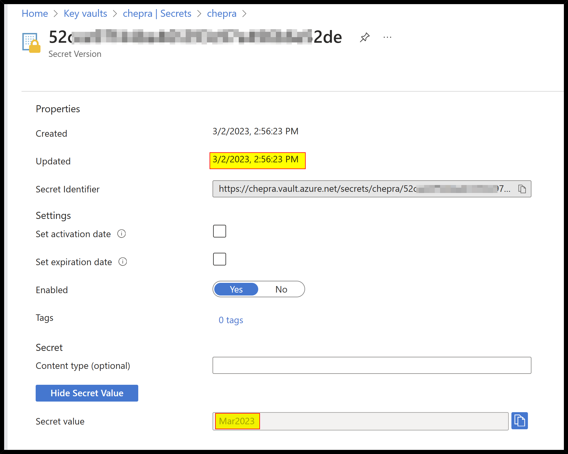

    Before: Here is the sample keyvault named chepra with key named chepra and the secretValue named Mar2023

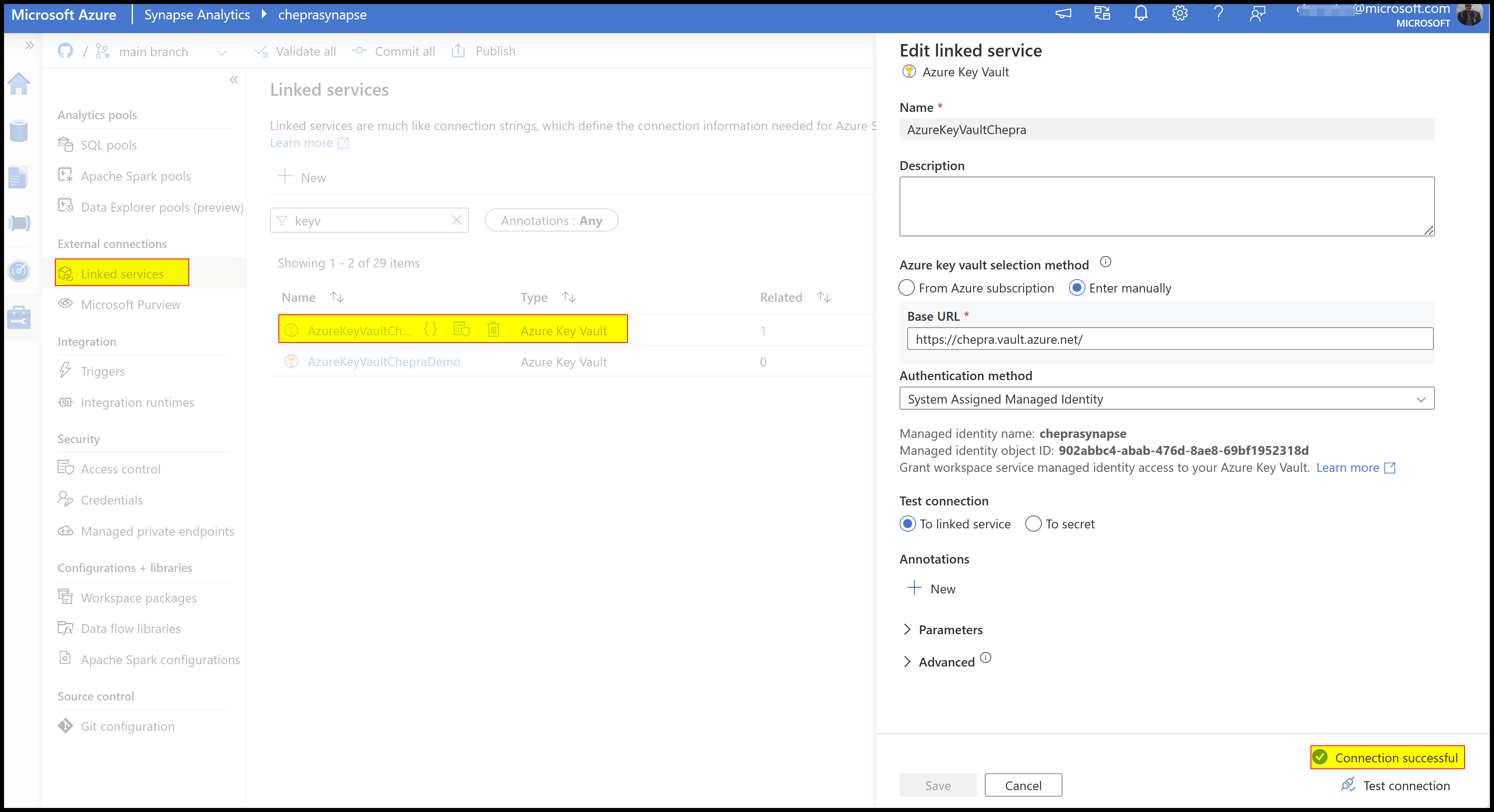

    Step1: Create a Azure Key Vault linked service which you want to use as shown below:

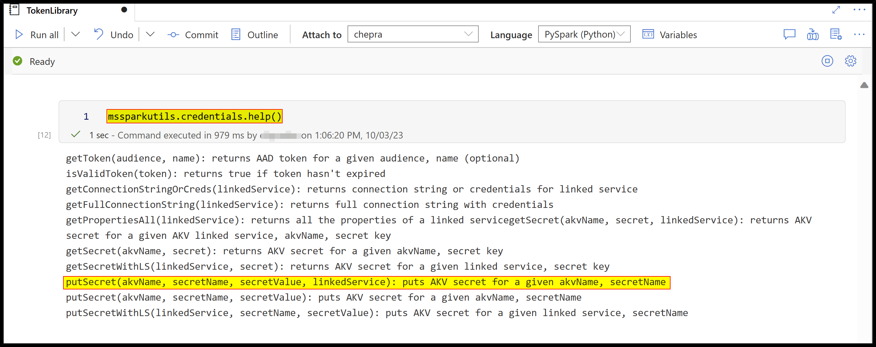

    Step2: You can use mssparkutils help for tokens and secrets.
    This function displays the help documentation for secrets and tokens management in Synapse.
    mssparkutils.credentials.help()

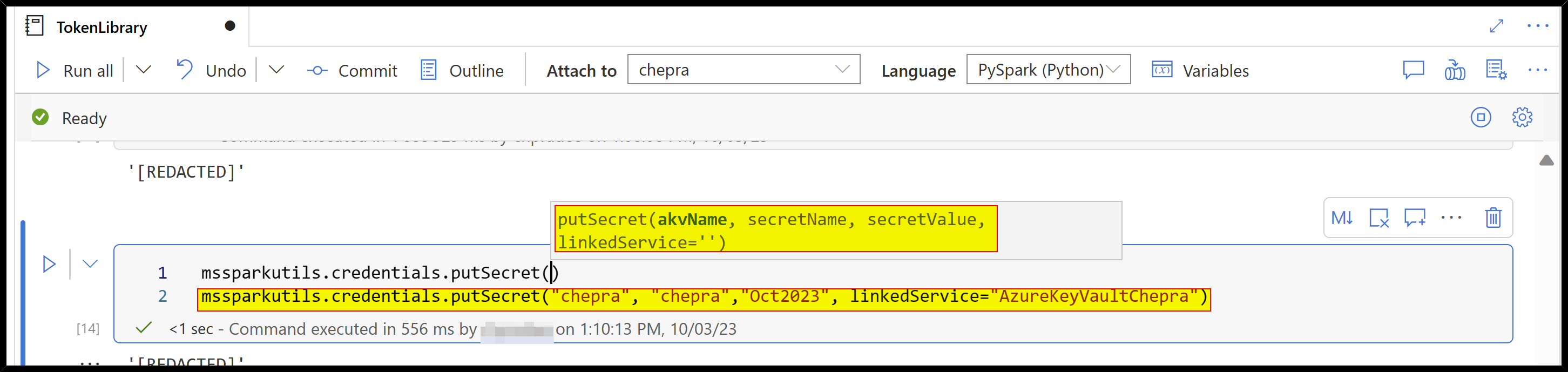

    Step3: From mssparkutils help for tokens and secrets use putSecret(akvName: String, secretName: String, secretValue: String): puts AKV secret for a given akvName, secretName

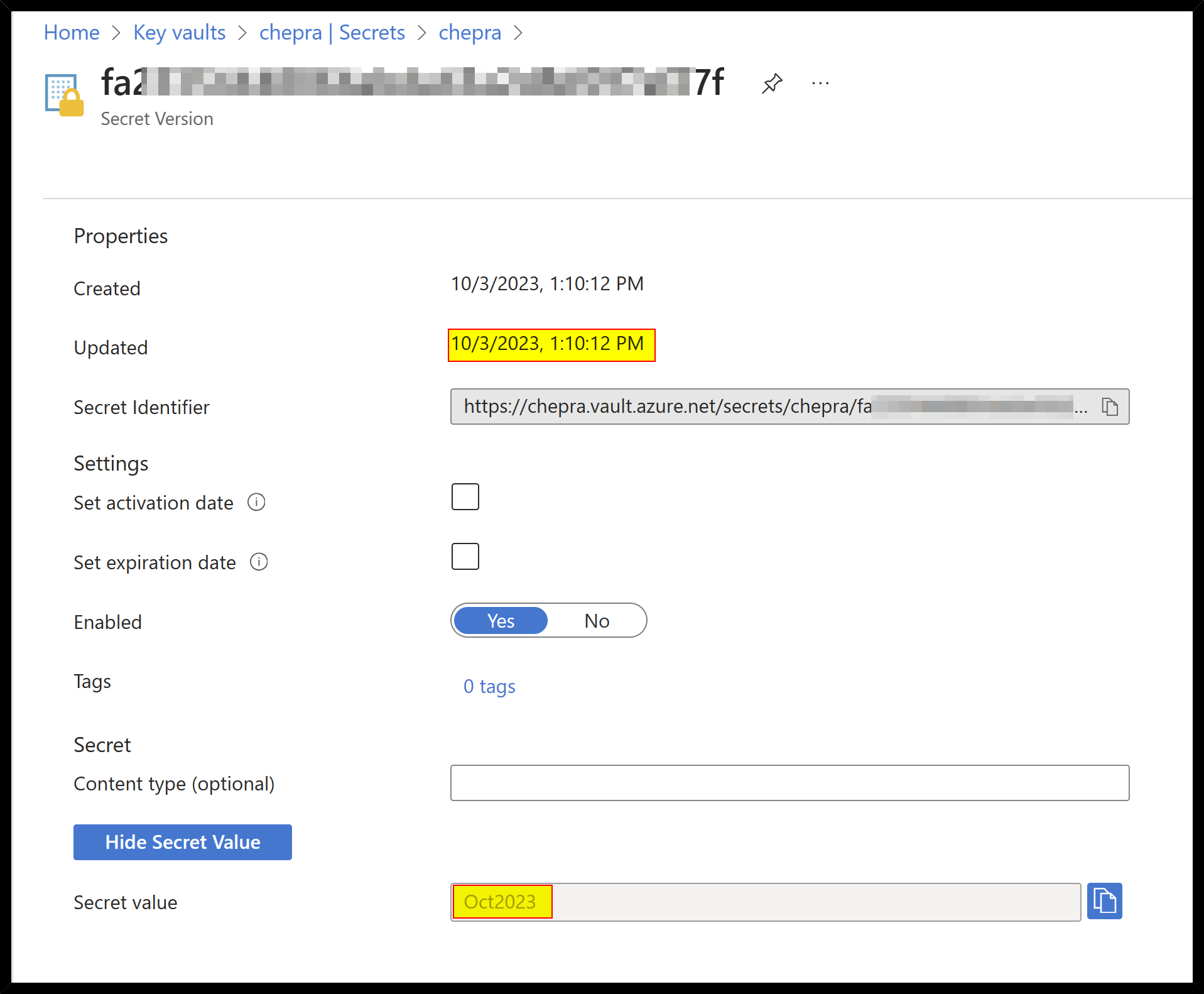

    After: Here is the sample keyvault named chepra with key named chepra and the secretValue named Oct2023
