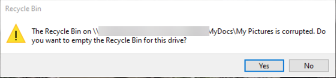

Background-
We were using folder redirection to a Users share on a server. We are also using Offline files
In prep to migrate the users data to Onedrive, we turned off folder redirection, redirected back to the C:\ drive and are now redirecting known folders to OneDrive.
A few months later we removed access for our Users to the Users Share.
Shortly after we removed the access when users tried to access their recycle bin they would get an error that recycle bin on the old Users share where they were being redirected to is corrupt. See attached image.
We've tried turning on offline files on a specific users machine and then explicitly denying the users account access to the share and the error still occurs. I'm thinking that there are documents in the recycle bin that were deleted from the redirected folder on the share and now when trying to open it the user no longer has access to where these files were deleted from and that causing the issue.
How can we cut that ties to old location?2023-09-28_14-07-25
