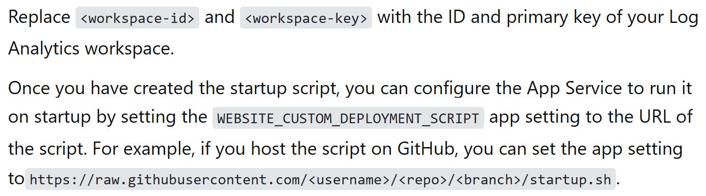

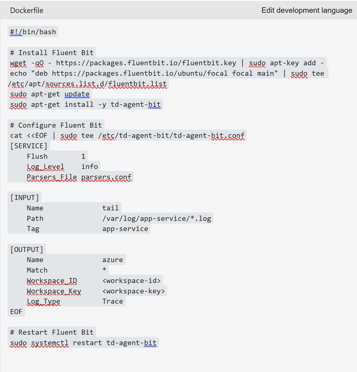

    @Kumar Challa Yes, you can use Fluent Bit to collect logs from your Azure App Service and send them to Grafana through a Log Analytics workspace. Installing Fluent Bit through a shell script is one way to do it. Here are the high-level steps you can follow:
    1. Create a Log Analytics workspace in your Azure subscription.
    2. Enable diagnostic logs for your App Service and configure them to send logs to the Log Analytics workspace.
    3. Create a Linux-based App Service plan and deploy your app to it.
    4. Create a startup script that installs Fluent Bit and configures it to send logs to the Log Analytics workspace.
    5. Configure the App Service to run the startup script on startup.
