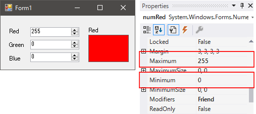

  1. KOZ6.0 6,735 Reputation points
    2023-09-29T20:25:28.9+00:00
    Let's create a dictionary for KnownColor
    Private _NamedColors As Dictionary(Of Color, String)
    Private ReadOnly Property NamedColors As IReadOnlyDictionary(Of Color, String)
        Get
            If _NamedColors Is Nothing Then
                _NamedColors = New Dictionary(Of Color, String)()
                For Each kColor As KnownColor In [Enum].GetValues(GetType(KnownColor))
                    Dim color As Color =
                             Color.FromArgb(Color.FromKnownColor(kColor).ToArgb())
                    _NamedColors(color) = kColor.ToString()
                Next
            End If
            Return _NamedColors
        End Get
    End Property
    Private Sub Button1_Click(sender As Object, e As EventArgs) Handles Button1.Click
        Dim red, green, blue As Integer
        If Integer.TryParse(txtRed.Text, red) AndAlso Integer.TryParse(txtGreen.Text, green) AndAlso Integer.TryParse(txtBlue.Text, blue) Then
            Try
                Dim cor As Color = Color.FromArgb(red, green, blue)
                Dim nameStr As String = Nothing
                If NamedColors.TryGetValue(cor, nameStr) Then
                    lblNomeCor.Text = nameStr
                Else
                    lblNomeCor.Text = cor.Name
                End If
                picCor.BackColor = cor
            Catch ex As ArgumentException
                MessageBox.Show(ex.Message, ex.Source, MessageBoxButtons.OK, MessageBoxIcon.Error)
            End Try
        Else
            MessageBox.Show("Enter valid values for R, G e B.", "Erro", MessageBoxButtons.OK, MessageBoxIcon.Error)
        End If
    End Sub
    TextBox is fine, but try NumericUpDown as well.:)
