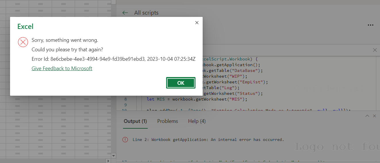

Office Script - getRange / getWorksheet etc. - Error An internal error has occurred
Please refer the below script - when I run it on Excel Web - I get the error mentioned below.
Whereas I run the same script in Excel Desktop App - it works fine.
I have started getting this issue 28-Sep-2023. Earlier the script was working fine.
I request your quick support as my lot of work is on hold due to this & if Microsoft does not support us then I believe we should avoid using Microsoft Prodcuts due to such issue and no support.

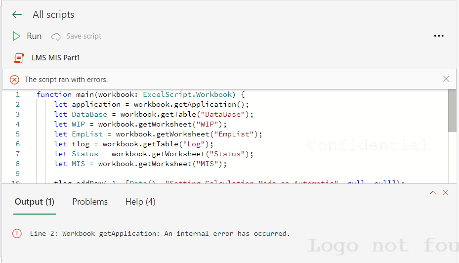

Error:
Line 3: Workbook getWorksheet: An internal error has occurred.

My Response:
I am facing the issue in Excel Web. But when I am trying to run the same script in Desktop Excel - It works fine. And the same script was working perfectly until 28 Sep 2023 on Excel Web.

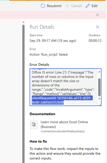

clientRequestIdfrom the failed Run script action and share here? I can look further and see there are any issues in our service. Thanks!Here is how you can find the clientRequestId:
Pratap Rajput • 30 Reputation points
2023-10-04T07:26:16.2833333+00:00 Pls find the ID (when running through PowerAutomate) "clientRequestId": "fda100b2-dec8-440e-9d23-9f7936770570"
And following is the error when trying to run script manually (tried today)
On First Run get following error
If after above error if try to re-run the same script getting following error - you will observe that the error line is now changed to 2 - whereas I am running the same script after above error.
if after error first error I am trying to navigate to another sheet - it gives following error.

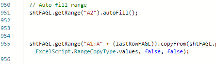

I am experiencing same issues with a o365 power automate flow firing a bunch of excelscripts, since 29th (prior triggered flow ran on 25th; and that one and prior runs have been working fine).
At a given point the code just stops, where it used to run fine; Basis data is unchanged.
Traced it back when running in o365 excel interactively where statement on line 951 almost always fails now:
prior to this failing statement other Range related statements still work and are referencing the same sheet.

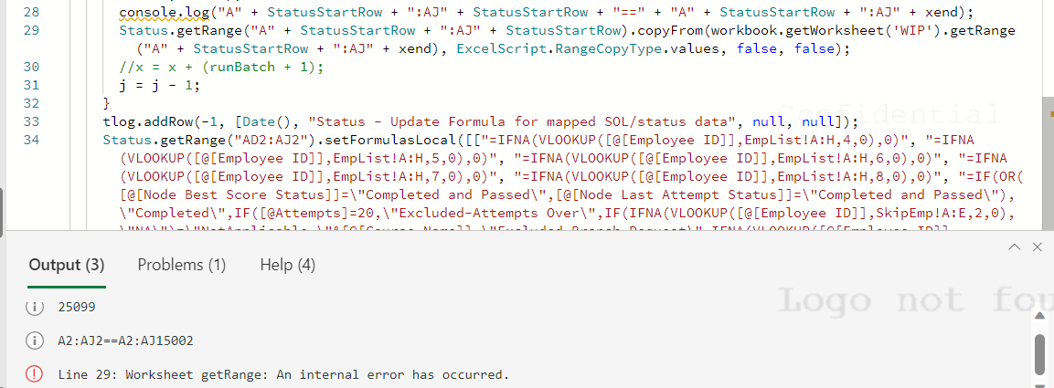

Yutao Huang - MSFT • 701 Reputation points • Microsoft Employee2023-10-06T17:57:29.3466667+00:00 Hi all, just wanted to confirm if everyone experiencing the issue are using the
range.copyFrom()API in their code. We are now suspecting that could be the culprit based on our troubleshooting so far. Thanks! -
Yutao Huang - MSFT • 701 Reputation points • Microsoft Employee2023-10-06T18:23:18.4+00:00 Hi all, it seems the
range.copyFrom()API might be the culprit! While we are working on a fix to address that. If you happen to be using this API in your code, please see if you can work around by using things likerange.getValues()thenrange.setValues(). Thanks! -

i can confirm following: the line after the line that appears to throw the error is actually a copyfrom statement
getValues() > setValues()
getFormulas() > setFormulas() (<< @Pratap Rajput : this could be your temporary work-around)I haven't found a get/set variant for the formats, which makes me stuck at the copytype All as well.

Yutao Huang - MSFT • 701 Reputation points • Microsoft Employee2023-10-07T17:42:01.39+00:00 @Inge Thijsen-Kuppen , @Pratap Rajput
Based on our investigation so far, the issue seems to be related to copy/paste of formulas as values. So the other copying/pasting scenarios (
RangeCopyType.formats,RangeCopyType.formulas, andRangeCopyType.all) might still work.I tried these scenarios on my end, and they all seem to work. Would you want to give it a try?
Regarding time out in
setValues, a temporary workaround could be to split it into smaller batches (e.g., 5,000 rows per batch). Also please note you may need to doconsole.log("...")after each batch to force flushing the queued data. (Reference). -

Yutao Huang - MSFT • 701 Reputation points • Microsoft Employee2023-10-09T16:10:38.9+00:00 Range.copyFrom( sourceRange: Range | RangeAreas | string, copyType?: RangeCopyType, skipBlanks?: boolean, transpose?: boolean ): void;To clarify, based on our current investigation, at this moment
Range.copyFrom()only has issues whencopyTypeisExcelScript.RangeCopyType.values. The temporary workaround is to userange.getValues()andrange.setValues()plus some batching (e.g., 5,000 rows per batch, withconsole.log("...")after each batch to flush queued data operations, refer to this for more details and an example).The other copyTypes (e.g.,
ExcelScript.RangeCopyType.all,ExcelScript.RangeCopyType.formats,ExcelScript.RangeCopyType.formulas, etc.) should still work as expected.We have identified the root cause and are now working on a potential fix. Will keep you all posted. Thanks again for your patience.

from my experience script error line is off.
it’ll state the error to be thrown on line x, but actually it’s the code-line after that.
i am 99% sure you have a copyfrom with copytype values on that line.

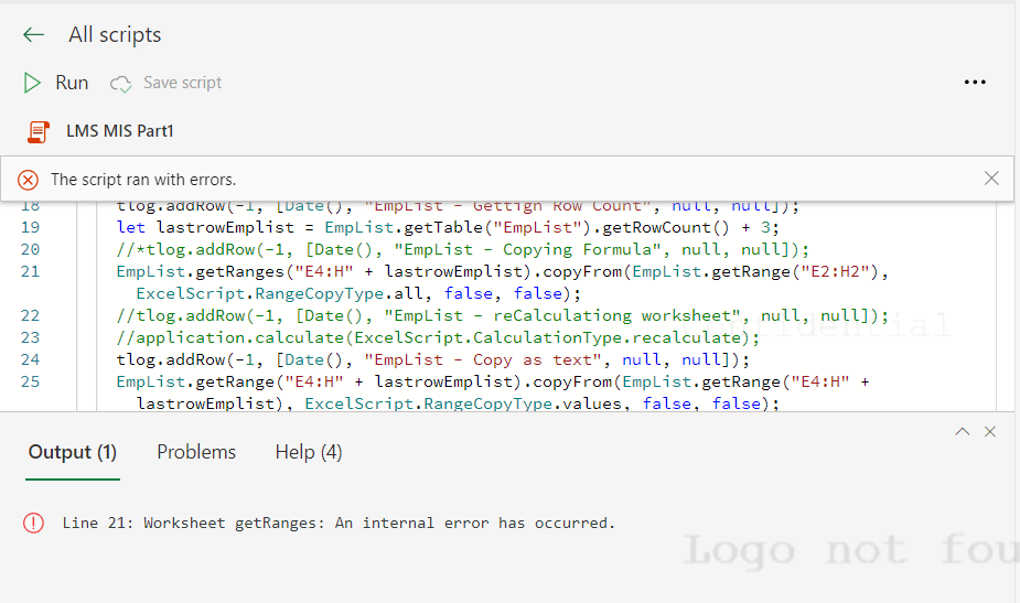

2023-10-19T07:01:52.45+00:00 Error Screenshot
Yutao Huang - MSFT • 701 Reputation points • Microsoft Employee2023-10-19T13:45:45.38+00:00 @Pratap Rajput Please try closing the workbook, wait for ~10 minutes, open it again, and see if you are still experiencing the problem. Sometimes there might be some caching issues. If the issue still exists, can you share your session ID and I can take a look at the logs? Thanks!

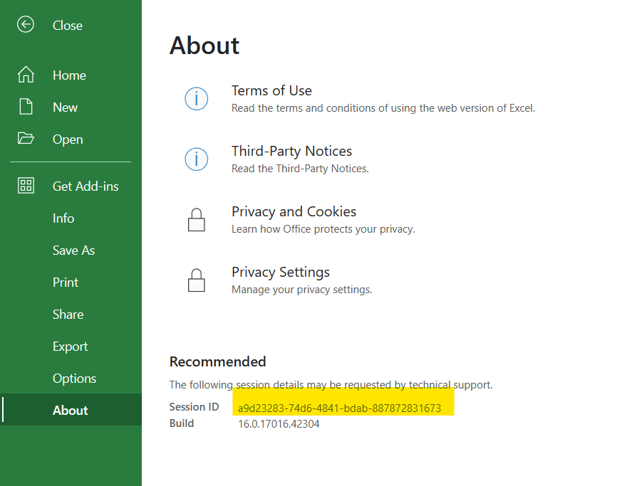

My excel build version states: 16.0.17016.42303 (O365 excel > File > About)
Paul Relf-Davies • 0 Reputation points
2023-11-28T17:20:46.8333333+00:00 I've come across this issue around 6 weeks after it was fixed. I think I've found a potentially related problem.
My script uses the Range.copyFrom() method, but using the 'RangeCopyType.all' flag rather than 'RangeCopyType.values'.
The next Worksheet.getRange() or Worksheet.getRangeByIndexes() call triggers a 'Worksheet getRange: An internal error has occurred.' error.
It seems the actual parameters passed to either of those methods don't matter.
Finally, if I call console.log("") after the Range.copyFrom() call, the error isn't triggered, but obviously, there is a significant performance hit.
