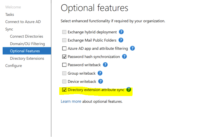

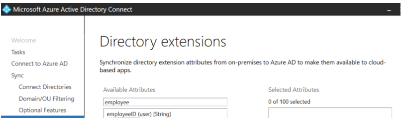

  1. Andy David - MVP 157.8K Reputation points
    2023-10-02T12:20:33.2666667+00:00
1 additional answer
  1. Marilee Turscak-MSFT 37,206 Reputation points Microsoft Employee Moderator
    2023-10-06T23:30:33.3933333+00:00
    @Sonander, Peter
    The directory extensions option suggested by Andy David is the available option for your scenario. Since employeeID attribute is not a default attribute in Entra and is stored in the additional properties, you wouldn't be able to map it directly otherwise.
