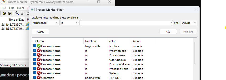

2023-10-06T18:39:23.4533333+00:00 Use Process Monitor and trace the activity.
https://learn.microsoft.com/en-us/sysinternals/downloads/procmon
Start by adding a filter for "Process name begins with iexplore".
Then recreate the problem. Press Ctrl+E to stop the capture. Then under the Tools menu select Network Summary. See if it lists any DNS servers or any external site names or IP addresses.
If you don't see anything out of the ordinary, then check the raw trace and see if you can find big gaps in the Time of Day column. That would indicate that the browser is waiting for something.
The next step would be to add a filter for "Process name begins with msedge" and see if one of those processes is doing something while you are waiting. Ctrl+E (or the magnifying glass icon) toggles the capture. I recommend clearing the trace between tests. Ctrl+X.

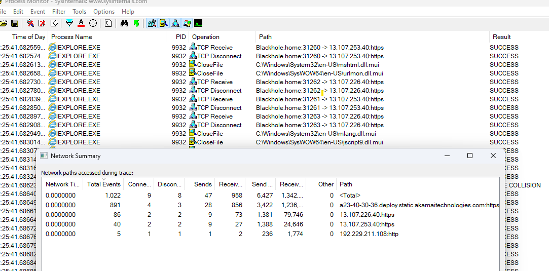

John_1901 • 10 Reputation points

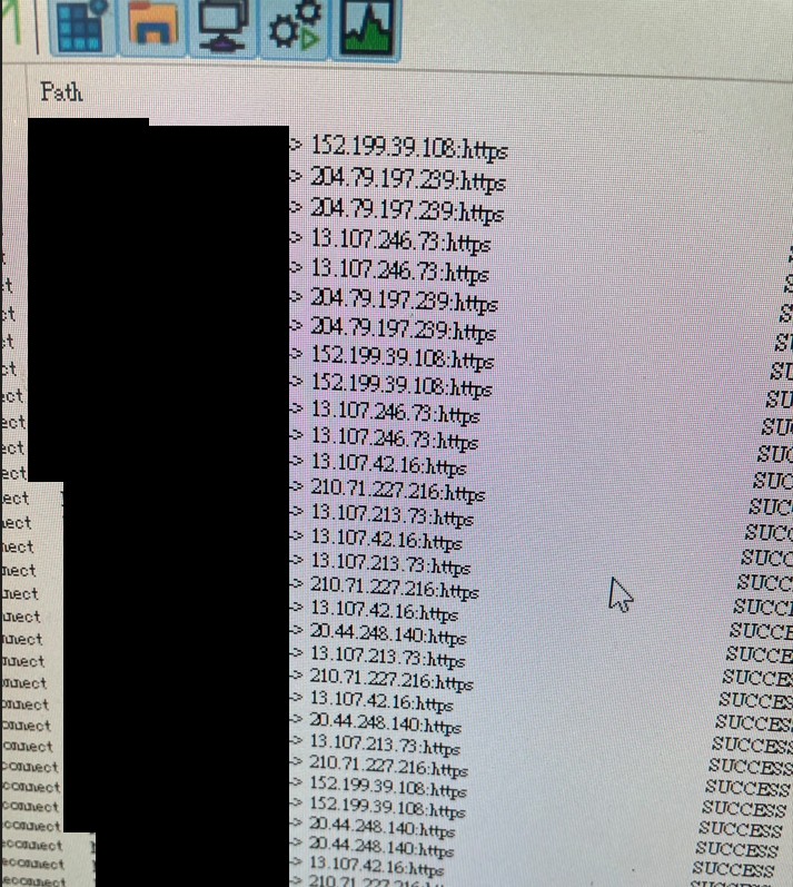

2023-11-08T08:22:00.4433333+00:00 Hi @MotoX80 ,
After observation, we found that all processes are connected to these IPs.
Since the computer is within a local network, is this the reason for the slow loading speed of IE mode?
It is speculated that IE mode requires connecting to Microsoft. Is there a way to cancel verification?

MotoX80 • 36,291 Reputation points
2023-11-10T02:12:51.1533333+00:00 I'm sorry, but I have no way of knowing what web sites your browser is trying to access. My reply about using Process Monitor would be my best suggestion to try to understand what MSEdge is doing when it loads slow. Is it doing file I/O, is it waiting on an HTTP request, I don't know, you will need to analyze the trace.
2023-11-10T17:57:34.4833333+00:00 I took some of the IP's that you have listed in that image and did a whois lookup. While that reports that Microsoft owns the IP range, I did an nslookup on the IP and no names were found. Then I tried using curl to see what page I got back.
Your image shows https connections which won't let me access the page because I don't know the web site name that matches the certificate. Some like the one above have http exposed where I can see that this is Azure related.
While Microsoft may be the host provider, they do not look like they are Microsoft Windows related sites. They are Azure or Azure content distribution addresses for customer sites. We would need to know what https://name your pc is trying to access.
Try running an "ipconfig /displaydns" command to see if any names match the listed addresses.
2023-11-13T03:38:25.7933333+00:00 Hi @MotoX80 ,
Later, I found this paragraph from the inter-process compiler: deploy.static.akamaitechnologies
I tried enabling this IP in the firewall settings and found that IE mode loaded just as fast as connecting to the internet!
But I don’t know the reason at the moment. Some computers have the effect, while others don’t. The loading speed of IE mode is just as slow! !
If my method is correct, do I need to start other IPs or services for other computers to take effect?

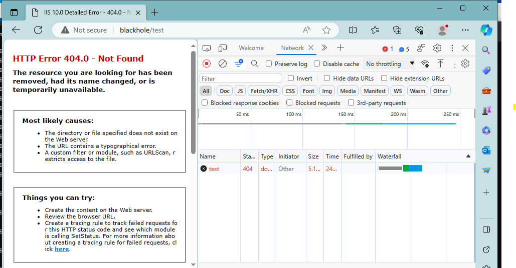

2023-11-13T16:11:52.3066667+00:00 I have no way to know what your browser/PC is doing.

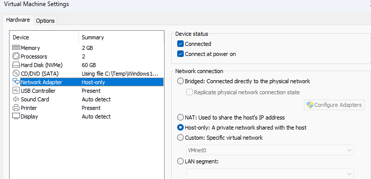

I tried to recreate a setup that is similar to the environment that you've described.
On my laptop, I have a Win10 VM and I configured it to have a host only network. This blocks internet access for the VM

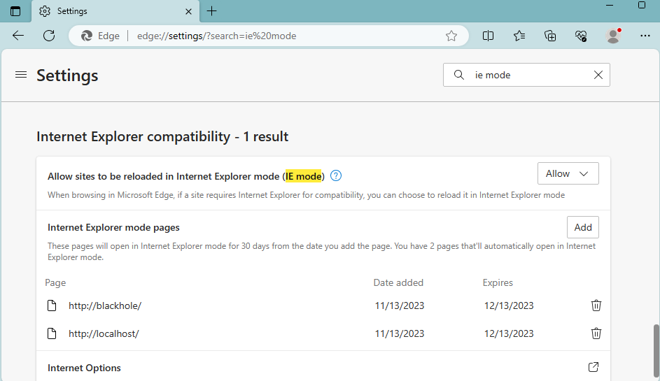

Then on the VM, I set it to open my laptop's home page in IE mode.

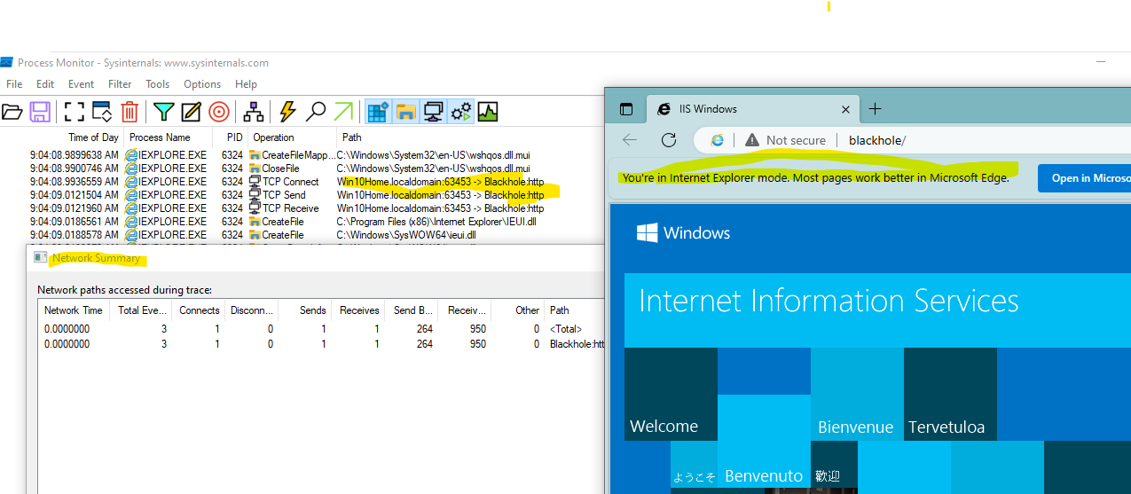

From a command prompt I did a "start msedge http://blackhole".
I do not see any HTTP traffic other than the requested page. I do see one netbios name lookup but that's it. It took around 9 seconds to load that page. The VM does not have much memory.
If your pc's are reaching out to other internet sites, then you must have something else installed that is causing that activity. What are you using for antivirus? Defender or a 3rd party product? Does it have a browser plugin that might be trying to check on something?
From my experience, you need to identify what sites your browser is trying to load that is causing your delay. From the http://UrlAddress you should be able to track that back to some software or setting.
If you can't capture the activity with Process Monitor, then try hitting F12 to launch the developer tools and check the network tab to see if that shows anything.
It's quite possible that the internal web page has references or javascripts that reach out to internet sites.
