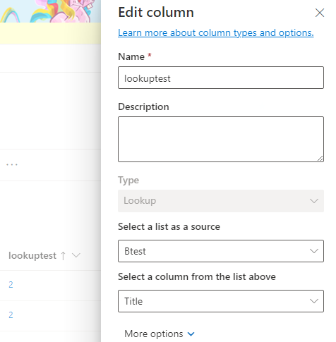

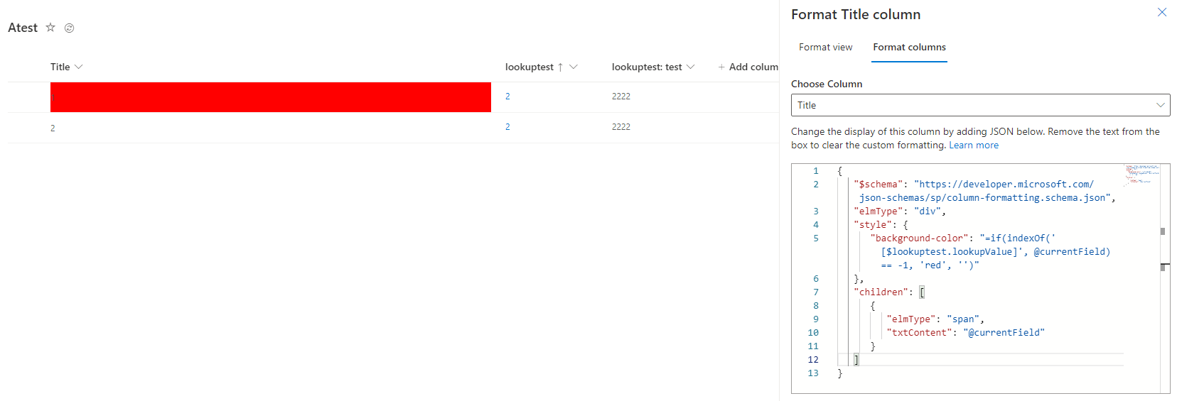

    This is my testing process:
    1, The lookup column in calendar list:
    2, The test result:
    Hope this helps.
