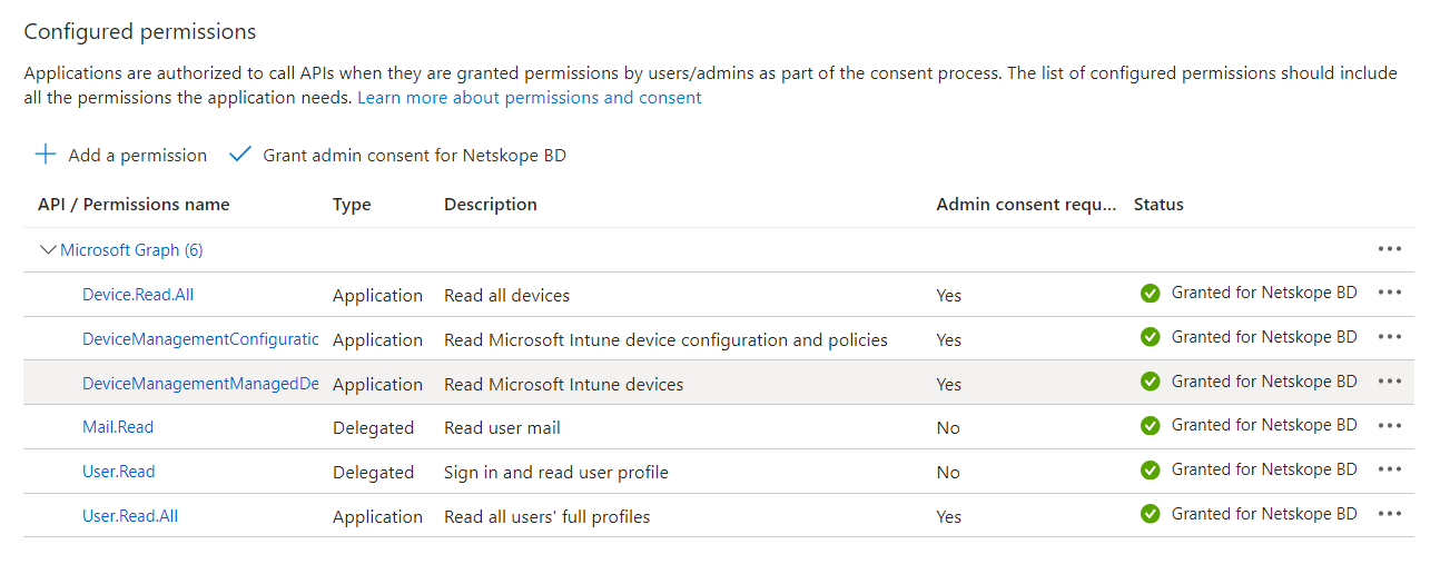

Is this permission issue?
I have configured below permissions

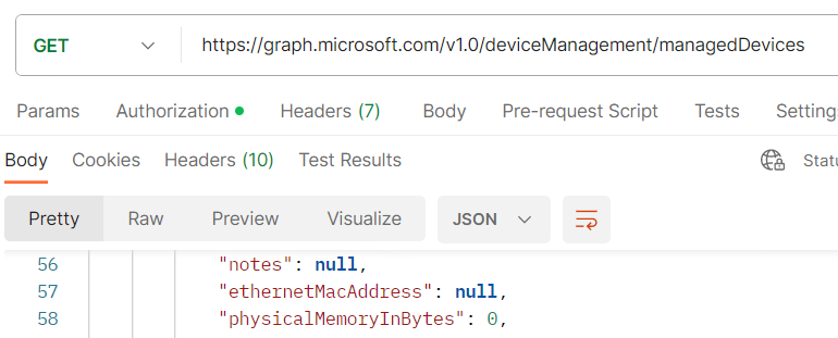

When querying list of managed devices with '/deviceManagement/managedDevices' , I get null for ethernetMacAddress

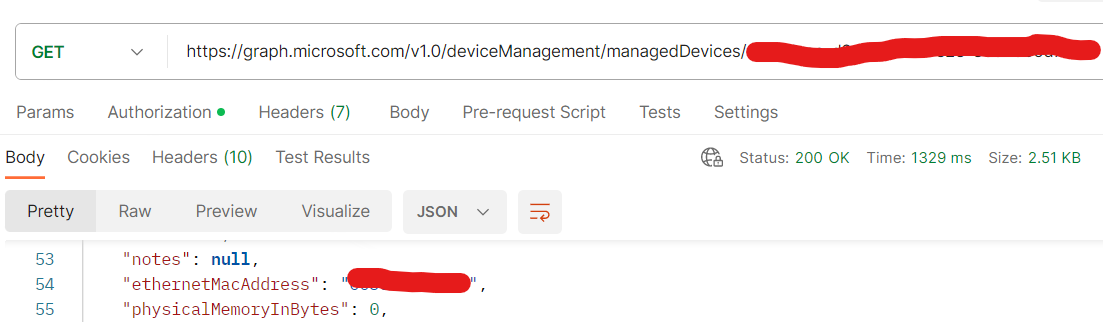

But if I query single device, I get mac address
