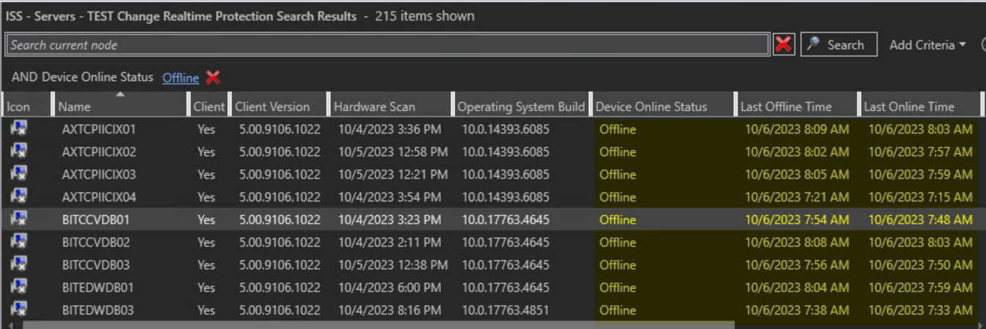

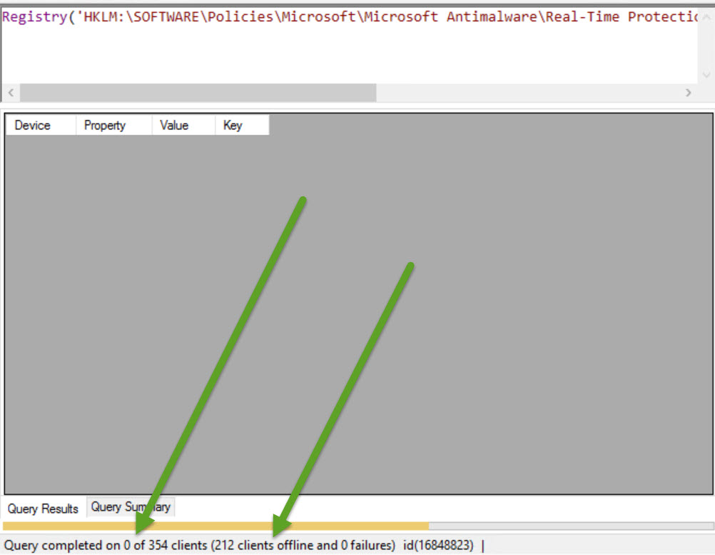

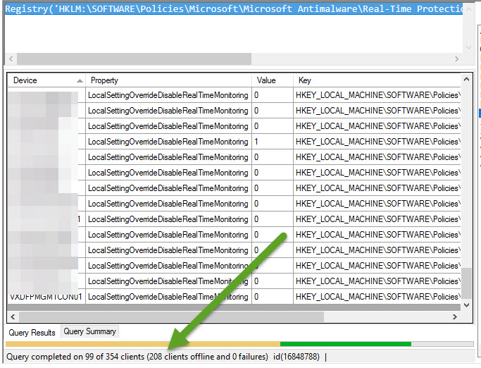

Hello,
I tried to use CMPivot but it shows all machines offline, what does it mean as they are servers ON 24/7?
even worst this morning...
I checked the status it is offline 7:54 am when it was online 7:48 what is causing this blipping? these are servers on 24/7 !!!
Thanks,
Dom
