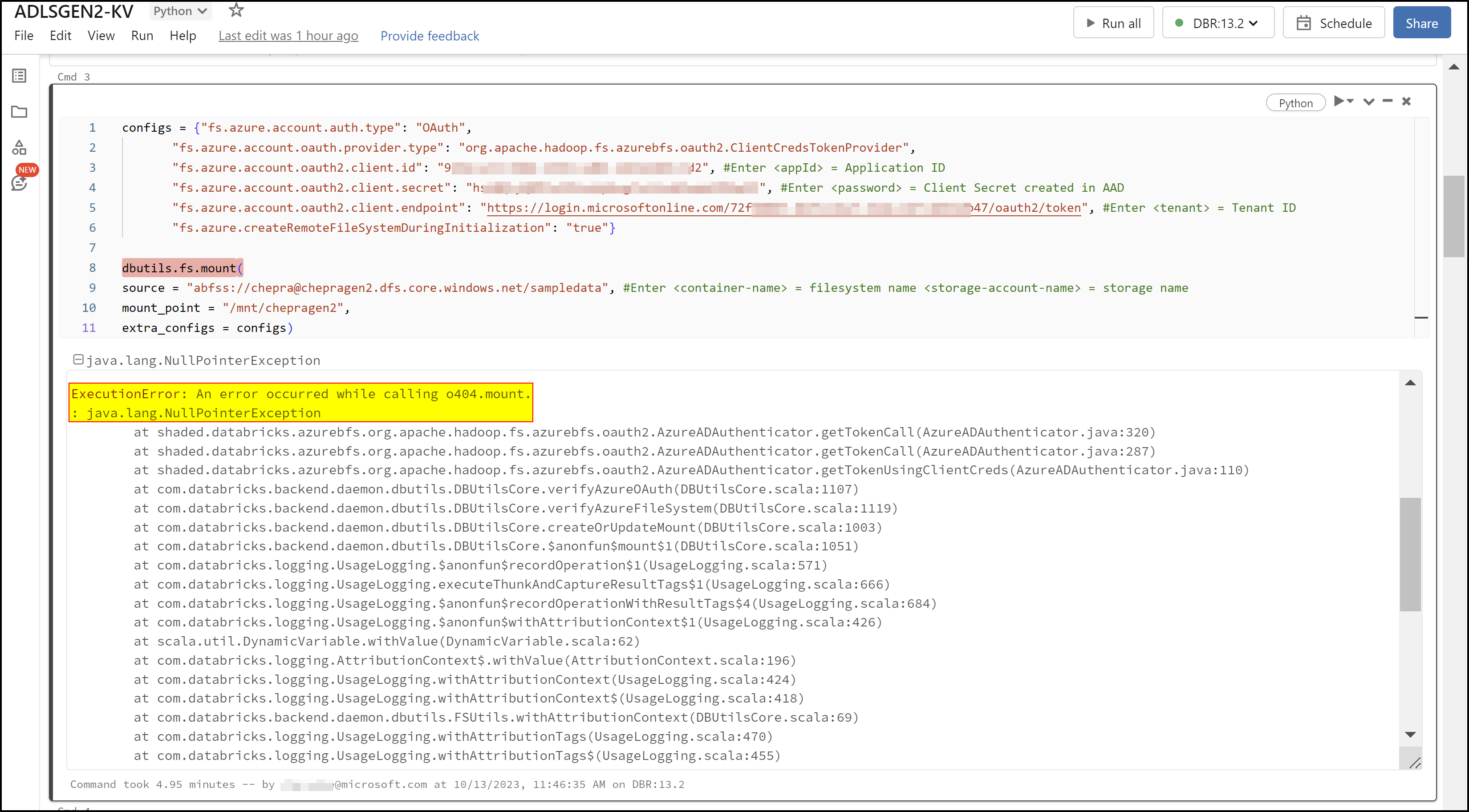

    When I tried to repro from my end, I was experience the same issue on the first run as shown below:
    When I tried to run again, I was getting the actual error message for the failure:

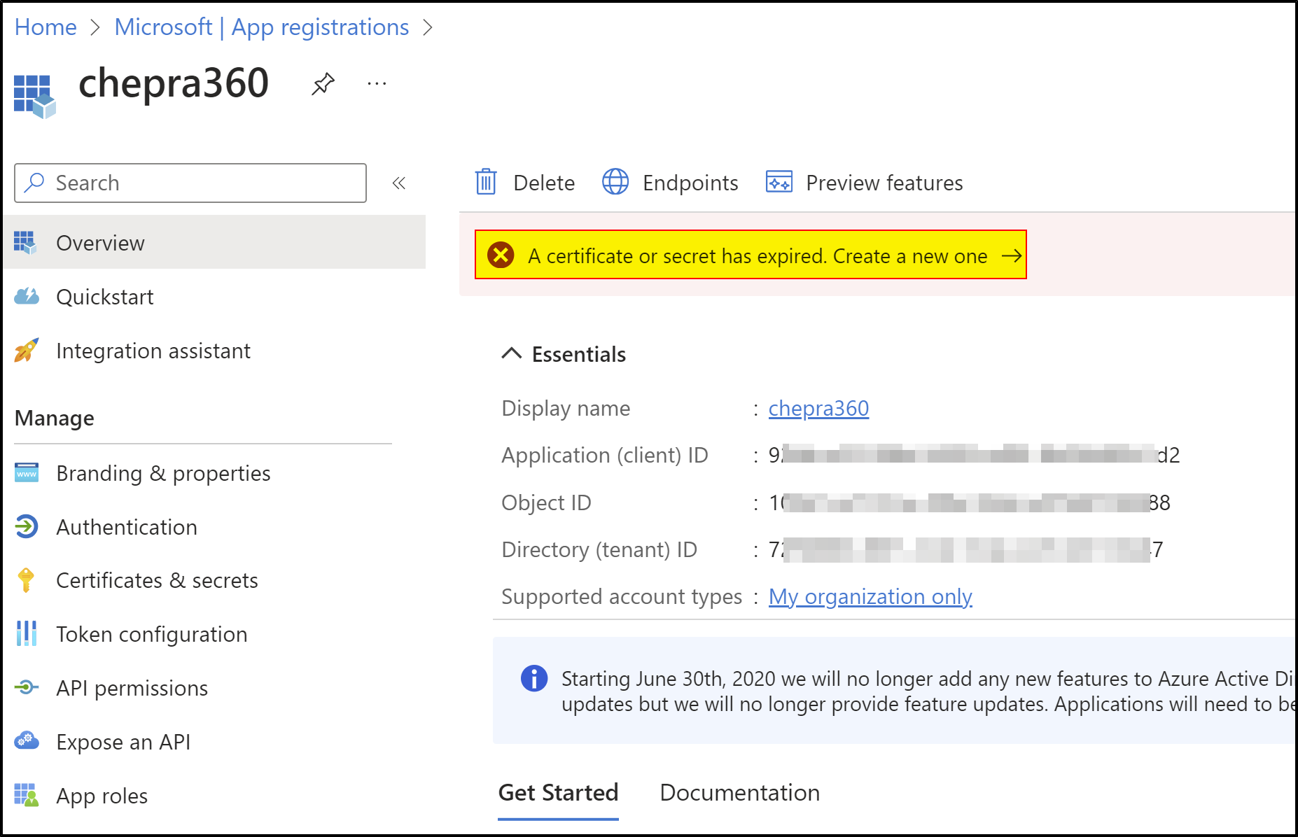

    From the error message, it clearly says as the secret key has been expired.

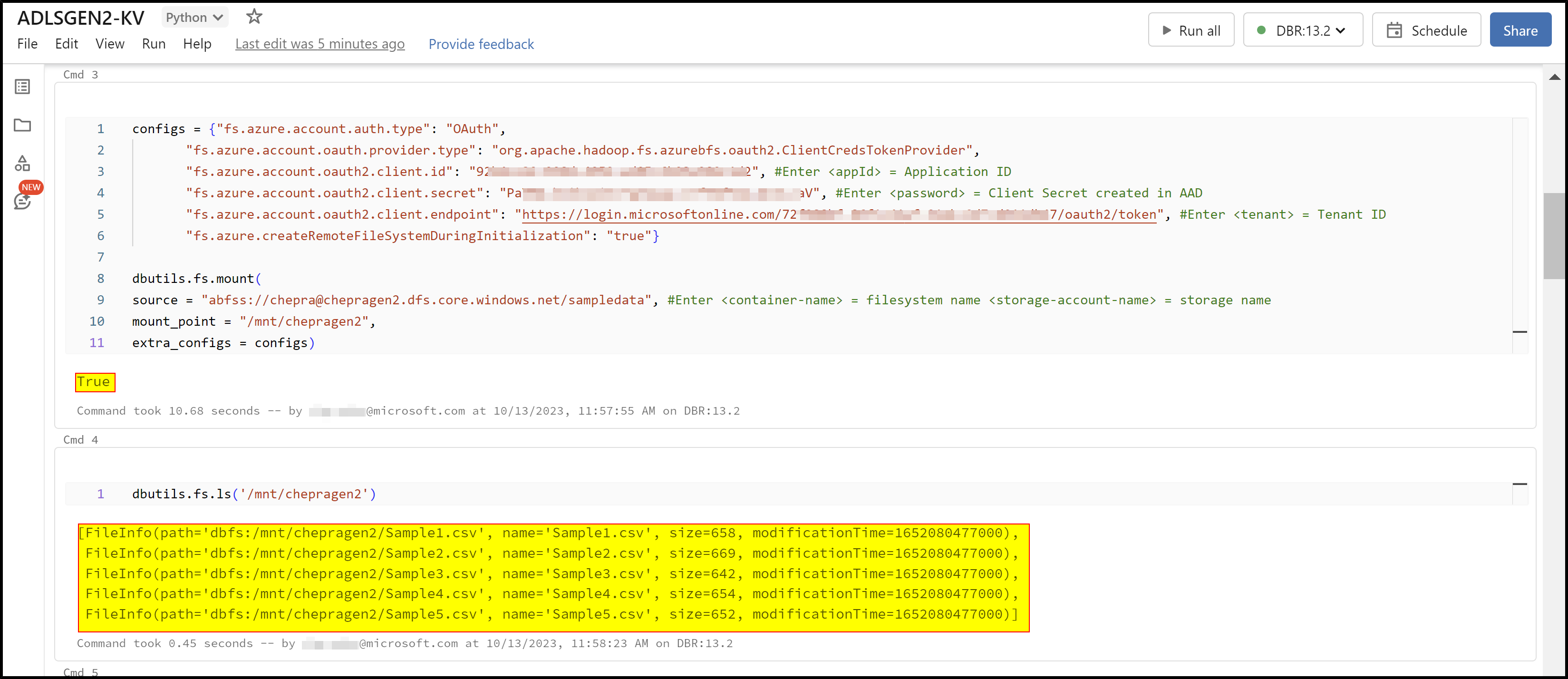

    Now, I had updated the secret key and ran again and now I'm able to successfully able to mount the ADLS gen2 using abfss protocol.
