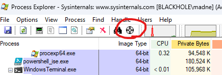

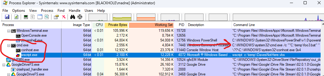

If you don't find anything, then download and run Process Explorer.
https://learn.microsoft.com/en-us/sysinternals/downloads/process-explorer
Click and hold on the target icon and drag and drop it onto the script window. That will highlight the process.
The process column will be indented by parent/child processes. Look at the parent to see if you can identify the bat file being called.

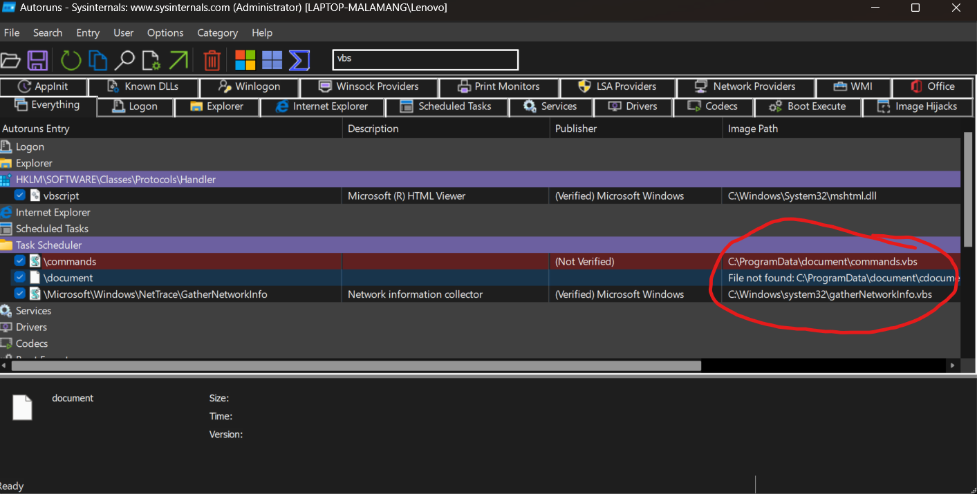

2023-10-28T20:34:19.7533333+00:00 it was flagged as harm in my anti virus, so I deleted it. i checked my recycle bin if it was there and it was not. i used autoruns again. i typed "vbs" inside of the quick filter box and this is what it showed
now I don't know what else to do
MotoX80 • 36,401 Reputation points
2023-10-29T00:51:57.5833333+00:00 If your AV flagged it as harmful, it would be real nice to know what malware/vulnerability/virus it detected. You really need to determine if this is a false positive, or if you have something on your pc that is scanning for your credit card numbers.

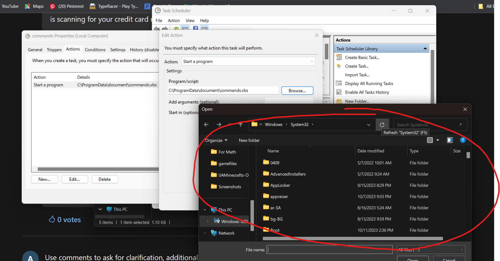

Based on the image that you posted, there is a commands.vbs file in that folder. What is in it? Use notepad to open it. Are there other files in that folder? What is in them? Can you track them back to some legitimate software that you installed?
If you don't know how to interpret VB script code, then post the contents, or share an image of what you find.
Using the Windows explorer, you may have to type in "C:\ProgramData" in order to see the folder contents. It's a hidden folder.

2023-10-29T12:14:44.0633333+00:00 Yes, the commands.vbs file. But you circled Windows\System32. That's not where the file is.

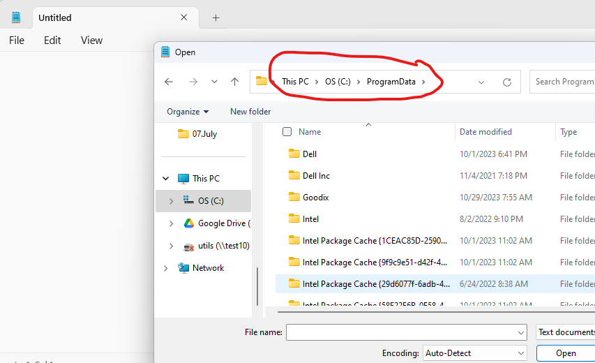

Run notepad and do a file/open. Type in C:\programdata and hit enter. Its hidden so it won't show up for you to click on it.
You will see folders from MS and your PC manufacturer. Look for the document folder and open it. If it is also hidden and you don't see it, type it in. Take a screen snapshot of the files that are in that folder. Find the .vbs file and open it.
If you don't recognize the contents or don't know how to interpret the code, then do a file/save and save it as a .txt file on your desktop. Use the paperclip icon and post it to the forum.

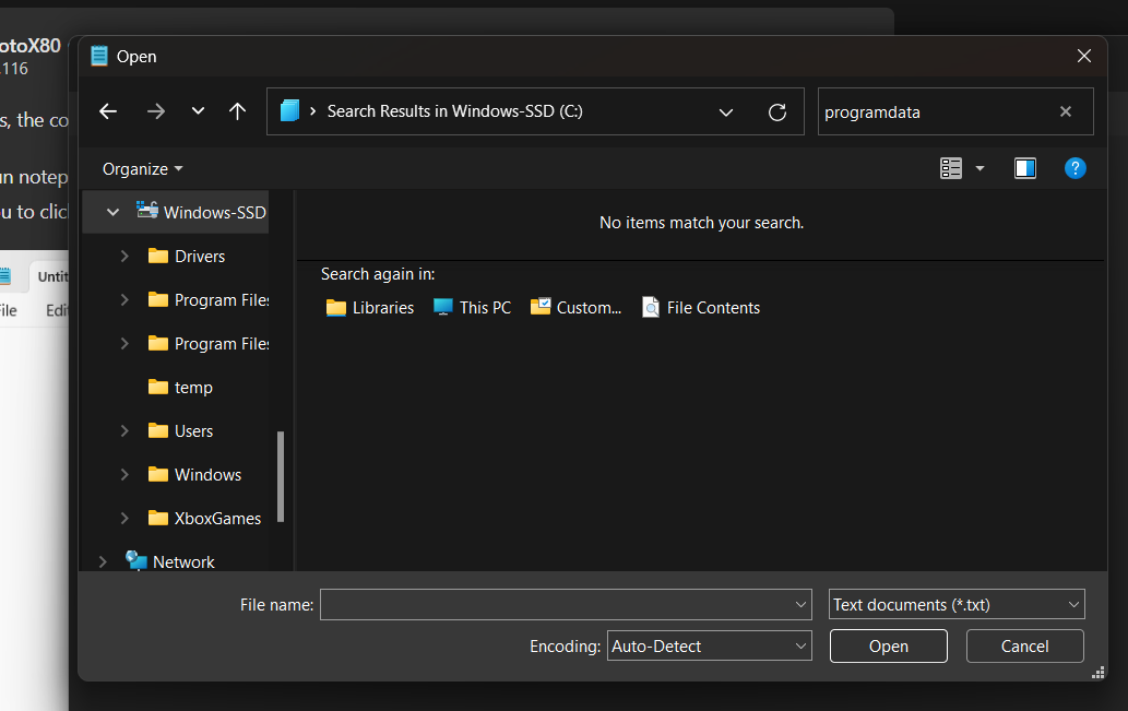

2023-10-30T17:03:57.6+00:00 it said no items match your search. What do I do?
2023-10-30T17:11:44.11+00:00 I didn't say to do a search. I said to run notepad, do a file/open and type in C:\ProgramData. It is a hidden folder.

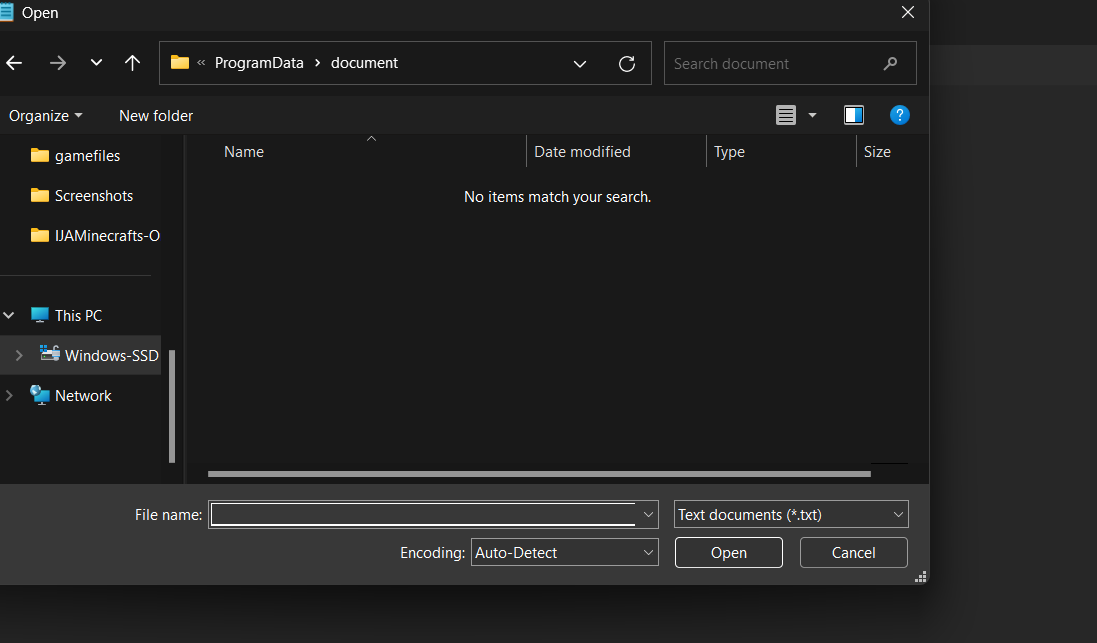

2023-10-30T17:28:59.32+00:00 what next?
2023-10-30T17:32:54.23+00:00 Double click on the document folder. Are there any other files besides commands.vbs in it?
Then open commands.vbs. What's in it?
Anne • 0 Reputation points
2023-10-30T17:38:18.79+00:00 what do i type in?

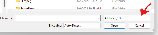

2023-10-30T17:44:25.93+00:00 Change this to All Files.
2023-10-30T17:48:05.2366667+00:00 there is no command.vbs

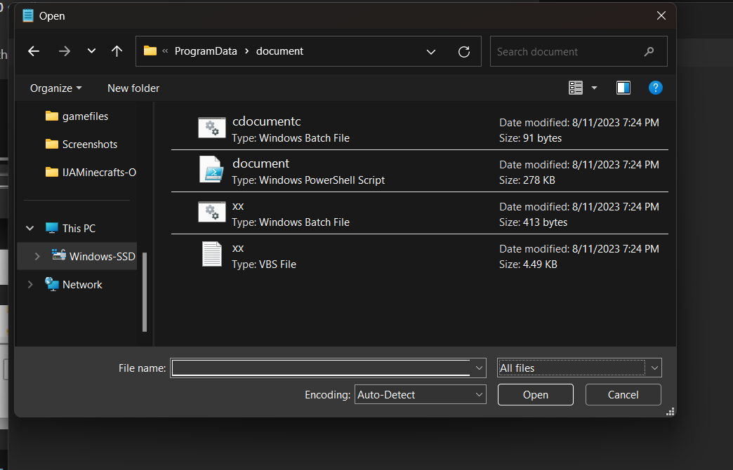

2023-10-30T18:02:52.9166667+00:00 Does August 11 ring any bells? What were you doing around 7:24 PM?
Open up all of those files with notepad. Let' see what's in them.
Basically, I want to get an idea if they are malicious or not. Or somehow track them back to something legitimate that you were doing.
Then we will run a full antivirus scan and a MRT scan.
I've helped some other forum users who got impacted with crypto mining malware. In their case it did not appear that they had exposed any personal data. So they deleted the files but had to install MalwareBytes because Windows Defender did not detect the files as malicious.
You might have to do that too. But we don't just want to delete those files without first understanding what risk, if any, they present to your personal data.
