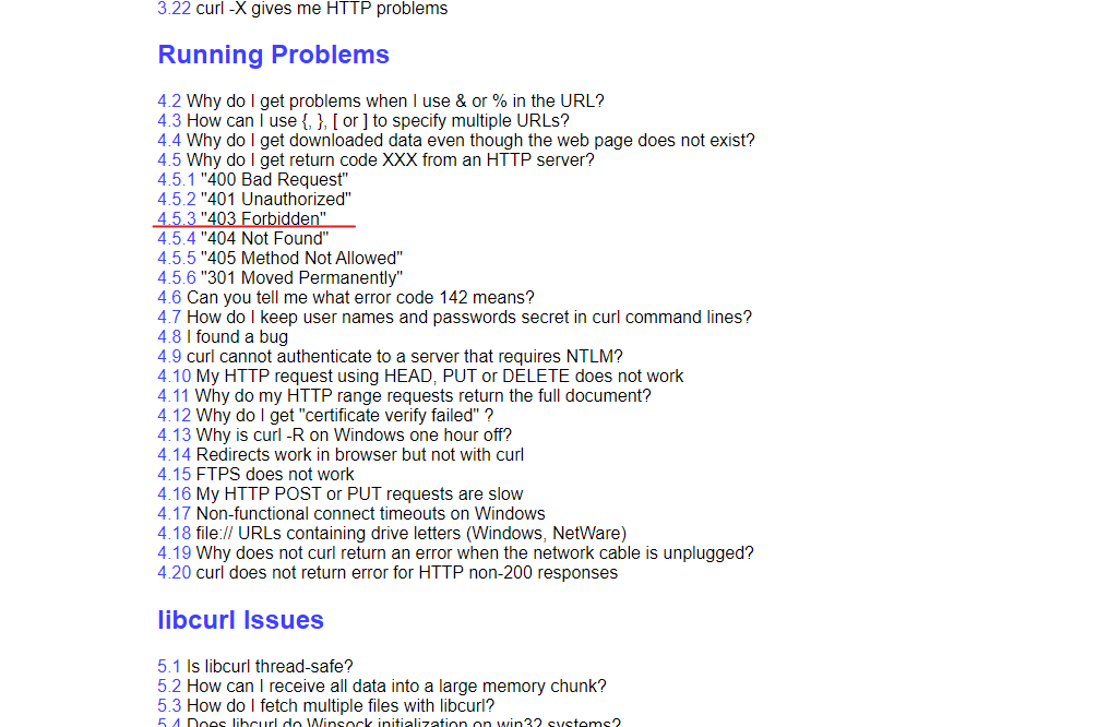

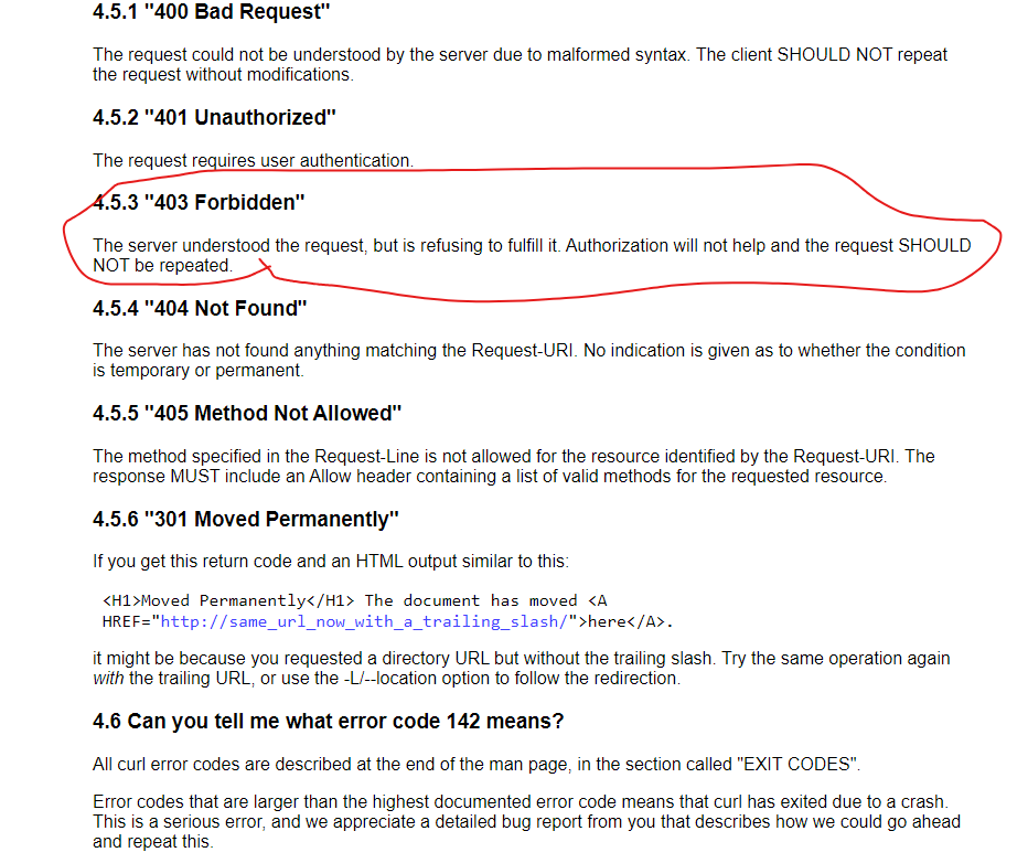

    Hi @Leon Pappadopoulos
    As far as I know
    403 error usually caused by your permissions to the folder haven’t replicated correctly on the server.
    Maybe you can try this
    curl --ntlm --user user:password --upload-file myPDF.pdf https://my.sharepoint.com/site/path/myPDF.pdf -H "Content-type:application/pdf"
    However, during my investigation, I found that it may not necessarily be supported:
    https://sharepoint.stackexchange.com/questions/205271/use-curl-to-upload-files-to-sharepoint-online
    I think Power shell might be a better choice:
    Here is a link for your referece:
    https://theitbros.com/powershell-upload-file-to-sharepoint/
    Best Regards
    Cheng Feng
