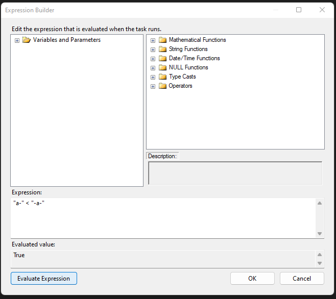

Let me express the same question in a second more obvious way: Expression Task
T-SQL

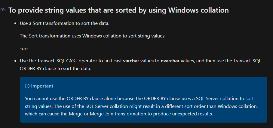

Seems that the following https://learn.microsoft.com/en-us/sql/integration-services/data-flow/transformations/sort-data-for-the-merge-and-merge-join-transformations?view=sql-server-ver16&source=docs#to-provide-string-values-that-are-sorted-by-using-windows-collation is not correct for the case above: User's image

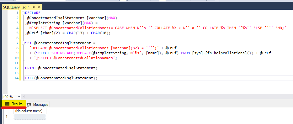

  2. GEORGIOS POLYCHRONAKOS 1 Reputation point
    2023-10-11T04:43:29.0366667+00:00
    DECLARE
     @ConcatenatedTsqlStatement [varchar](MAX)
     ,@TemplateString [varchar](MAX) =
      N'SELECT @ConcatenatedCollationNames+= CASE WHEN N''a-'' COLLATE %s < N''-a-'' COLLATE %s THEN ''%s'' ELSE '''' END;'
     ,@CrLf [char](2) = CHAR(13) + CHAR(10);
    SET @ConcatenatedTsqlStatement =
      'DECLARE @ConcatenatedCollationNames [varchar](32) = '''';' + @CrLf
      + (SELECT STRING_AGG(REPLACE(@TemplateString, N'%s', [name]), @CrLf) FROM [sys].[fn_helpcollations]()) + @CrLf
      + ';SELECT @ConcatenatedCollationNames';
    PRINT @ConcatenatedTsqlStatement;
    EXEC(@ConcatenatedTsqlStatement);
    messages
    results
