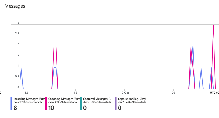

The Event Hub sometimes shows more outgoing than incoming messages, which I assume should indicate that more than one consumer is listening, but the Function is not triggering:User's image

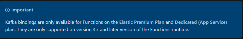

  1. Mike Urnun 9,792 Reputation points Moderator
    2023-10-24T03:07:30.03+00:00
    Hello @Nikolaj Nielsen - Sorry for the late reply. Did you try deploying to the other SKUs and see if the same behavior is observed? I believe it is so because the Kafka bindings aren't supported on the Consumption SKU:User's image
