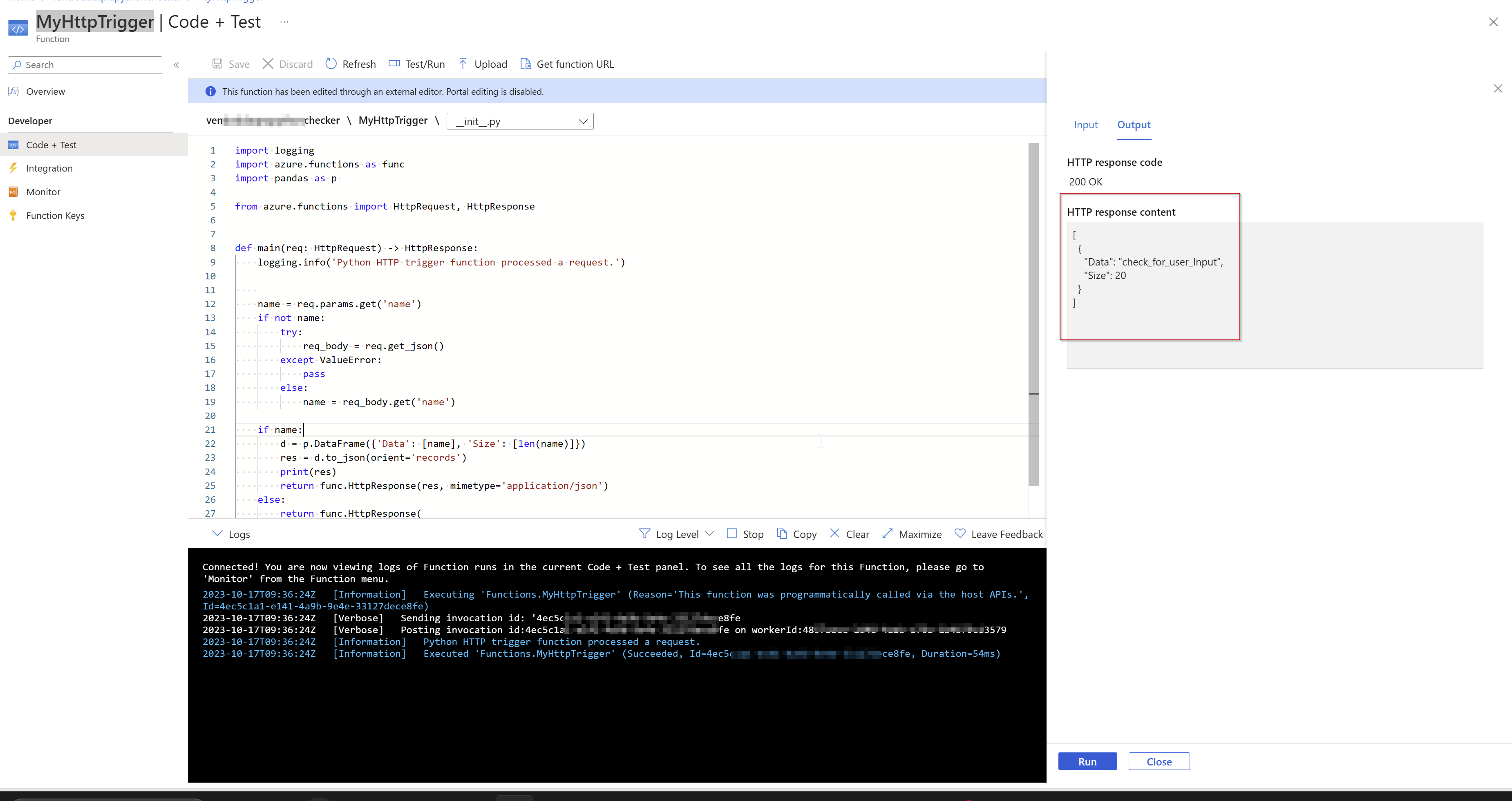

    1. Output from Code+Test in portal.
    enter image description here

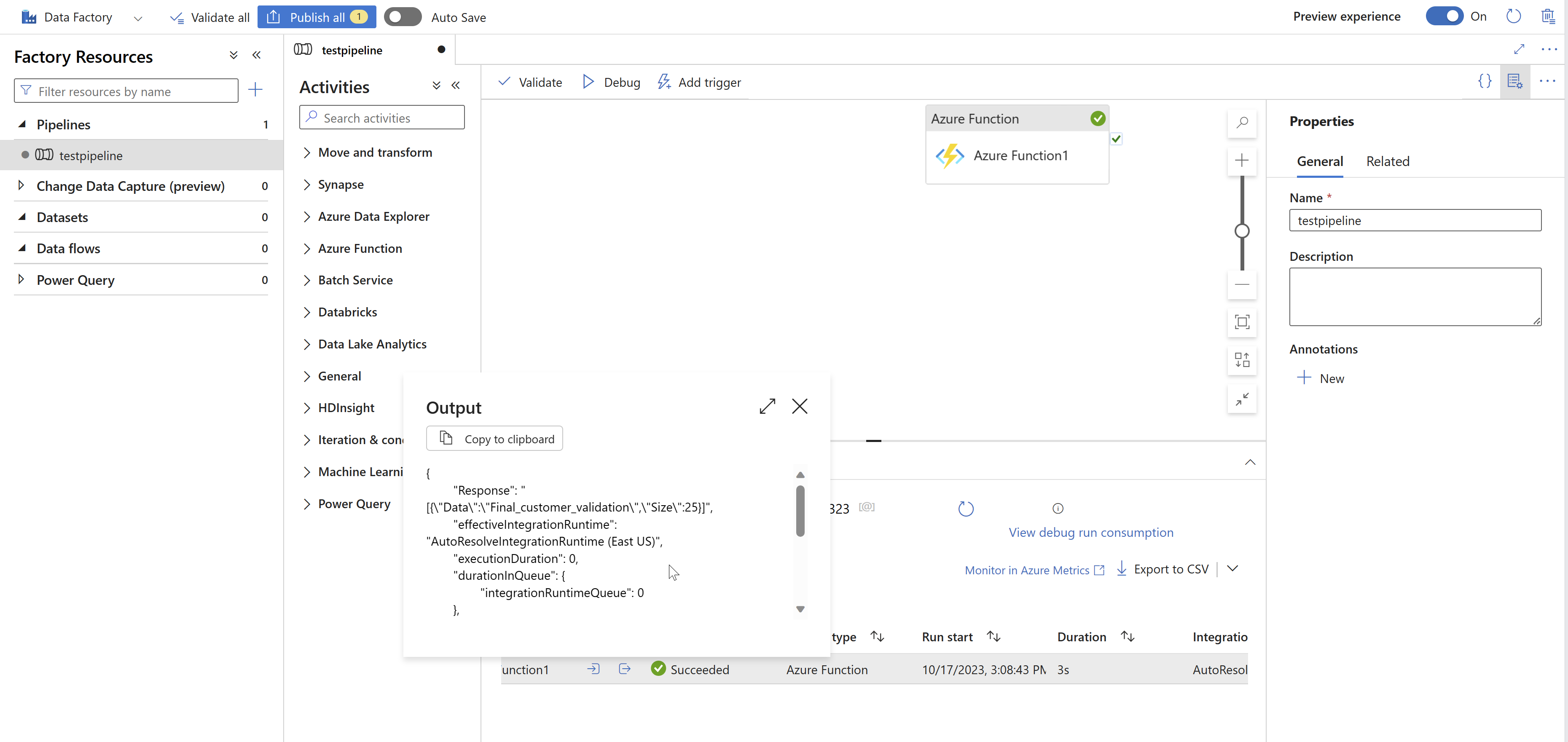

    1. Output from ADF pipeline Azure Function activity:
