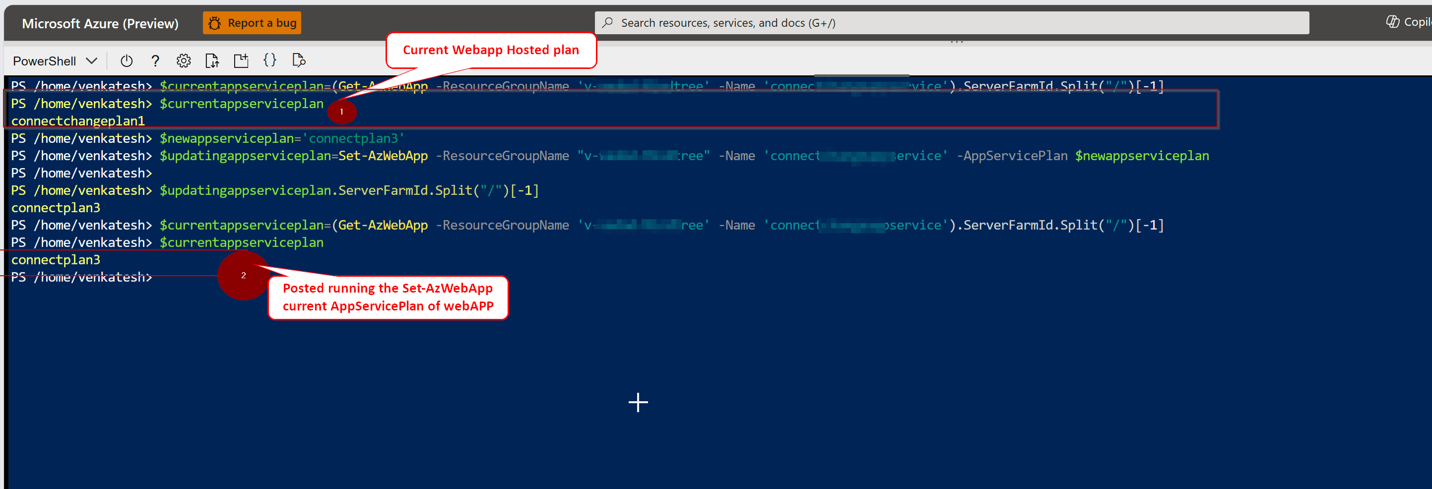

    Here is the Sample output for your reference:
    I have tested this in my environment it is working fine, and I would suggest you validate from your end as well.
