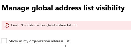

I would like to hide some disable users from address list on Exchange online,but it show error below.
2023-10-12 17_02_37-Message trace - Exchange admin center — Mozilla Firefox

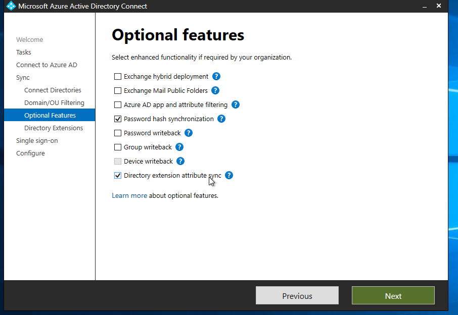

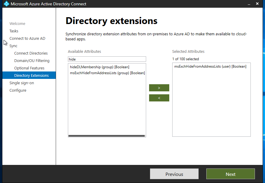

Then I checked the "Directory extension attribute sunc" in Azure connect.

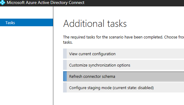

Then refresh connector schema.

    If the objects are synced from AD, you need to make the changes therein. For that, you need to have the on-premises AD schema extended with the Exchange attributes. This is different from configuring Directory extensions in AAD Connect, though judging by the screens above, you should be set on that front.
    The last important bit is that the rule that syncs Exchange-related attributes between on-premises and Azure AD requires that the mailNickname/alias attribute be populated on the object. Without said attribute, the changes will not be synced, so make sure you have a non-null value for it. Refer to the official documentation for more info: https://learn.microsoft.com/en-us/azure/active-directory/hybrid/connect/concept-azure-ad-connect-sync-default-configuration

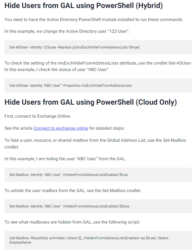

    Hi partner,
    Have you tried the PowerShell command?
    More details: Hide Users From Global Address List (GAL)
    (Please Note: Since the web site is not hosted by Microsoft, the link may change without notice. Microsoft does not guarantee the accuracy of this information.)
