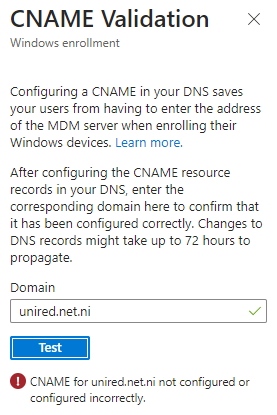

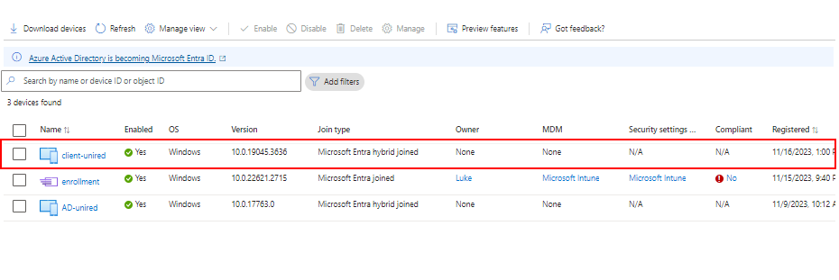

I have configured hybrid ad join in ad connect, but the devices still do not join Intune I have checked the errors on the devices and I have obtained the following:

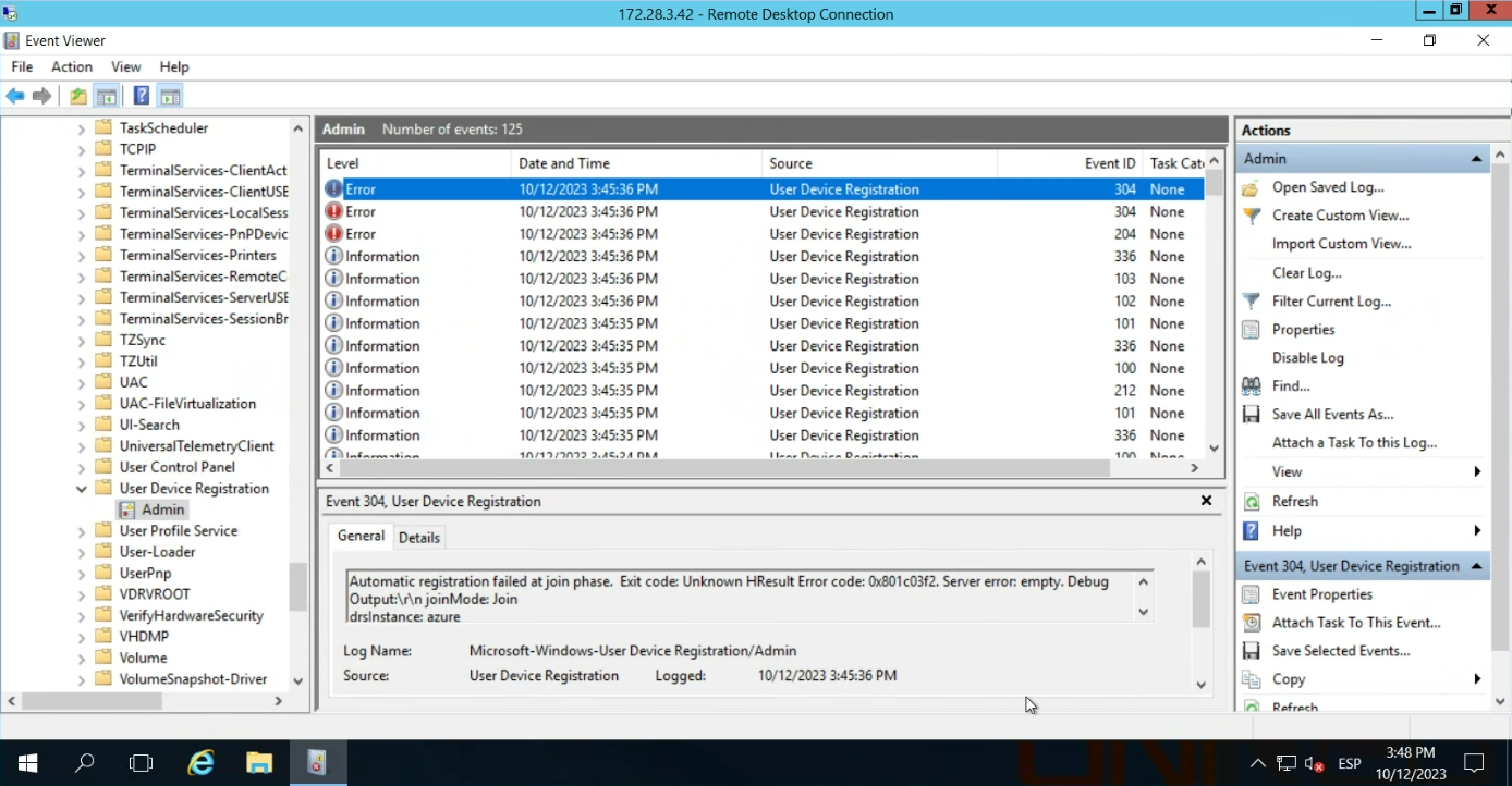

Some errors I have seen in the event viewer:
The get join response operation callback failed with exit code: Unknown HResult Error code: 0x801c03f2.
Activity Id: d8a09df9-ee38-446c-8c49-155cea46bb3d
The server returned HTTP status: 400
Server response was: {"ErrorType":"DirectoryError","Message":"The device object by the given id (1f07a731-bf5e-4802-82c2-9d8e1e5cf6b7) is not found.","TraceId":"d8a09df9-ee38-446c-8c49-155cea46bb3d","Time":"10-10-2023 17:05:45Z"}
Automatic registration failed. Failed to lookup the registration service information from Active Directory. Exit code: Unknown HResult Error code: 0x801c001d. See
http://go.microsoft.com/fwlink/?LinkId=623042
errors I see in the event viewer 307 304 204
