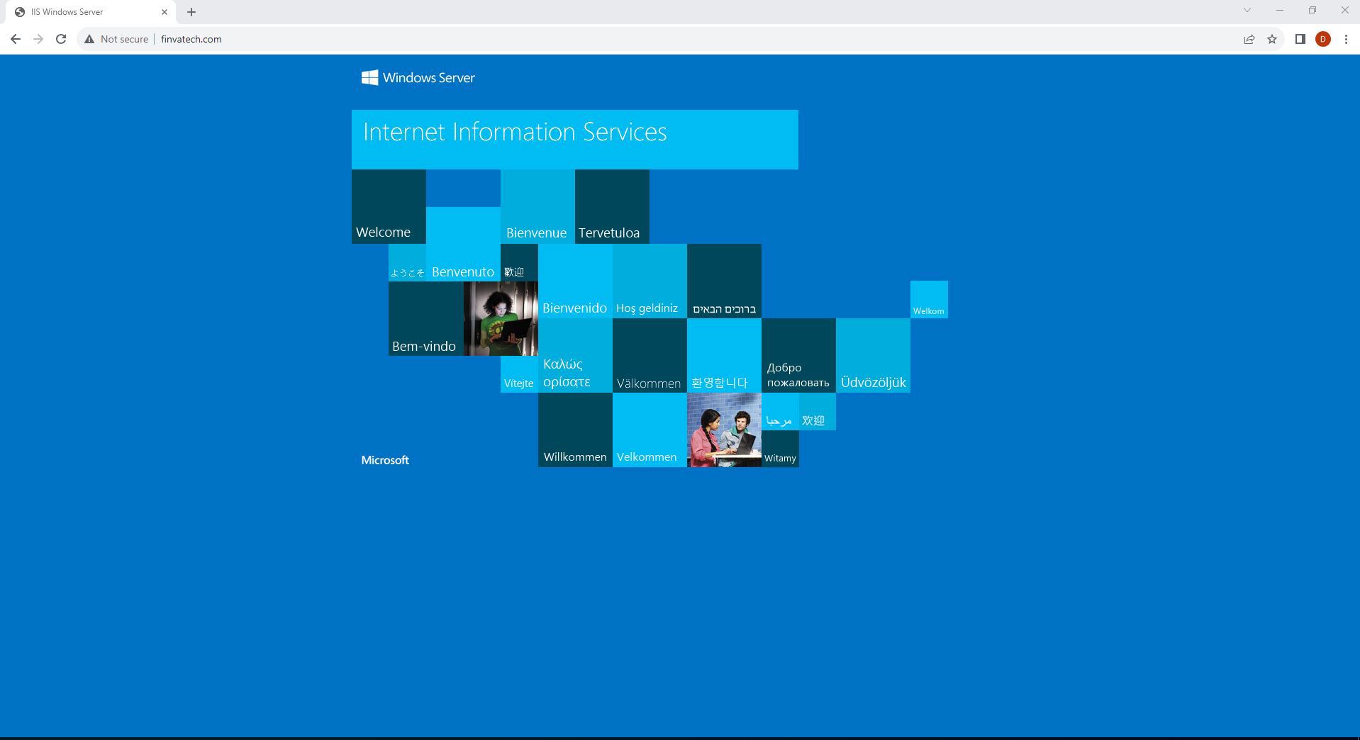

Hello, this is our company website finvatech.com. We are unable to access it inside the Azure VM. I've added 80 and 443 NSG- inbound rule in azure portal. It did not work. Getting the IIS Windows Server message. Please advise!

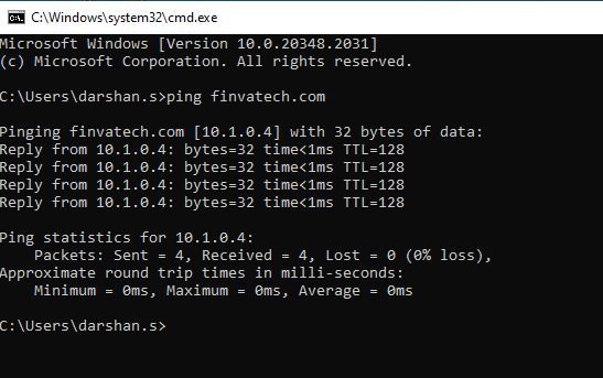

    DNS Resolution:
    • Check if the VM can resolve the domain name. Use commands like nslookup finvatech.com or ping finvatech.com.
    • If the VM can't resolve the domain, ensure that it's using a functional DNS server. By default, Azure VMs use Azure's DNS services, but if you've customized DNS settings, this could be a potential area of concern.
    Host File:
    • For Windows VMs, check C:\Windows\System32\drivers\etc\hosts and for Linux VMs, check /etc/hosts to see if there are any manual entries for finvatech.com that might be causing an issue.

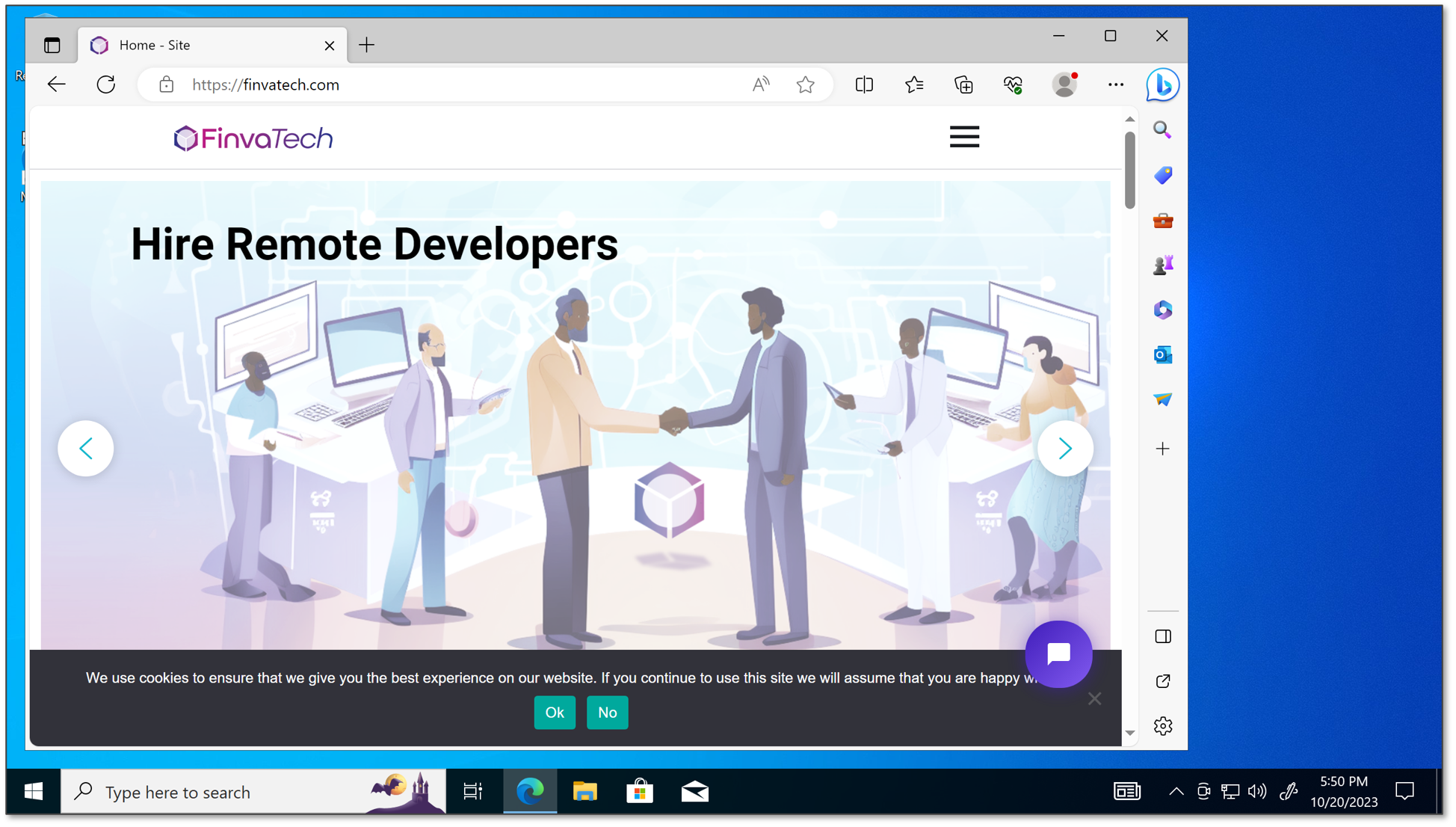

    In this case, I was able to access finvatech.com from my test Windows 10 VM without any issues:
    What's interesting in your screenshot is that it looks like you are reaching the webserver, but the webserver is returning the default IIS Server page and only to this VM.
    Caching might explain this but you mentioned that you tried multiple browsers so a quick Ctrl + F5 might be useful just to make sure we aren't overlooking anything.
    It's possible that there is a configuration issue with the web server that needs to be addressed however the scope of this impact seems to be limited.
    The solution here may be as simple as recreating/redeploying your VM to remove any stale or corrupted configuration values (I used default deployment for my test VM). If you are able to reliably get the default IIS page then you may need to adjust the web server configuration (default document, etc.).

    1. Can you check if you have a DNS record where the domain name finvatech.com points to your VM's private IP ? If not, can you check the hostname file to see if you added this entry ?
    2. Also, I think you should have installed IIS on your local VM from where you are trying to access and it responds with this default IIS page. If you are not using it, you can remove the site.
