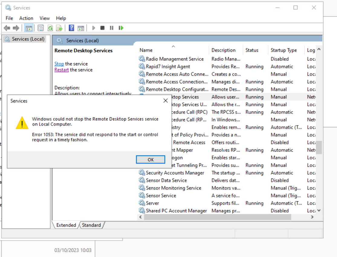

This is taking approx. 20 minutes to complete and we get a following error when service is stopping (screenshot attached) User's image

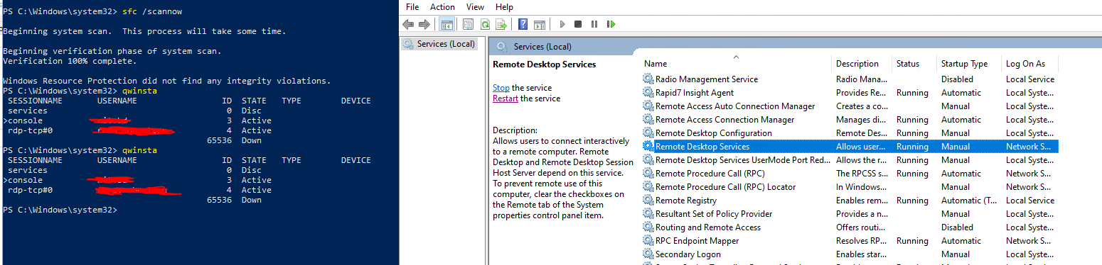

    Nothing in Reliability Monitory either - no crashes, no problems reported.
    I ran sfc /scannow as well - no integrity violations.
    Just found one more symptom when the problem is present - I see session ID 65536 down when the problem is present:

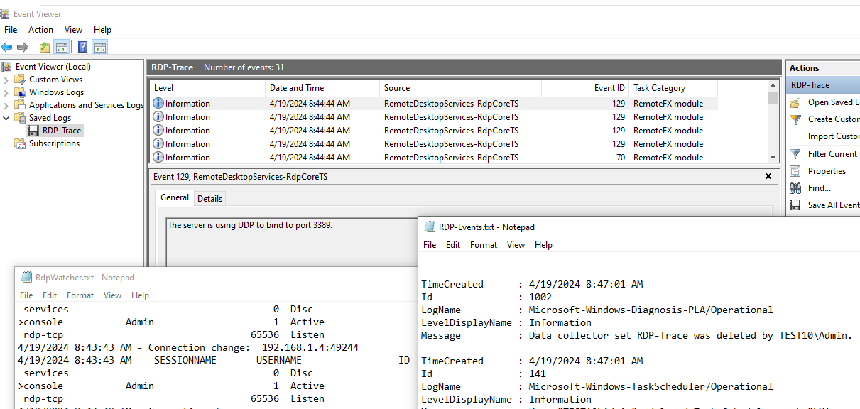

    I had updated my script but didn't post it. Was waiting to see if anyone replied to these questions. Here it is.
    Please understand that what it's trying to do is to just gather any relevant information so that we might know where to look next. You may still need to open a case with MS product support to get an actual fix if the root cause is something within the RDP codebase.
    Run this on a test server that has the problem and see what it captures. Log on to the console of the server and run it from an admin PS prompt.
    The script will produce 2 txt files and an eventlog file. The one txt file is the log that the script produces. The other txt file is a summary of all events that were written to all event logs in the 10 minutes prior to the crash.
    Find the time of day when the listener goes away. Look to see if some IP tried to connect at that time. Look to see what other events occurred around that time.
    I tested this on Win10 Pro and manually stopped the TS services to simulate an error.
