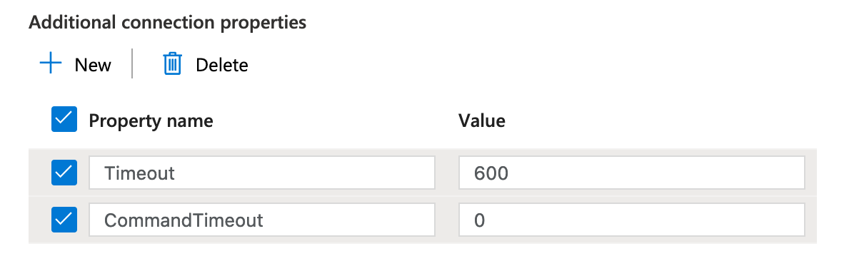

    Another possible reason could be timeout. There is a default timeout of 30s for requests with a postgres connection. The only option that does something is to add Timeout=600;CommandTimeout=0; to your connection string in your linked service (if you use a key vault for exemple) or add the options in the linked service additionnal parameters as shown below:
