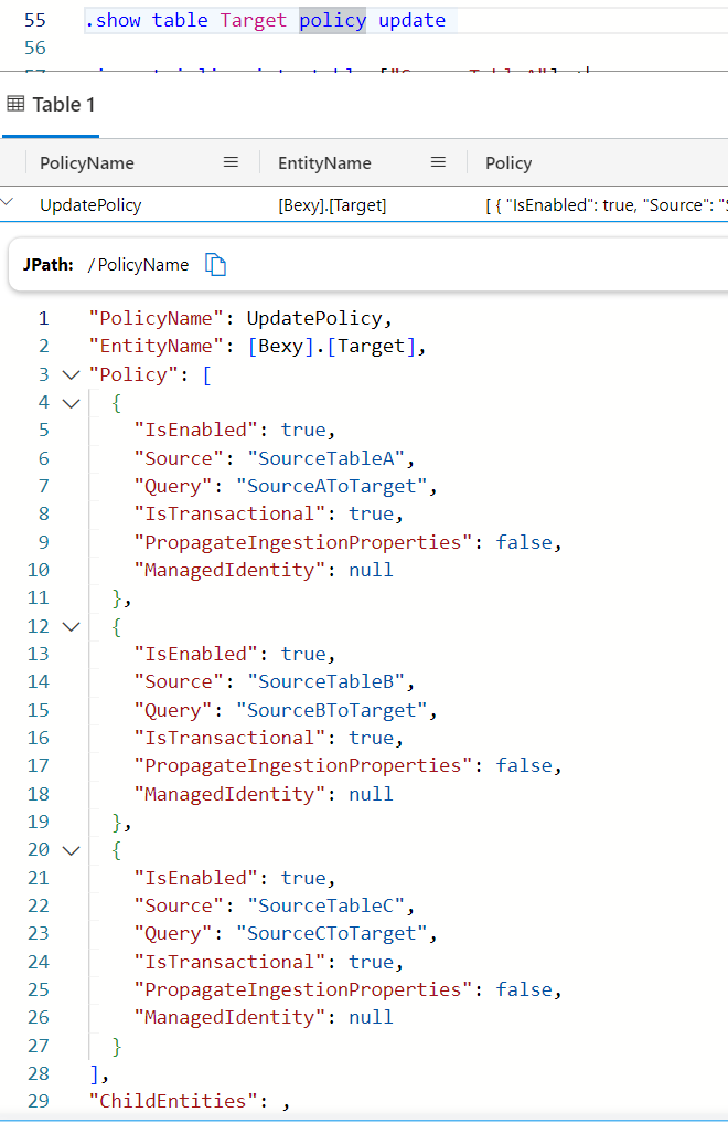

    .alter table Target policy update  @'[{"Source": "SourceTableA", "Query": "SourceAToTarget", "IsEnabled" : true, "IsTransactional": true },{"Source": "SourceTableB", "Query": "SourceBToTarget", "IsEnabled" : true, "IsTransactional": true },{"Source": "SourceTableC", "Query": "SourceCToTarget", "IsEnabled" : true, "IsTransactional": true }]'
    .show table Target policy update

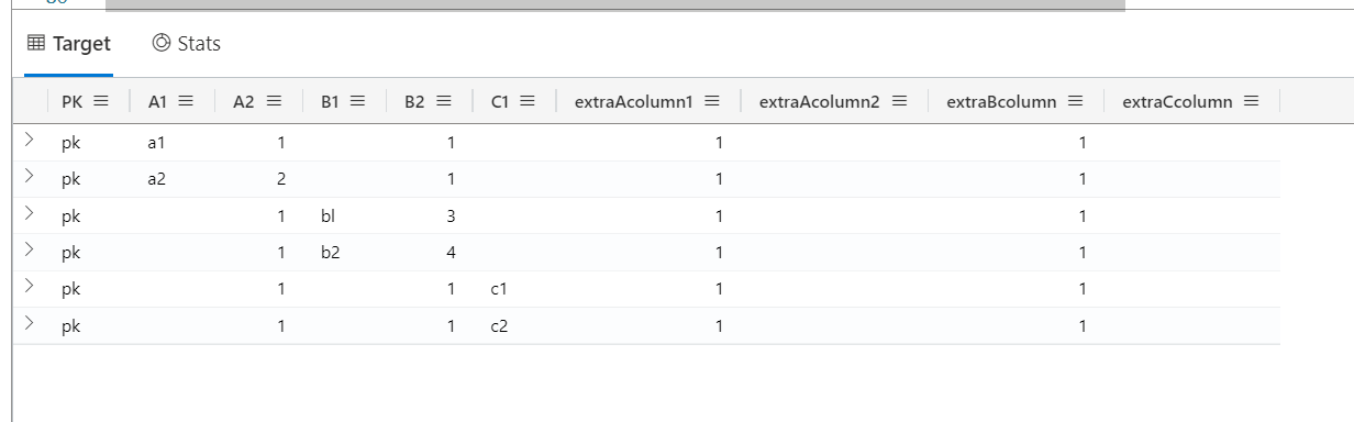

    .ingest inline into table ["SourceTableA"] <|
    "pk1a","a1",1
    "pk2a","a2",2
    SourceTableA
    Target
    .ingest inline into table ["SourceTableB"] <|
    "pk1b","bl",3
    "pk2b","b2",4
    SourceTableB
    Target
    .ingest inline into table ["SourceTableC"] <|
    "pk1c","c1"
    "pk2c","c2"
    SourceTableC
    Target
    First, check out '.alter table Target policy update', it expects an array of policies:
    Finally, the order and type of the columns outputted by the queries are specific:
    Now you know how to combine multiple update policies.
