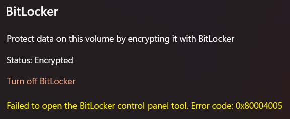

I am currently trying to update my BIOS to fix an issue with intel extreme tuning, to be able to have profiles reloaded on reboot. I have a secondary drive that is encrypted by bitlocker, I can enter the password and access etc. When attempting to update my BIOS on an ASUS Z790-A Prime Wifi it states that I should suspend bitlocker or risk losing that data on that drive.
However, when looking in control panel it is not there. Attempting to open it in the new windows settings I get an error stating "Failed to open the bitlocker control panel tool. Error code 0x80004005." I partially know why as system information states this for Device Encryption Support "Device Encryption Support: Reasons for failed automatic device encryption: PCR7 binding is not supported, Hardware Security Test Interface failed and device is not Modern Standby, Un-allowed DMA capable bus/device(s) detected, WinRE is not configured".

So what gives? I cannot do a BIOS update because I cannot decrypt my secondary bitlocker drive because it isn't present in the settings even though all the supposed features that are needed for it to be are on and enabled. I have windows 11 and and intel i7-13700k.
