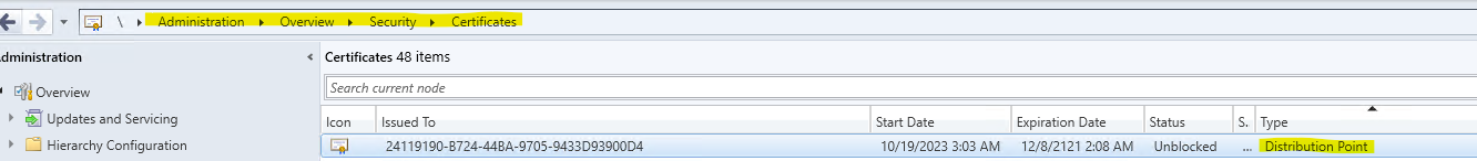

    3. After renewing the certificate, you should monitor the Distmgr.log and Smsdpprov.log files to understand if the renewal was successful. We can also check the new certificate in SCCM console like below:
