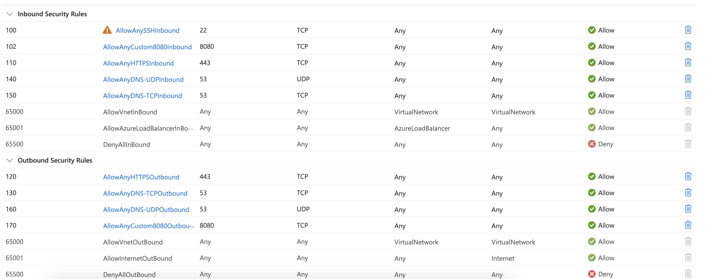

I assumed this was a NSG issue, and tried to open every possible port and connection to the machine:
Screenshot 2023-10-18 at 19.55.26
This lead to the same results.

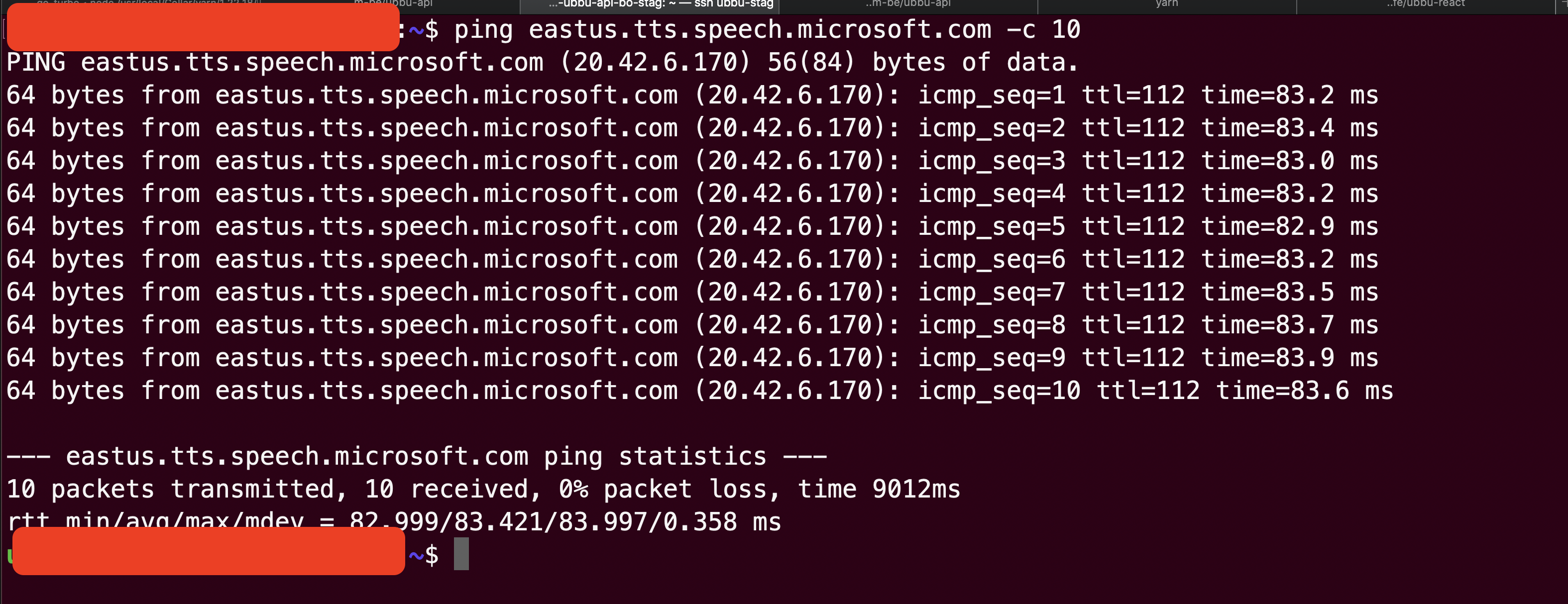

This the result of pinging this domain:
Screenshot 2023-10-18 at 20.01.56

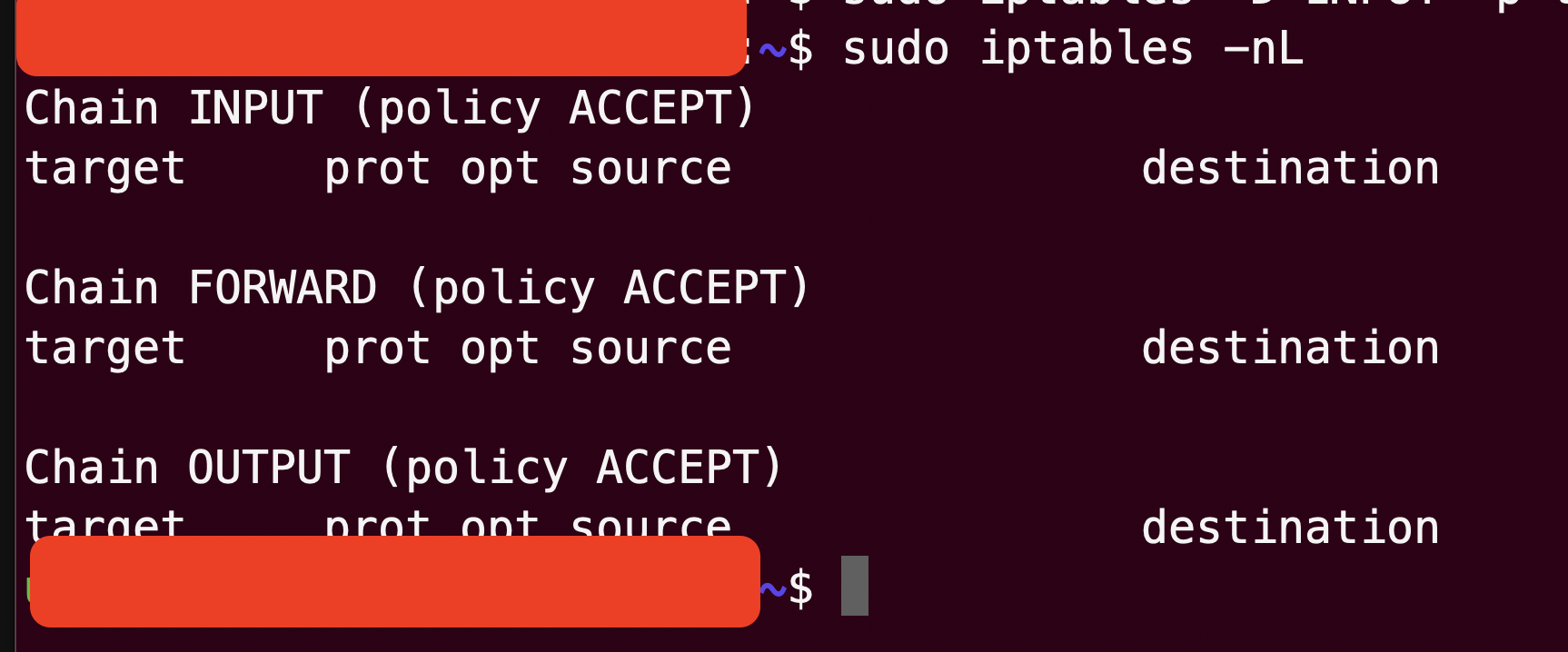

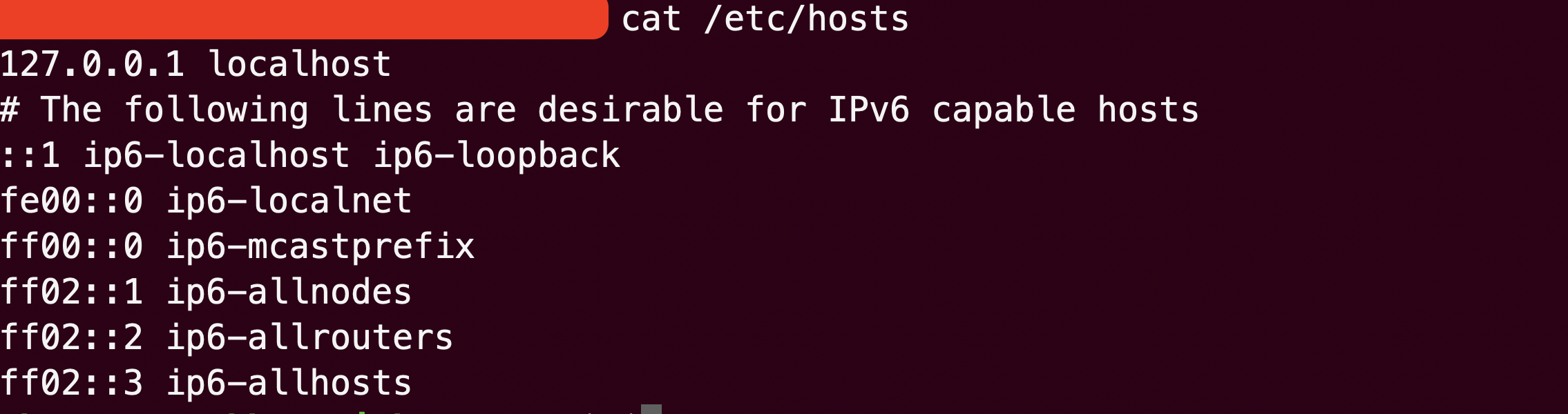

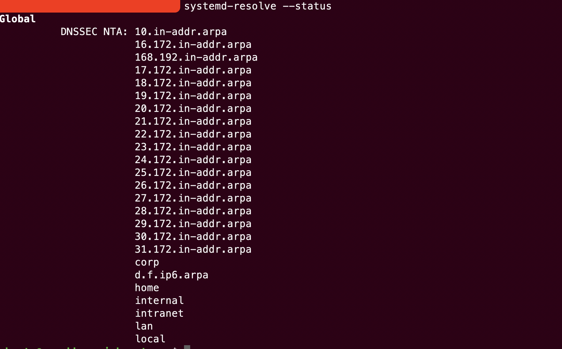

Below are prints from commands that might be informative for this question:
Screenshot 2023-10-18 at 20.03.43
-------------------------------------------------------------------------------------------Screenshot 2023-10-18 at 20.04.57
-------------------------------------------------------------------------------------------Screenshot 2023-10-18 at 20.06.37
-------------------------------------------------------------------------------------------Screenshot 2023-10-18 at 20.10.08
-------------------------------------------------------------------------------------------Screenshot 2023-10-18 at 20.11.41
I'd really appreciate any ideas for this situation. I have already contacted microsoft's support team, but so far they've only told me that the nsg must be configured incorrectly, specifically when it comes to the traffic on port 443.

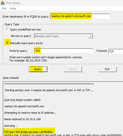

    Plan 2:
    You can download the port query UI tool and extract its contents. Then launch the portqueryui.exe fill the required details as shown below and click on Query button. You should see an output saying Listening if ports are open.

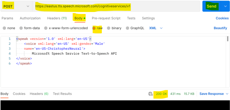

    Plan 3:
    Please check if you get http status code 200 from the postman.

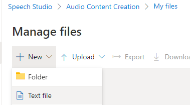

    Plan 4:***

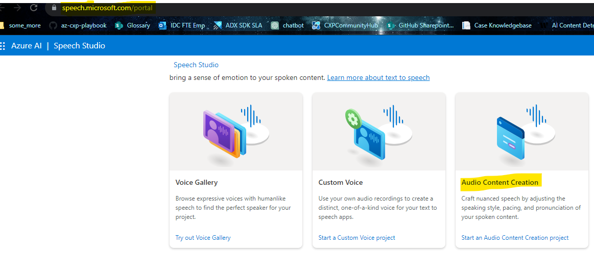

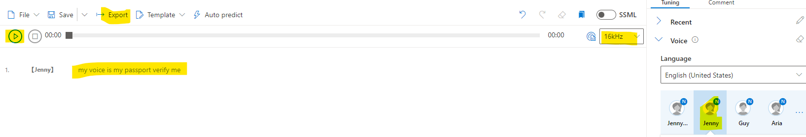

    RDP to your Azure VM and open the Azure Speech Studio and then click on Audio Content Creation to leverage the text to speech feature and see if that works fine.
    Select Text File:
    Then select the voice, quality and click on play button and then you can export you audio as shown below:

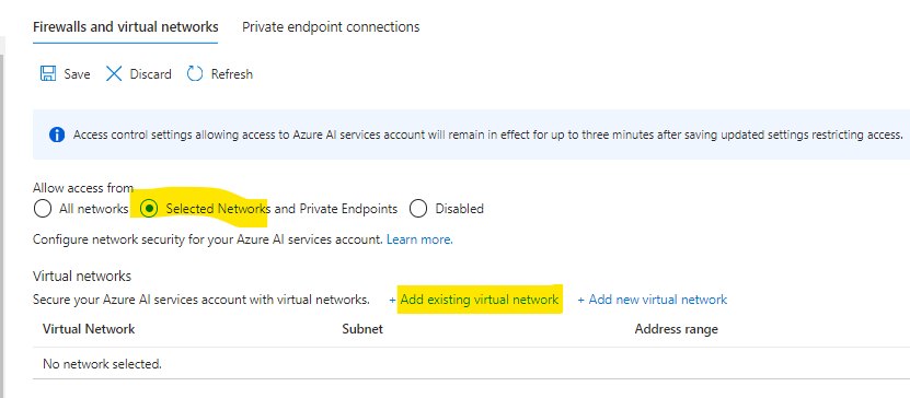

    Plan 5:

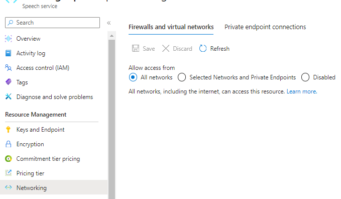

    Please open the Networking blade of your Speech service: User's image **
    You can try adding your existing Vnet and check if that helps:
    You can also try to Enable a service endpoint for Azure AI services within the virtual network. The service endpoint routes traffic from the virtual network through an optimal path to the Azure AI services service. For more information, see Virtual Network service endpoints.
    More Info about Azure AI Service Networking option is explained here.

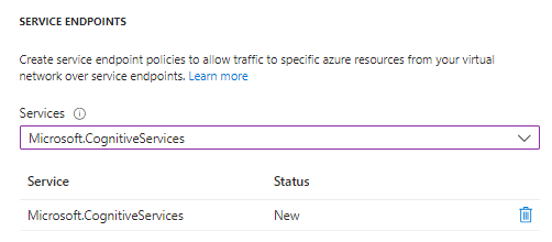

  1. Gianluca Perrone 25 Reputation points
    2023-10-23T09:07:55.61+00:00
    The support teams answer was good, but what ended up fixing the issue was disabling the service endpoints I already had in my Virtual network. Hope that helps anyone.
