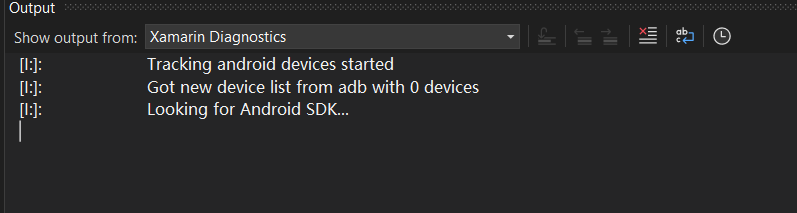

Did you enable the Xamarin Diagnostics output verbosity?
In Tools -> Options -> Xamarin -> Android Settings the "Xamarin Diagnostics output verbosity"
Calloway He • 0 Reputation points
2023-10-20T09:40:16.11+00:00 @Anonymous Thanks very much for your help, I click "Open Logs", it really opens a folder and I can see the log (I paste all logs below), I find there are 2 errors in these logs and the error related to publishing to Google Play Console should on line:284, but I don't know how to solve it and I confirm my VS2022 is up-to-date. In addition, the setting "Xamarin Diagnostics output verbosity" was originally Normal, I set it as Detailed or Diagnostics and did same steps, finally I still cannot see more information in Output window.

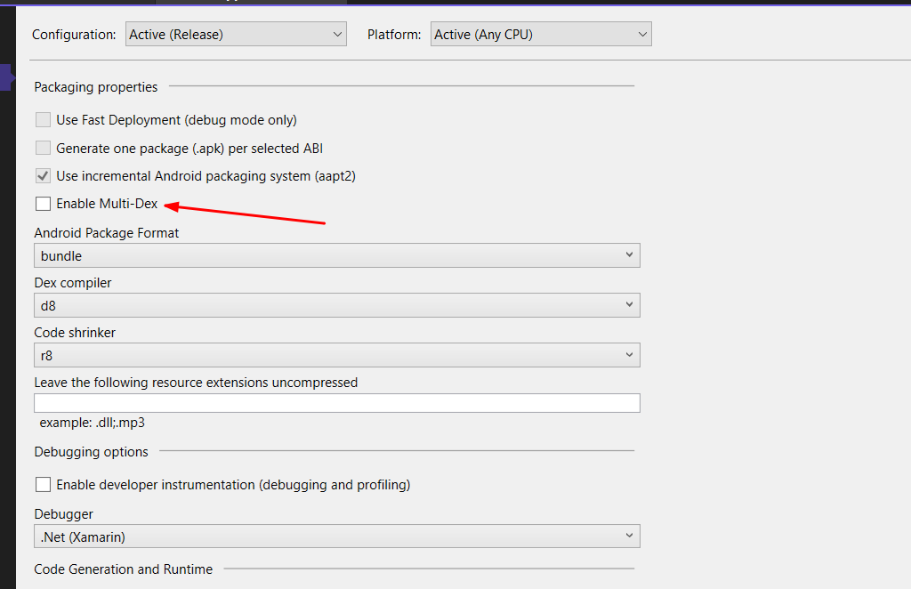

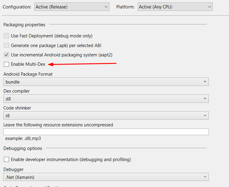

2023-10-23T07:57:16.1566667+00:00 Can you share your csproj file? Did you enable multi-dex? If yes, please disable it and release it again.

2023-10-24T02:38:47.8833333+00:00 @Anonymous The following is the csproj file, I changed its extension as xml because the comment showed the 'csproj' extension is invalid and it cannot be attached. I also confirmed I didn't enable multi-dex.
2023-10-24T02:42:20.6433333+00:00 @Anonymous The following is the csproj file, I changed its extension as xml because it showed 'csproj' is invalid extension when I attached it to this comment. I also confirmed I didn't enable multi-dex.
2023-10-24T02:57:34.78+00:00 @Anonymous Sorry, I mistakenly thought that the first comment was not sent successfully because it was not displayed when I refreshed the page, so I sent the second comment. The content of both comments is the same.
