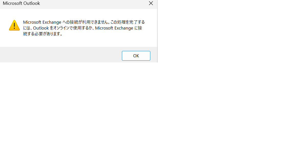

ExchangeServer 2019, AD server was built separately and Office 365 was installed on PC terminals.
I was able to create a mailbox and start Outlook safely,
The Global Address List is not displayed from the Address Book. (No problem in the environment verified in advance * AD and ExchangeServer live together)

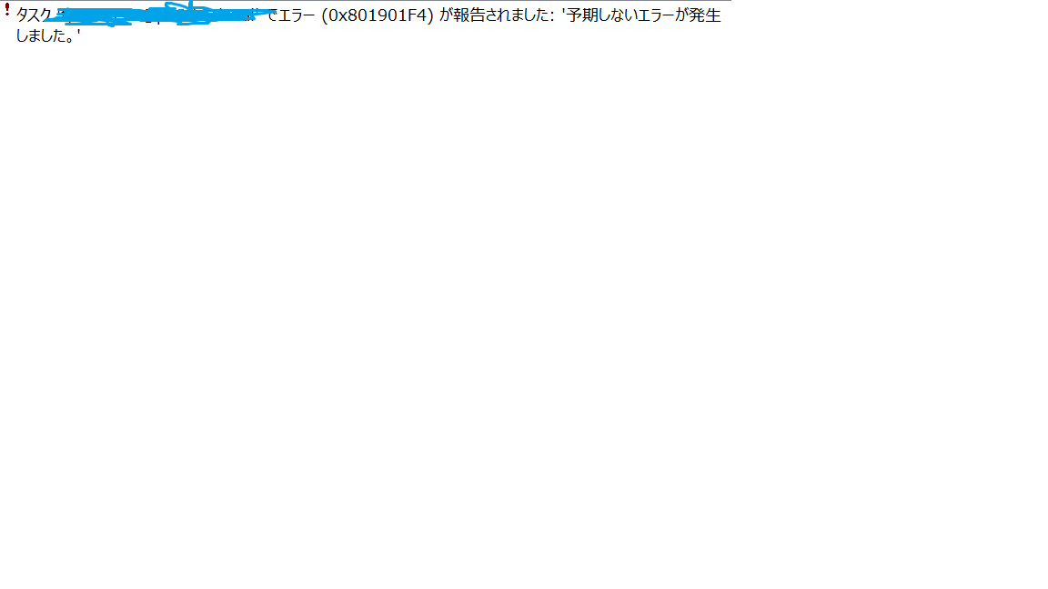

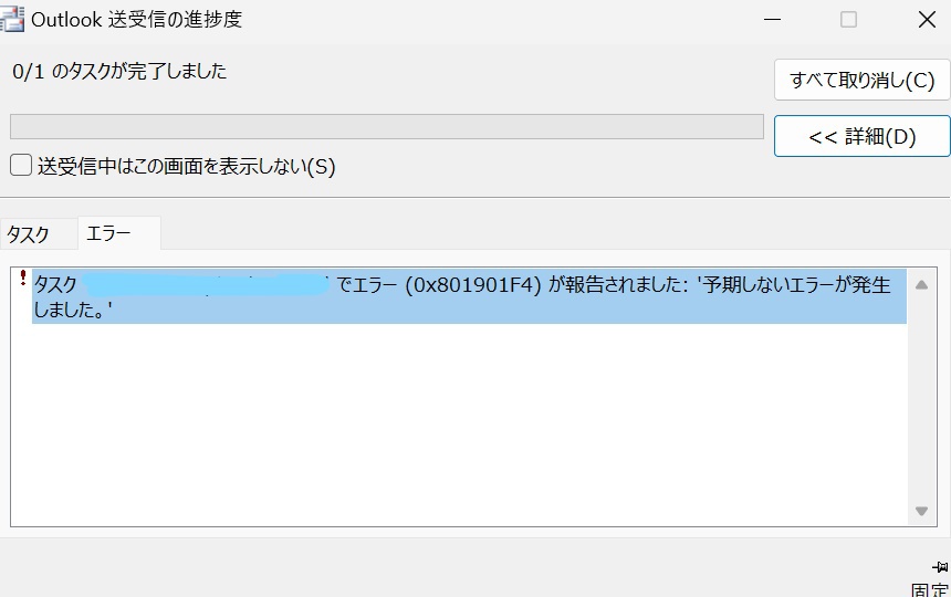

When I try to download the address book, an error (0x801901F4) is displayed and I cannot download it.

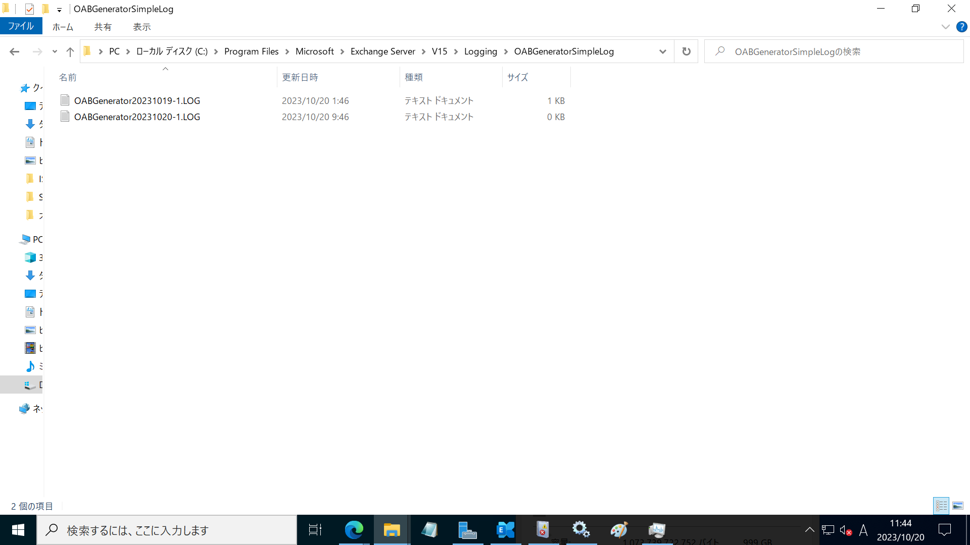

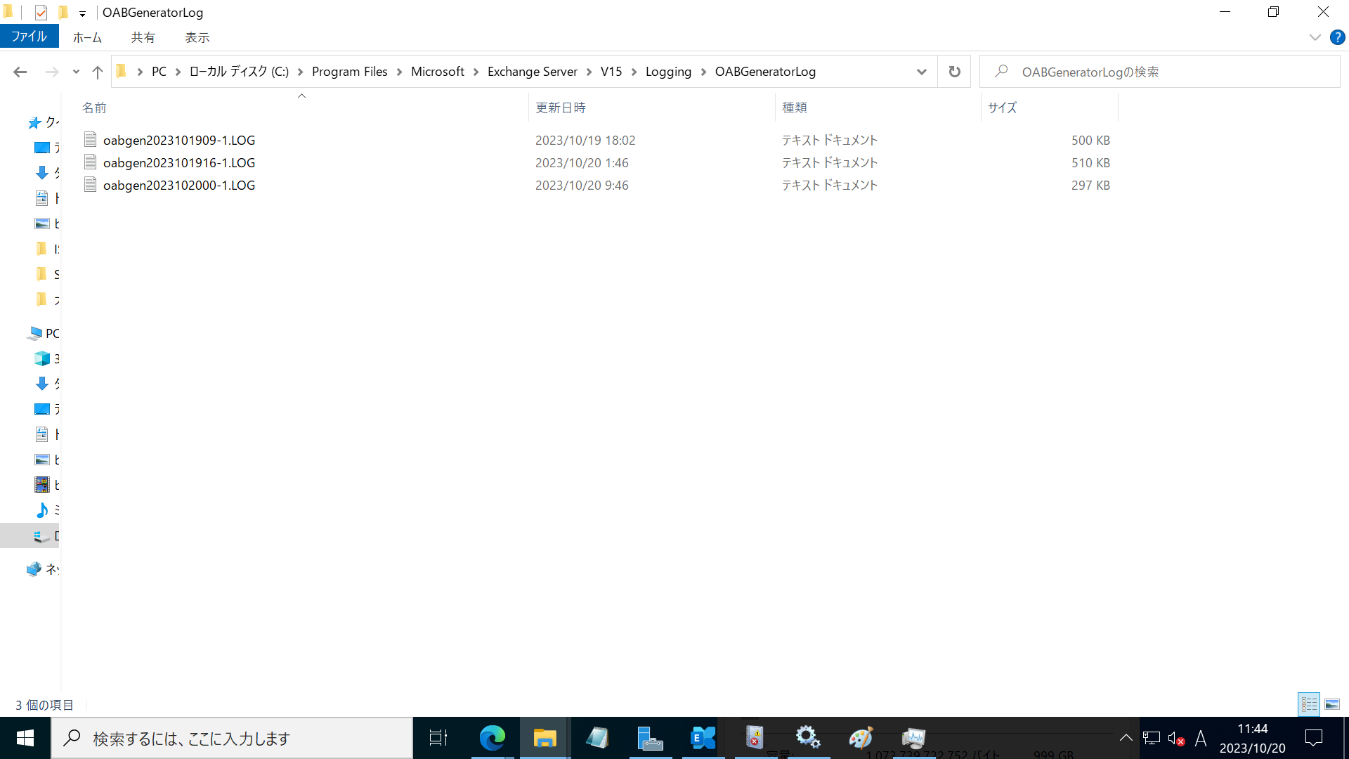

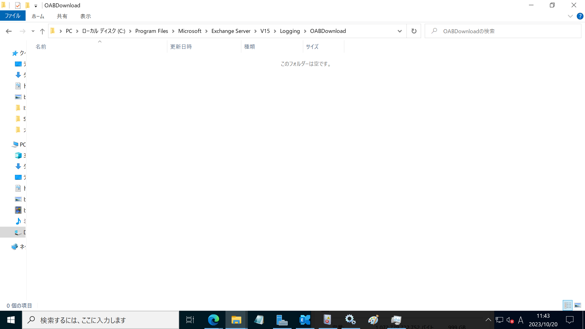

I checked the following folder in ExchangeServer, but there was no log.

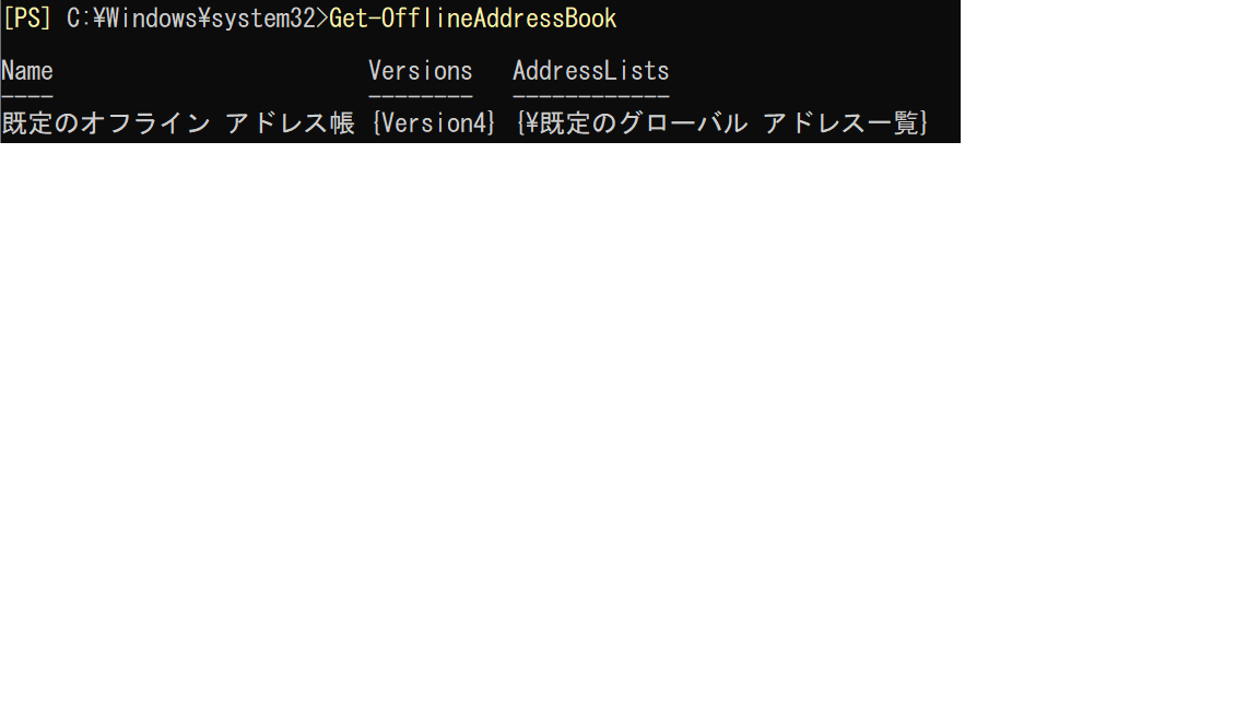

Get-OfflineAddressBook
エラー
エラーコード
C:Program Files¥Microsoft¥Exchange Server¥V15¥Logging¥OABDownload
In addition, the OABGeneratorLog and OABGeneratorlogSimpleLog folders were not configured.
Should I change the settings somewhere?

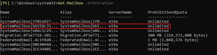

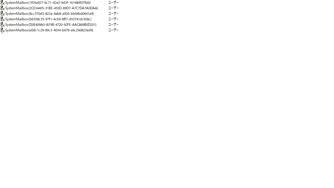

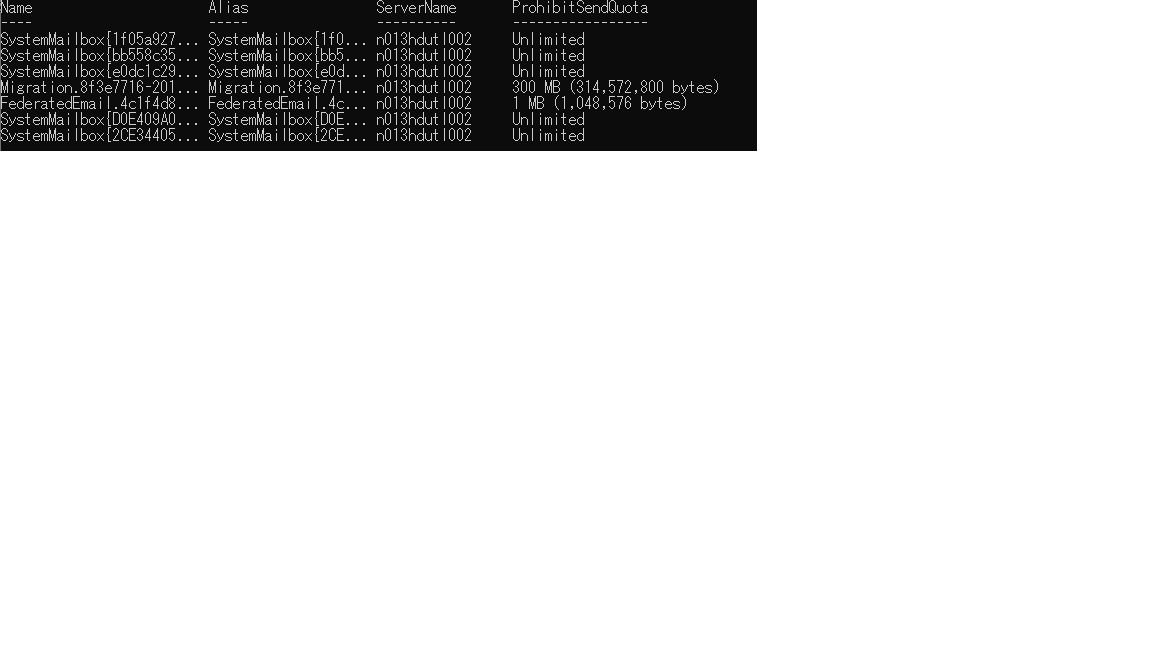

    Please run the following cmdlet in Exchange Management Shell on Exchange server to have a check if the system mailbox responsible for OAB generation is present or missing in the environment:
    Get-Mailbox -Arbitration
    Example:
    01
    This mailbox SystemMailbox{bb558c35-97f1-4cb9-8ff7-d53741dc928c} is responsible for generating OABs.
    If this mailbox is missing, please follow the steps in this link to recreate it:
    Re-create the Microsoft Exchange organization mailbox for OABs

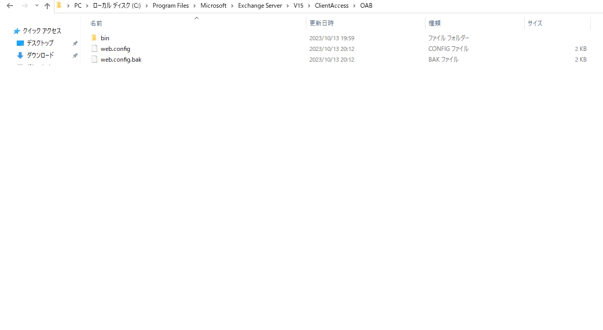

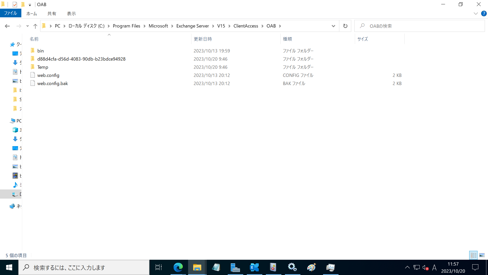

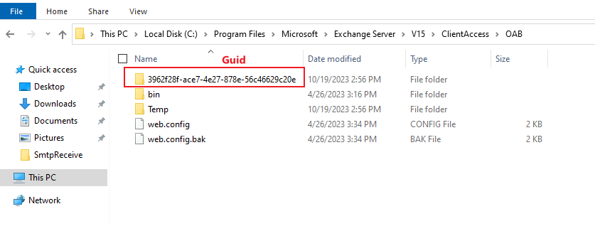

    If you can see this mailbox, please have a check of this path on Exchange server to see if you can see a folder named with guid:
    %ExchangeInstallPath%ClientAccess\OAB (C:\Program Files\Microsoft\Exchange Server\V15\ClientAccess\OAB)
    Example:
    02

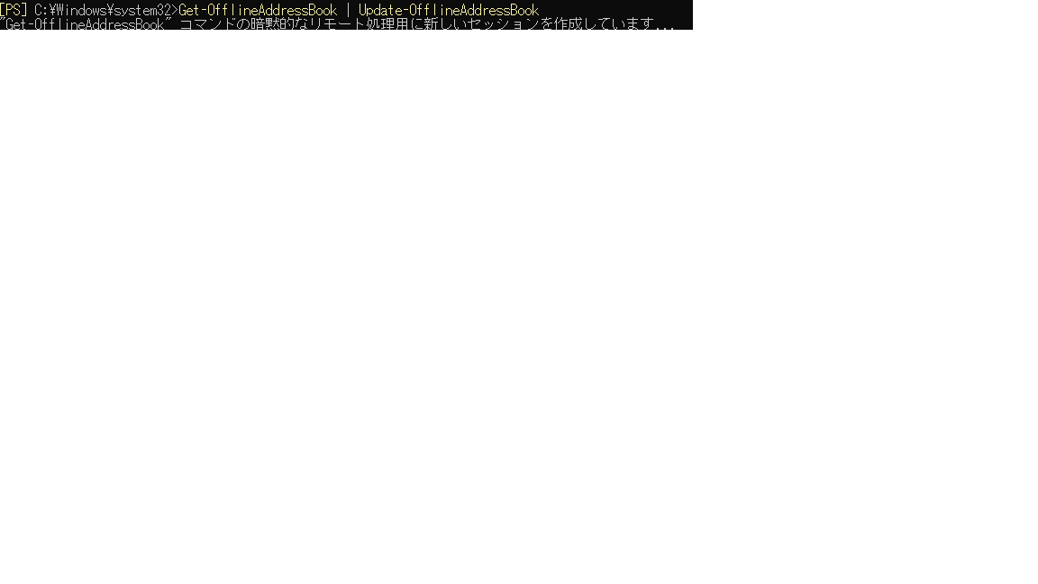

    If there isn't such folder or the Date modified time is long time ago, please run the following cmdlet in Exchange Management Shell:
    Get-OfflineAddressBook | Update-OfflineAddressBook
    Then have a check if the folder is created or updated.

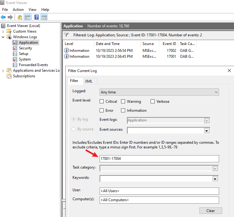

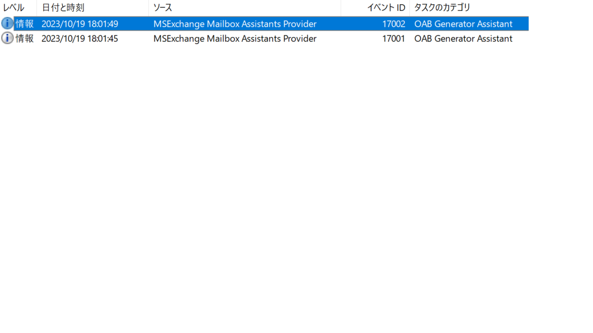

    Meanwhile, check the application log in event viewer on the Exchange server for Event ID 17001-17004.
    03
    If you can see the folder and Event 17001 and 17002 on Exchange, please retry downloading the folder in Outlook.

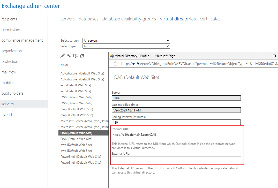

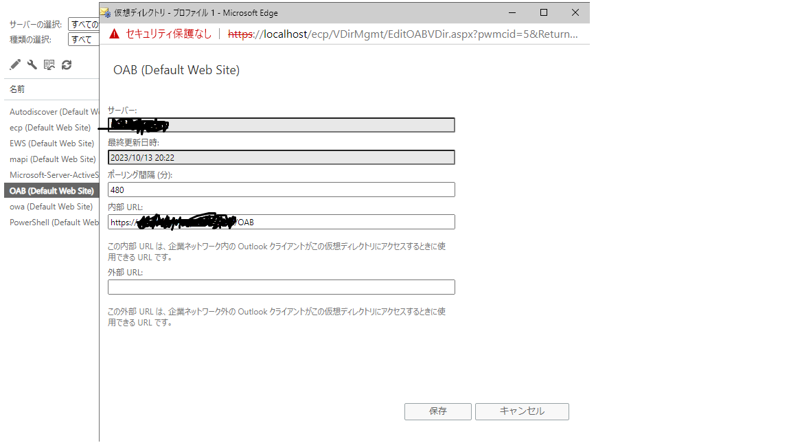

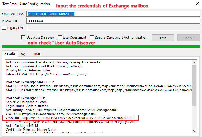

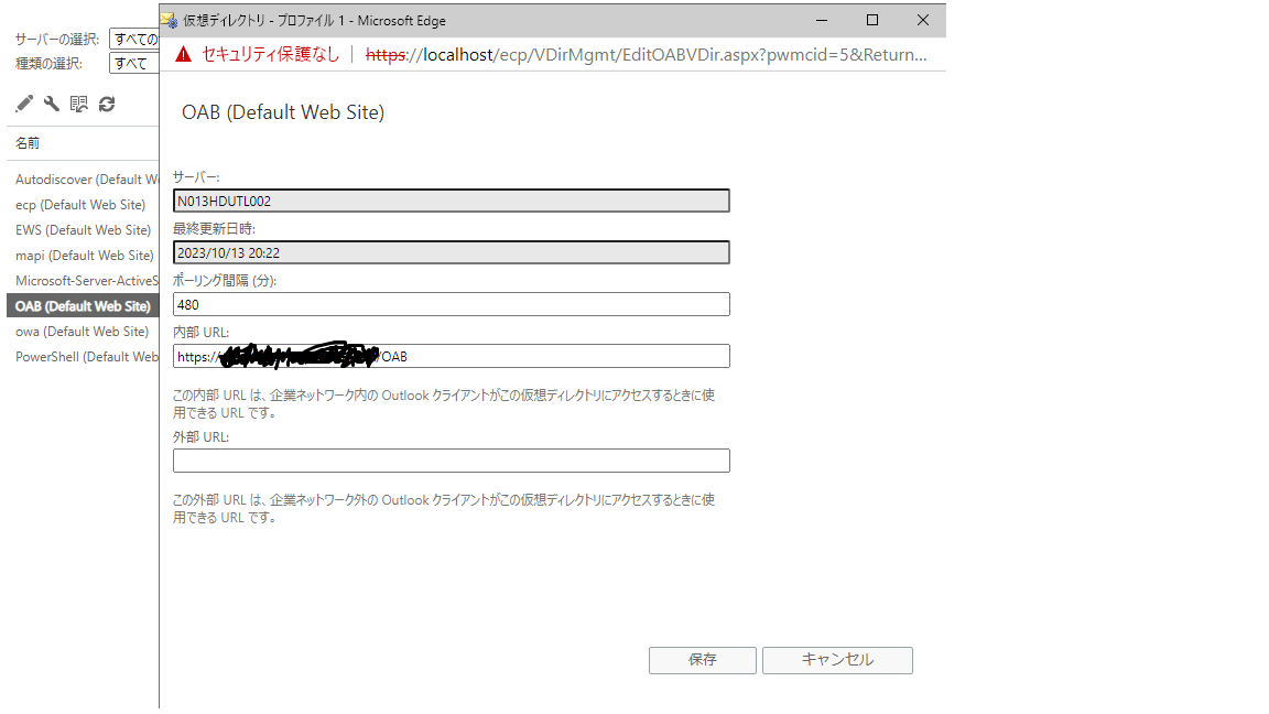

    If the issue persists, please check the url of the OAB virtual directory on Exchange server.
    Example (in Exchange Admin Center>servers>virtual directories):
    04
    Make sure these urls are in the format of https://<server name>/OAB and accessible by Outlook client.
