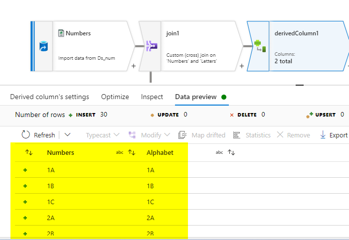

    • You can use **Custom (cross) **join type in the Join to get the result in this case.

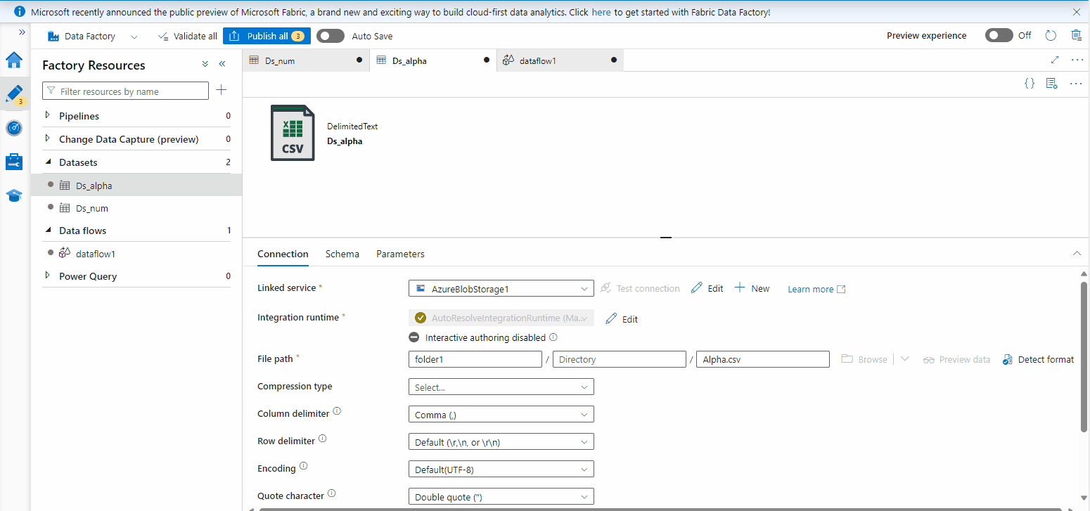

      I have created sample Large Dataset(Numbers) with numbers up to 10 and Small Dataset(Letters) with A,B,C.
    • Now, use Join with Large dataset as left and small dataset as right and use custom join with the condition as true().
    • In the Optimize of Join, select off at the Broadcast to get the above format of the data. You can see the merge of two datasets below.
    • If you would like to have the result in a single column with values like 1A, 1B, 1C, and so on, you can achieve this by first using a derived column to concatenate using concat(toString(Numbers), Alphabet) for the values mentioned above, and then select the desired column. User's image
    • Now, use the select operation to choose any column. However, in the GIF below, I am demonstrating the entire process to show you how we can achieve your requirement.
    merge12
