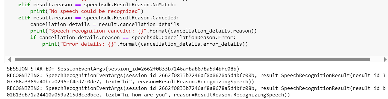

    I understand that you are adjusted the Speech_SegmentationSilenceTimeoutMs parameter to 3500ms and noticed an error: "ServiceTimeout, Due to service inactivity the client buffer size exceeded", when a long speech is done.
    I ran the below code in my local Jupyter Notebook without any buffer error. The below code uses 3500ms for Speech_SegmentationSilenceTimeoutMs

    Please have a look at the sample implementation done in the above "comment".
