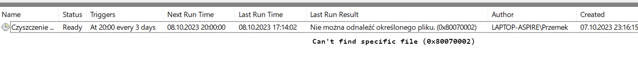

Hi. My Task Scheduler isn't working. I've prepared a file to print every 3 days so that my printer nozzles don't go clogged because I'm tired of cleaning them. Calling the command mspaint /p C:...\czyszczenie_glowicy.png from the PowerShell console triggers printing normally. In the scheduler, unfortunately, it does not work, neither scheduled to execute automatically nor called manually.
I tried moving the czyszczenie_glowicy.png file to different folders starting from the parent directory, with no success - the file still cannot be found:
blad

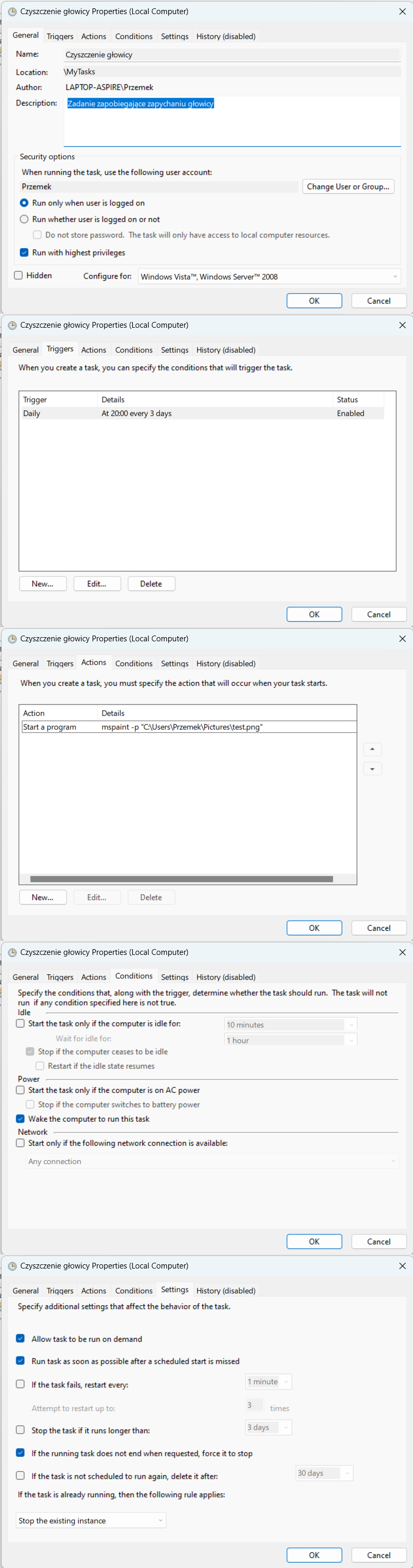

I don't have any idea about this problem anymore. I would appreciate some suggestions. This is how the task is configured:
kurde_nie_dziala

  1. MotoX80 36,401 Reputation points
    2023-10-20T14:14:07.2333333+00:00
    Looks like you will need to specify the full path to the executable. I found it in the WindowsApps folder under my user account.
    c:\>dir mspaint.exe /b /s
    c:\Users\motox80\AppData\Local\Microsoft\WindowsApps\mspaint.exe
