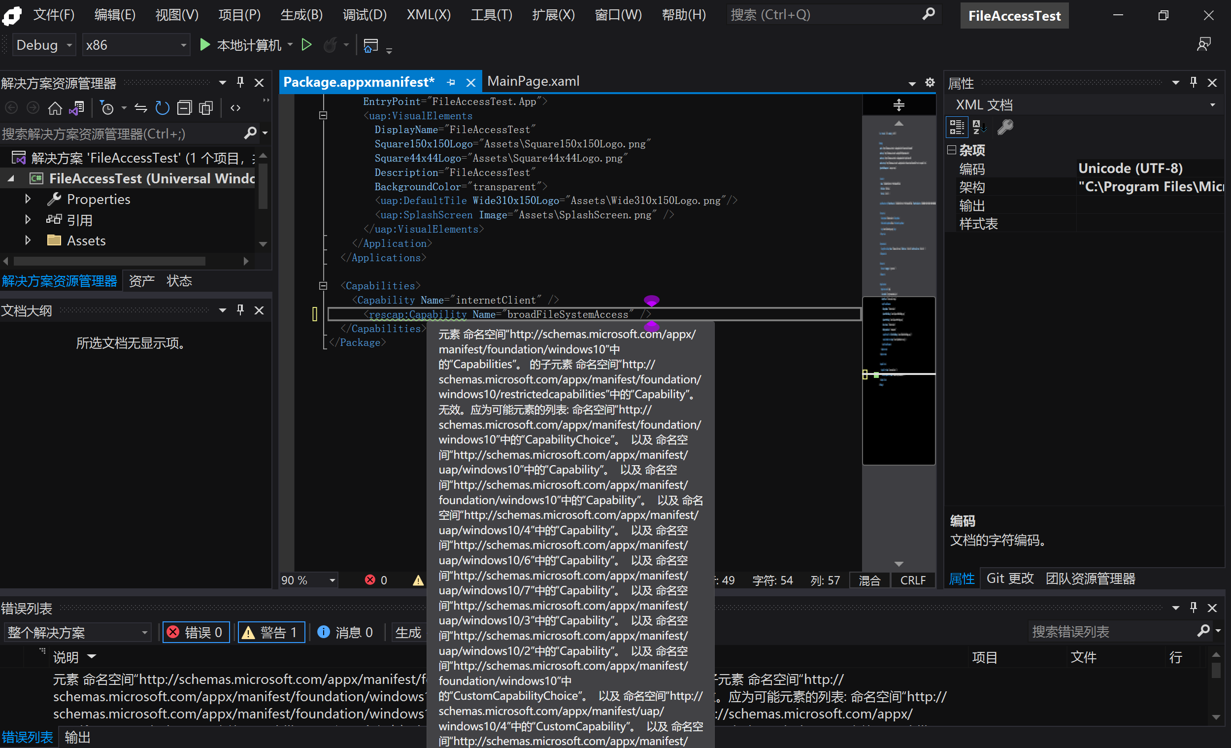

Here is my code:
<?xml version="1.0" encoding="utf-8"?>
<Package
  xmlns="http://schemas.microsoft.com/appx/manifest/foundation/windows10"
  xmlns:mp="http://schemas.microsoft.com/appx/2014/phone/manifest"
  xmlns:uap="http://schemas.microsoft.com/appx/manifest/uap/windows10"
  xmlns:rescap="http://schemas.microsoft.com/appx/manifest/foundation/windows10/restrictedcapabilities"
  IgnorableNamespaces="uap mp rescap">
  <Capabilities>
    <Capability Name="internetClient" />
	  <Capability Name="broadFileSystemAccess"/>
  </Capabilities>
</Package>

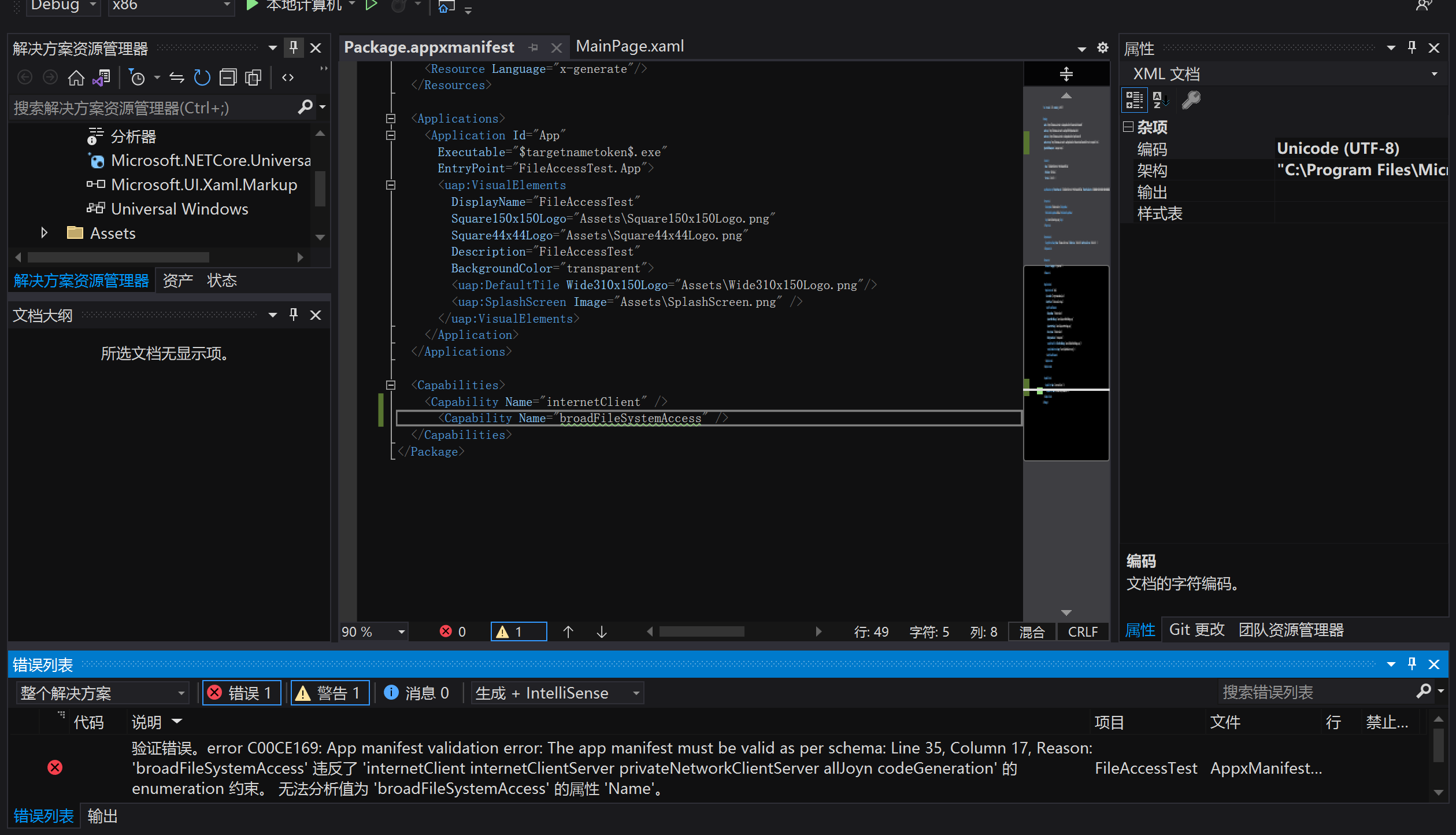

No matter how I modify the line <Capability Name="broadFileSystemAccess"/>,
no matter if it's<Capability Name="broadFileSystemAccess"/> or <rescap:Capability Name="broadFileSystemAccess"/>, there still's an error:
error C00CE169: App manifest validation error: The app manifest must be valid as per schema: Line 35, Column 17, Reason: 'broadFileSystemAccess' 违反了 'internetClient internetClientServer privateNetworkClientServer allJoyn codeGeneration' 的 enumeration 约束。 无法分析值为 'broadFileSystemAccess' 的属性 'Name'。	UWPcmdTest1	F:\UWPcmdTest1\bin\x86\Debug\AppxManifest.xml
This is really upsetting... I liked UWP.

    <Package
    <Capabilities>
        <rescap:Capability Name="broadFileSystemAccess" />
    </Capabilities>
    I can reproduce the same behavior when I use <Capability Name="broadFileSystemAccess"/>. If I use <rescap:Capability Name="broadFileSystemAccess"/> as in the official documentation, and then 'Rebuild All', there is no error.
    If the problem still doesn't resolve after following the code in the document, please share the complete Package.appxmanifest.
