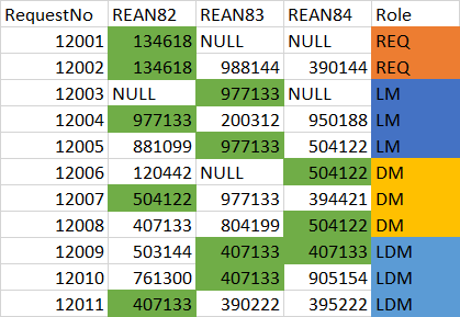

desired result is return only role REQ OR LM OR DM OR LDM based on employee no as image below :
what i try but get wrong result as below
correct must be LDM
BECAUSE employee no 407133 exist on two columns rean83 and rean84

    However, just like your query, it returns REQ for 407133 and LM. This is because on the first row that 407133 appears on is Request No 12008, and on this row 407133 is in column REAN82 and whence you get REQ. I can guess from your colouring that there may be additional business rules that rules out this row as a match for 407133, but since I don't know those business rules, I can't do better than this for the moment.
