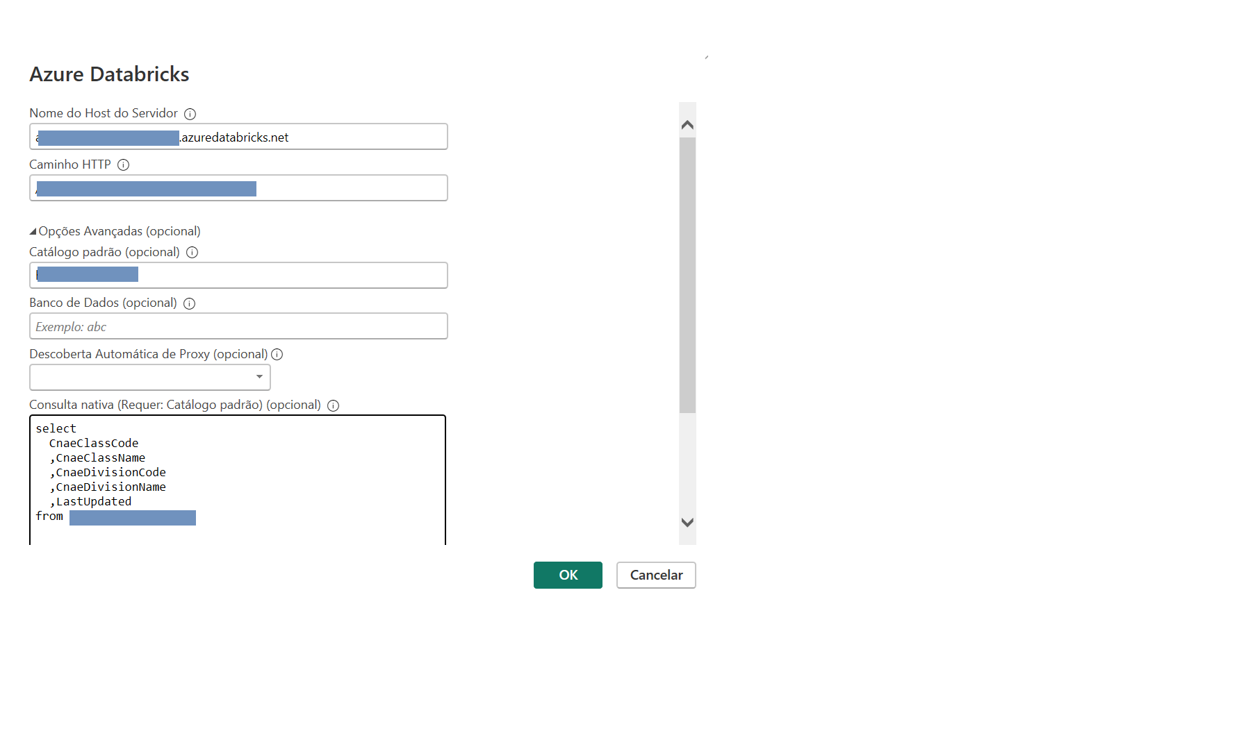

  4. Mike 0 Reputation points
    2024-05-28T15:31:06.68+00:00
    Updating the ini file didn't work for us. We ended up adding the property to the registry entry. While this resolved the "Remarks" error we were getting, the metadata ("Remarks") isn't populating in Power BI ("Description").
  5. GUEDES Maria 0 Reputation points
    2025-06-12T01:14:55.6466667+00:00
    Consulta_Nativa
    I was able to work around this problem by drawing inspiration from suggestions I found here and on the Databricks website. I used the native query feature in Power BI to list only the fields that did not have the issue of extensive comments, and it worked. I identified the problematic columns by using the DESCRIBE database.table function in Databricks, and fortunately, the fields were ones that I didn't need
    https://kb.databricks.com/en_US/unity-catalog/error-when-trying-to-load-a-dataset-after-integrating-unity-catalog-metadata-with-power-bi
