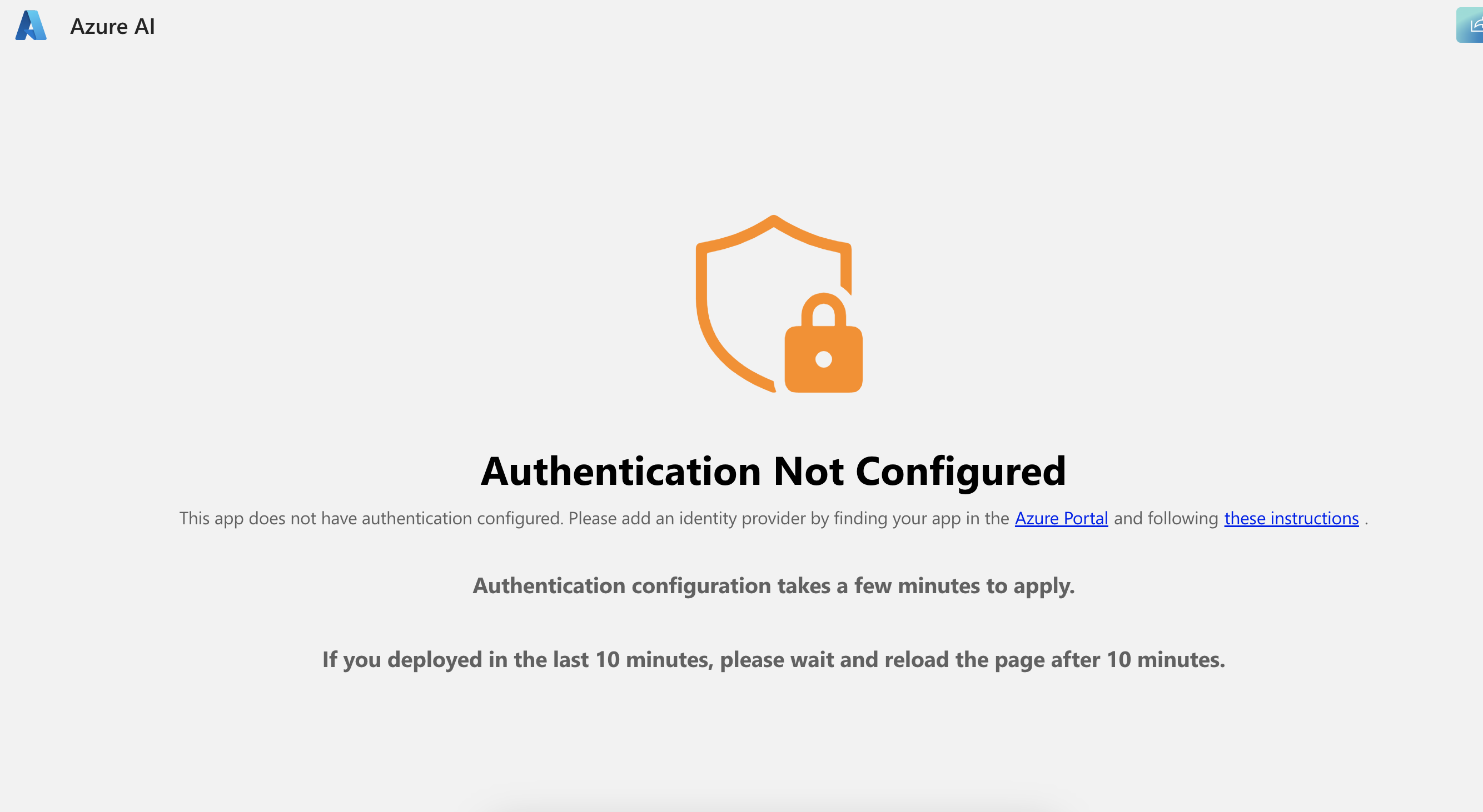

A web app requires authentication configuration.
My question is, how come other web apps with no authentication configuration work and this one doesn't?
I've been doing some research and I see that the image says Azure AI but I would like to confirm if Open AI enforces authentication.
I've been unable to find documentation that says that.
The other apps that work without authentication are not related to Open AI.
Hope you can help me.
aScreenshot 2023-10-23 153154

    I believe you have deployed this web application using Azure Open AI Chat Playground which provides ability to deploy the chat interface as a web app which includes the authentication configuration and thus you are seeing the above page. Once after the deployment (as stated in the shared screenshot) you need to wait for some time for the authentication configuration to be completed. After that you should be able to see the below page -
    Once accepted you should be able to see the below use the web application (see screenshot below)-
    However, if you don't want to use the authentication, then you need to customize the web application using the web application source code shared over here and you will be updating the logic in getUserInfoList in frontend/src/pages/chat/Chat.tsx to disable the authorization check like below:
    const getUserInfoList = async () => {
            setShowAuthMessage(false);
    Then you need to deploy the web application to Azure portal for your purpose.

    To remove this restriction, you can add AUTH_ENABLED=False to the environment variables. This will disable authentication and allow anyone to access the chat functionality of your app. **This is not recommended for production apps.
